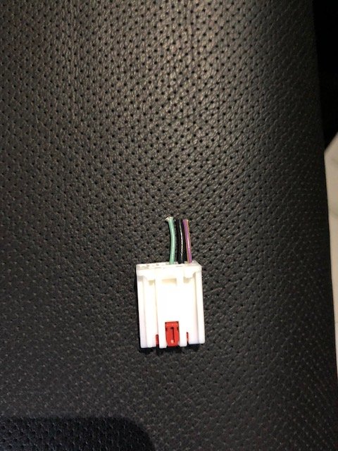

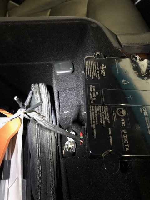

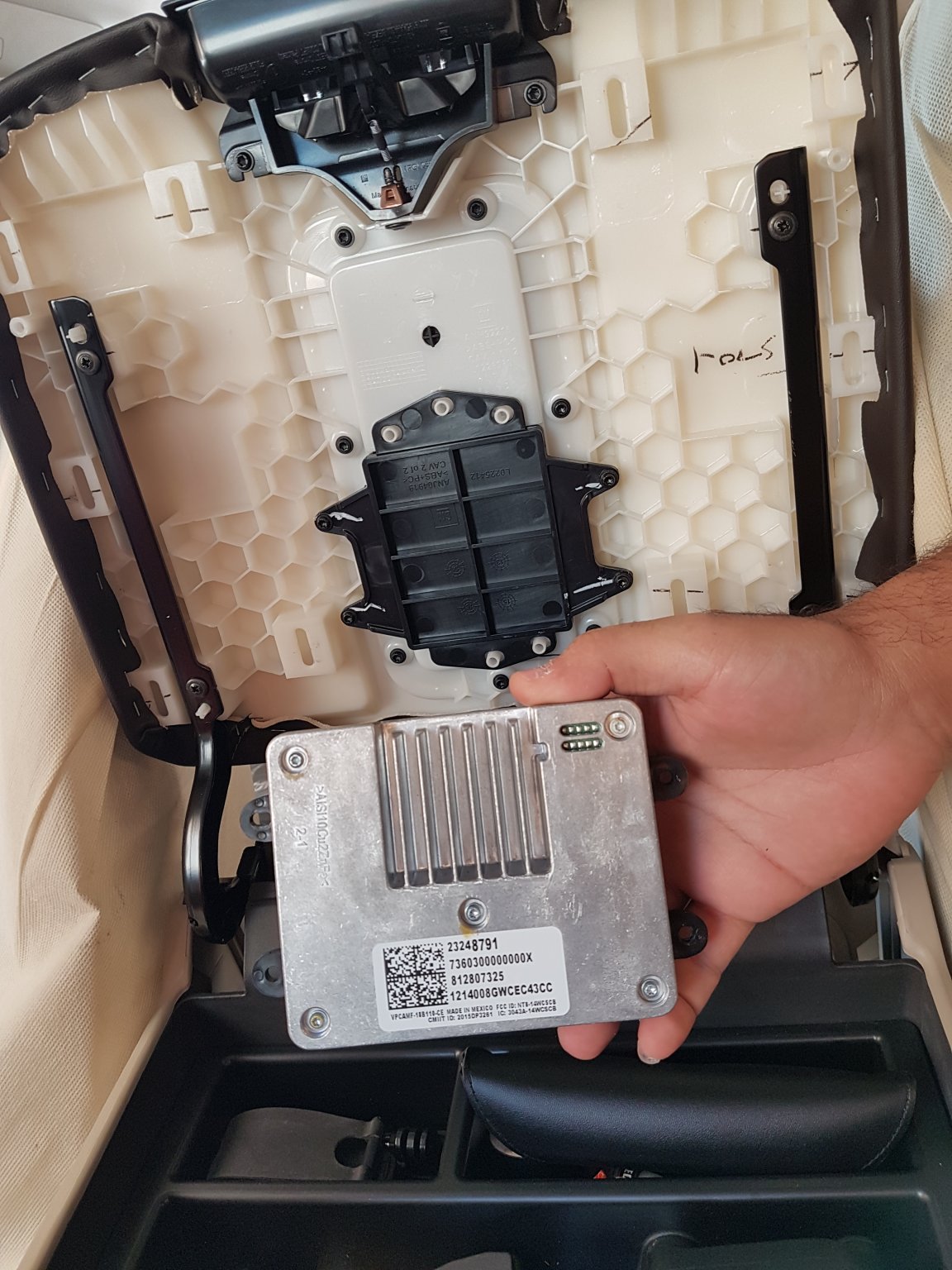

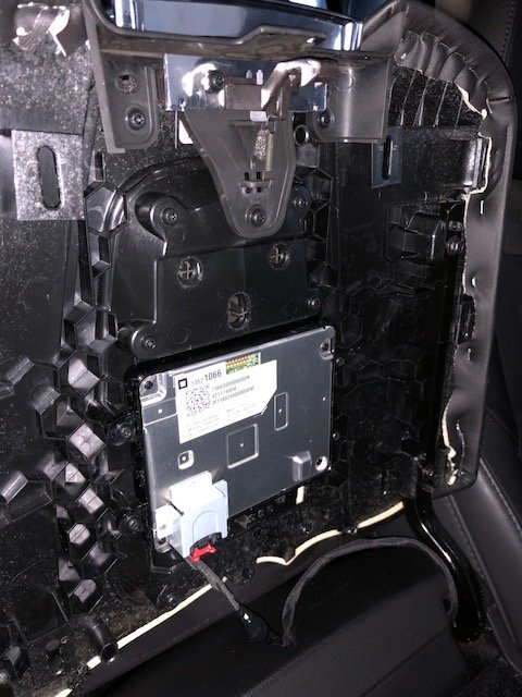

Hi, This forum has been helpful for me and I successfully replaced the wireless charging with the 2018 OEM parts, including the charging icon showing.... hope this is helpful to others. I have a 2017 Escalade. I purchased the OEM 2018 OEM GM charging module and the 2018 wiring harness for the module. (Part numbers are on other posts and forums but I can share if someone needs them. Replacing the wiring harness requires removing the back of the console and there's alot of electronics back there. I opted to cut the connector for the new module and connect it to the existing wiring harness, worked flawlessly and I have the charging icon and it works great. There's 3 wires (purple/Yellow, Green and Black(Power) I uploaded some pictures. The white connector image is the old wireless charging module connector but it shows the 3 wire colors. Note you need to connect the new Black connector to your existing wiring harness. If anyone has any other questions let me know. Thanks, Brando
View attachment 194574 View attachment 194575 View attachment 194576
So what did you ask for when you were looking for the new wire harness? An 18 harness is an exact match for a 17? Did the new harness have extra connectors that didn't connect to anything because it had other features that your truck my not have had? Any pics of where the BCM harness location is?
Thanks and nice work!

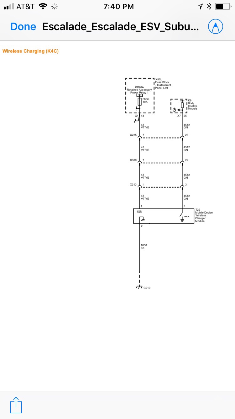

@Kittmaster here’s the wiring schematic for the wireless charging module.
You can see where the wires eventually land in the center console connector (X300), then on to the left body harness to I/P connector(X225) and finally break out to a fuse block, the BCM and one of the body grounds.
