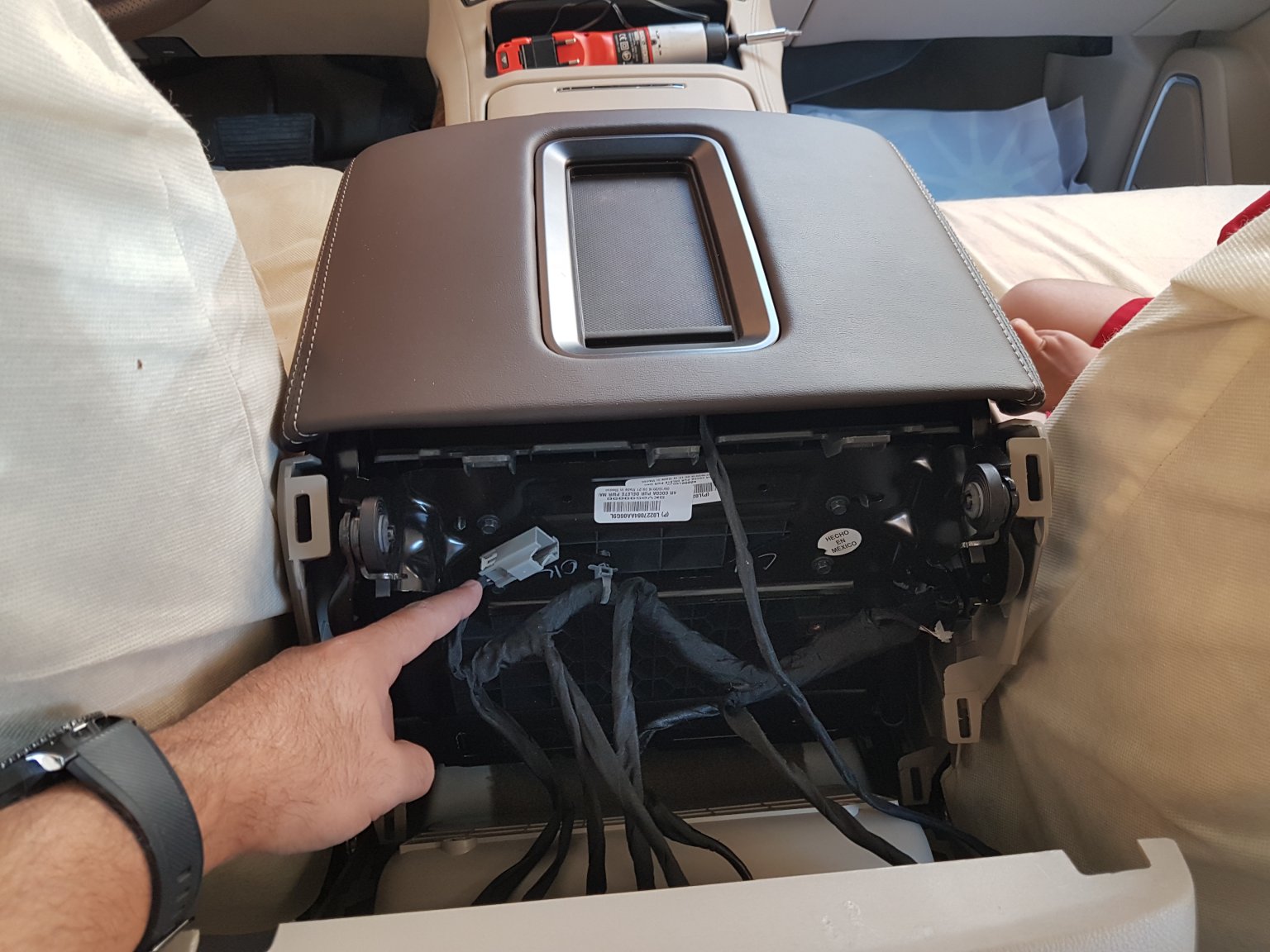

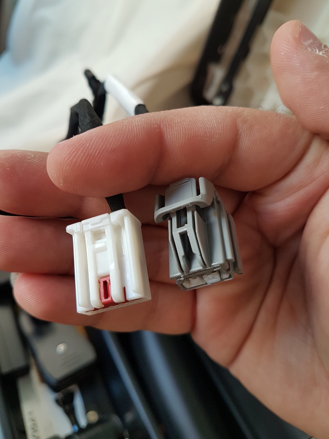

I also wanted to add the OEM charger to my Tahoe. I purchased the a factory center console with the Qi charger. I disassembled the console and was ready to install the new one but the factory harness did NOT have the connection for the Qi charger. Someone posted they did have the connection available but mine did not. I found the correct wiring harness used for about $30. I haven't done the change over yet (to cold in my area to start pulling apart the plastic trim pieces).
I have done the same but i just ordered the charging module and the harness wire. After installing the module in the center console lid and connecting it to the exciting wire in the back of center console i find out that no power comes to that wire. Maybe because the fuse dont exist since the car doesn't come with wireless charging option.
Tried to locate the fuse in fusebox but no luck.
