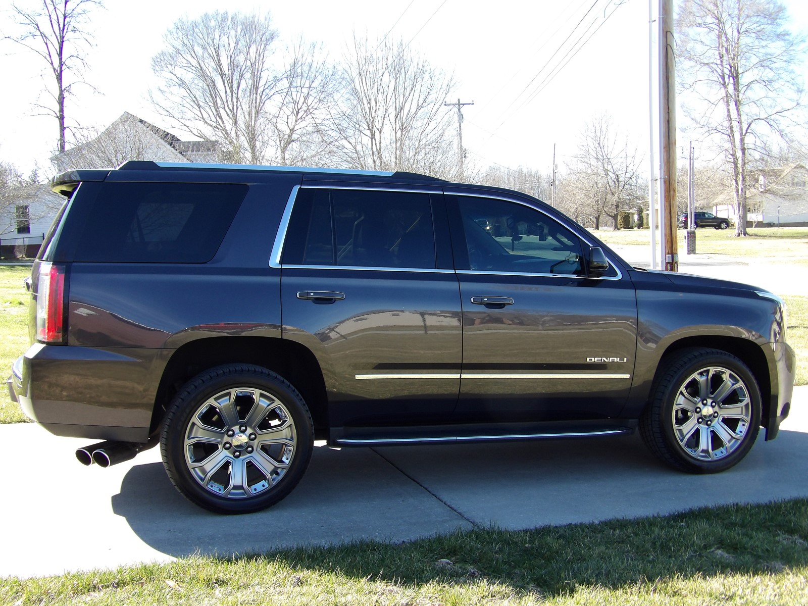

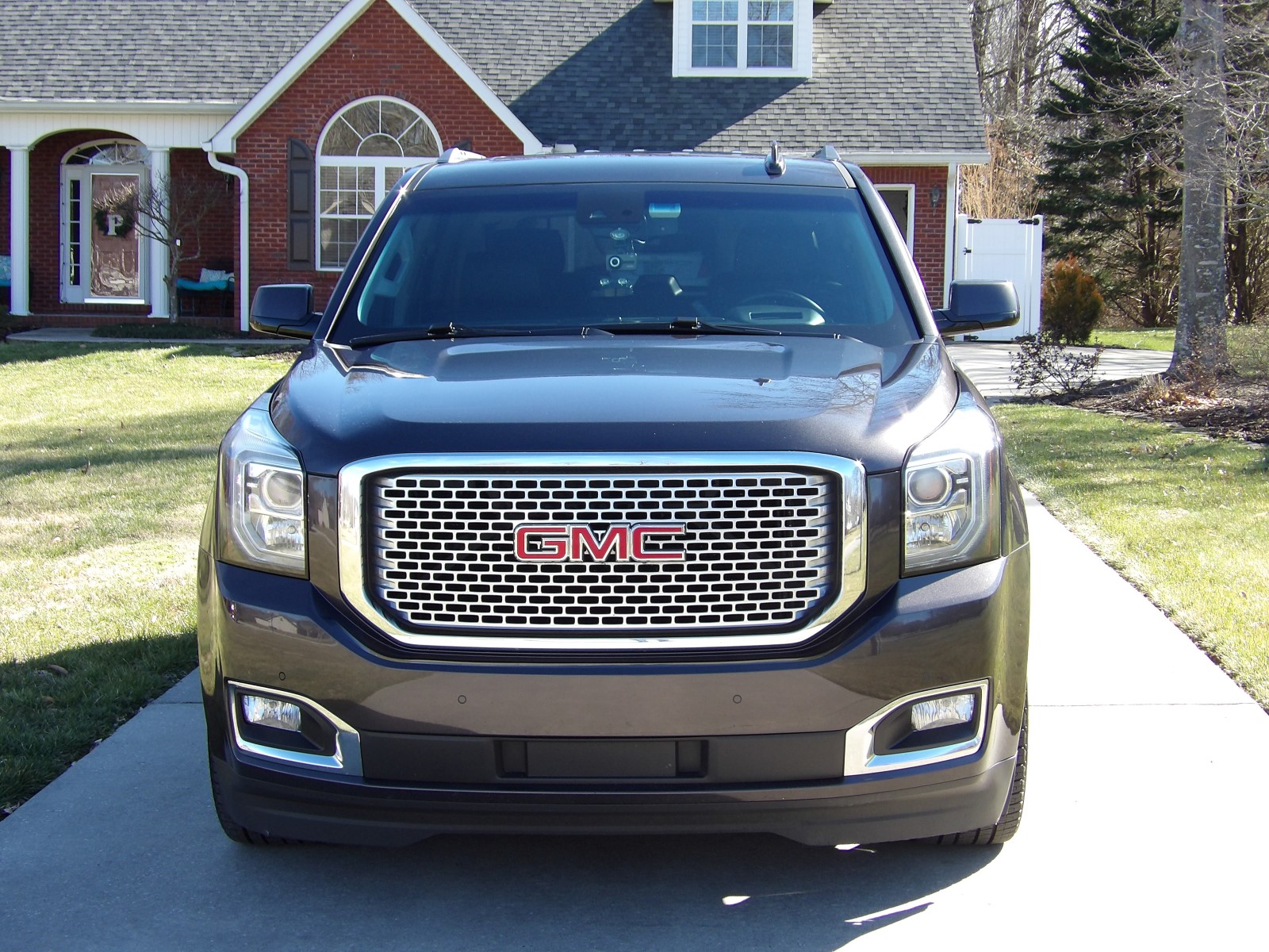

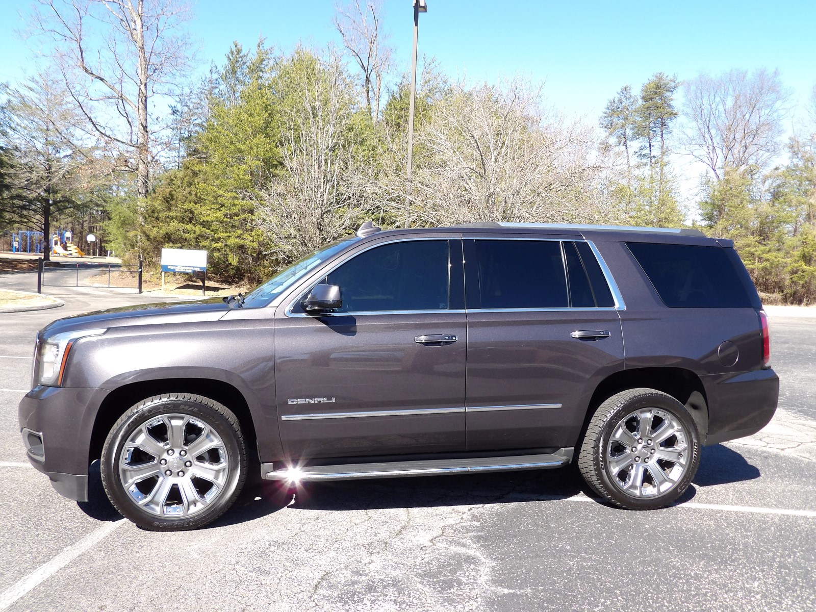

Welcome to the Forum from NH.
Pics of the truck, please.

Thanks! I'm out of state with it so when I get back I'll upload a photo. Nothing super special but I get comments on it's looks and color. It's a dark gray (I'll get color later) and with the sun it looks either gray, black or brown. Most think it's black from a distance.
