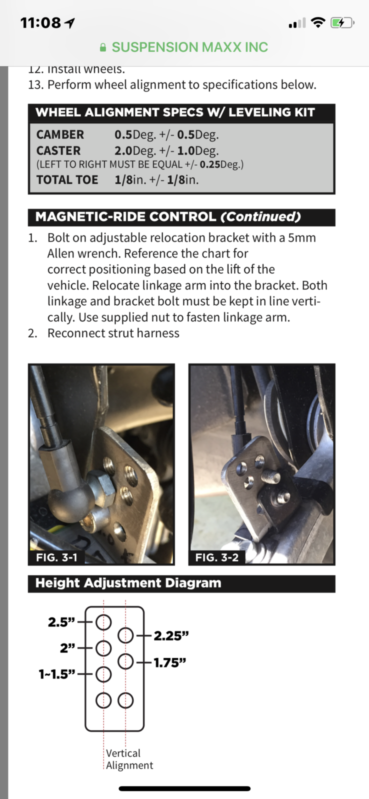

It's off now because of the added spacer to the Fabtech kit. You need the suspension maxx mag/ride bracket to fix the issue. When adding a leveling kit to the Fabech kit you need to compensate for the added front lift.

Thanks for the info guys. I remember seeing the topic of the new bracket but wasn’t sure if it was the front or back. Was John the contact at suspension max that may be able to sell me just the bracket?

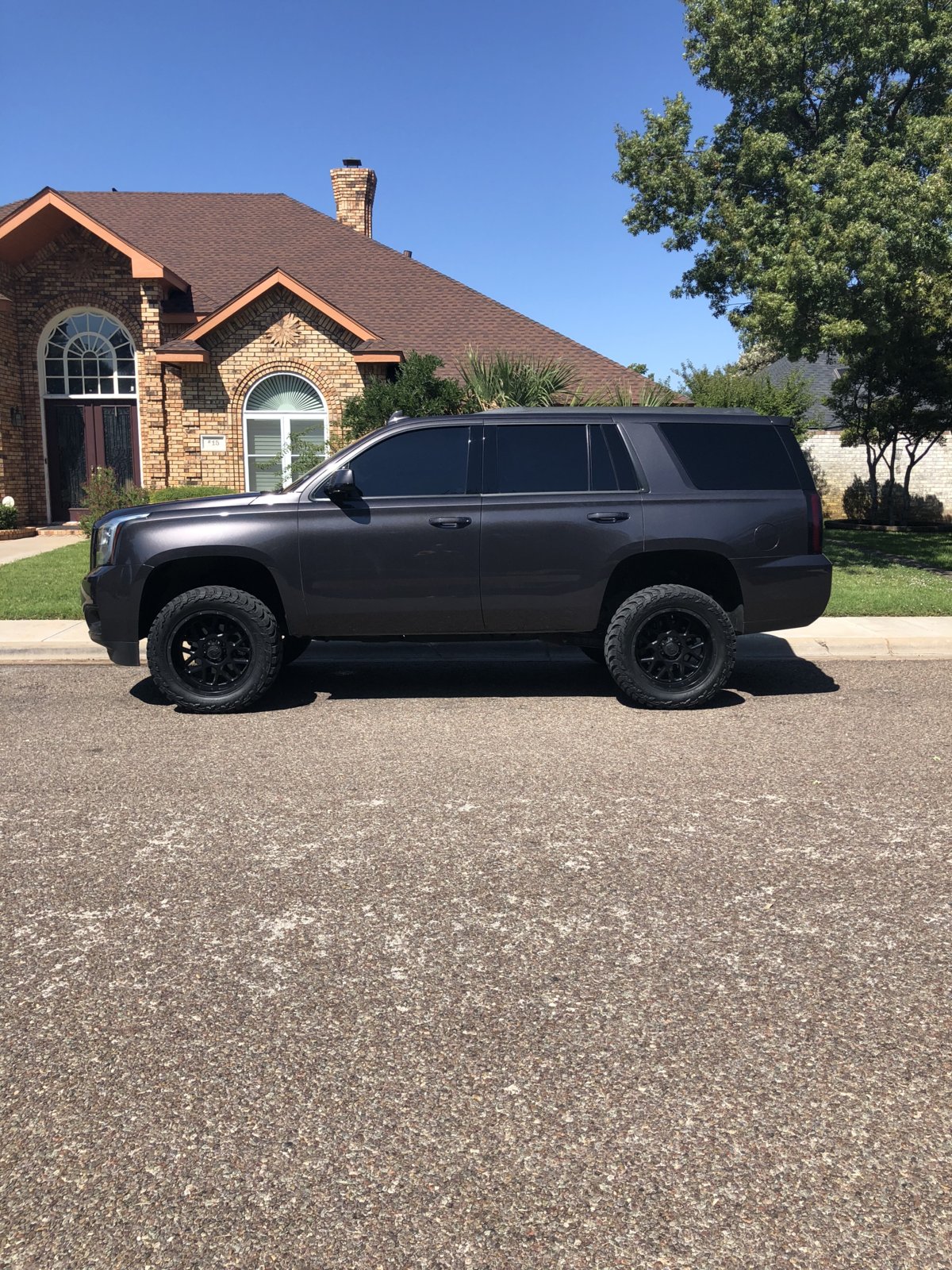

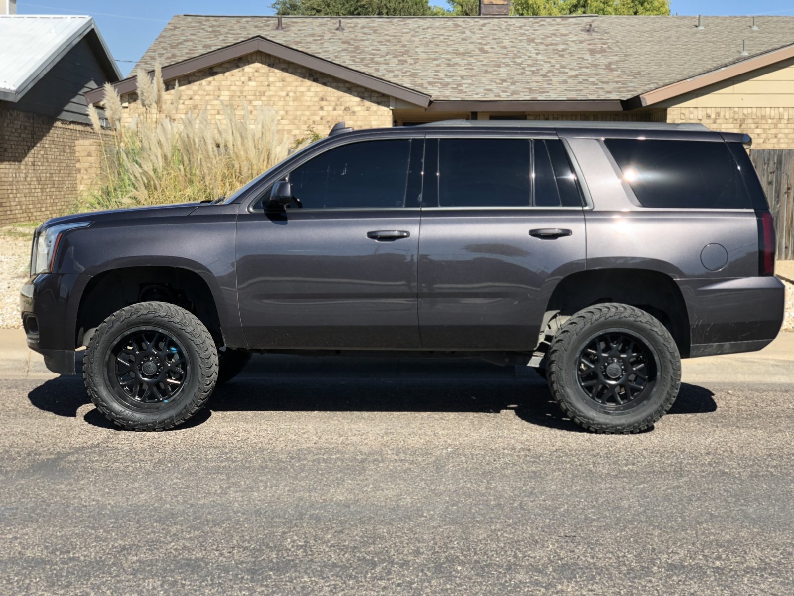

Post some new pics

It’s been raining and overcast here in west Texas for over a week but as soon as the weather clears I’ll get new pics of level front and rear. I would’ve replaced the shocks a long time ago had I known we didn’t have to run magnetic replacements.

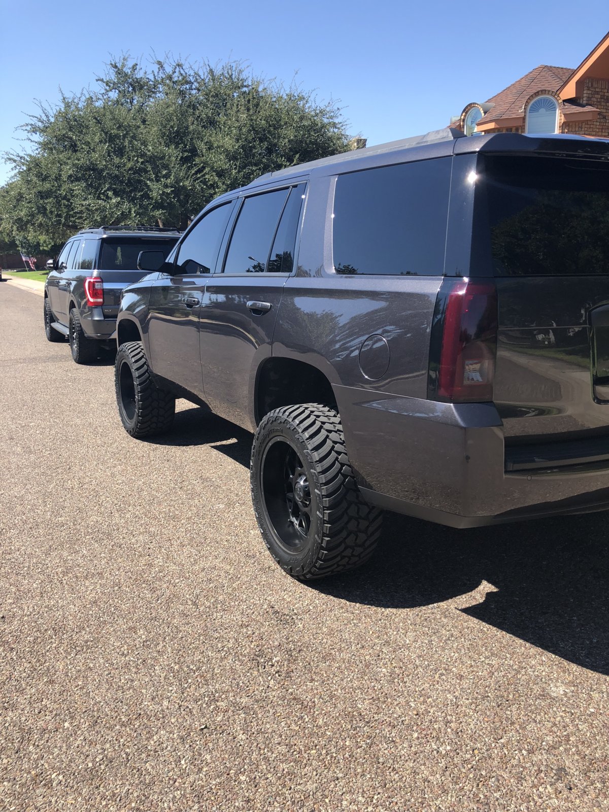

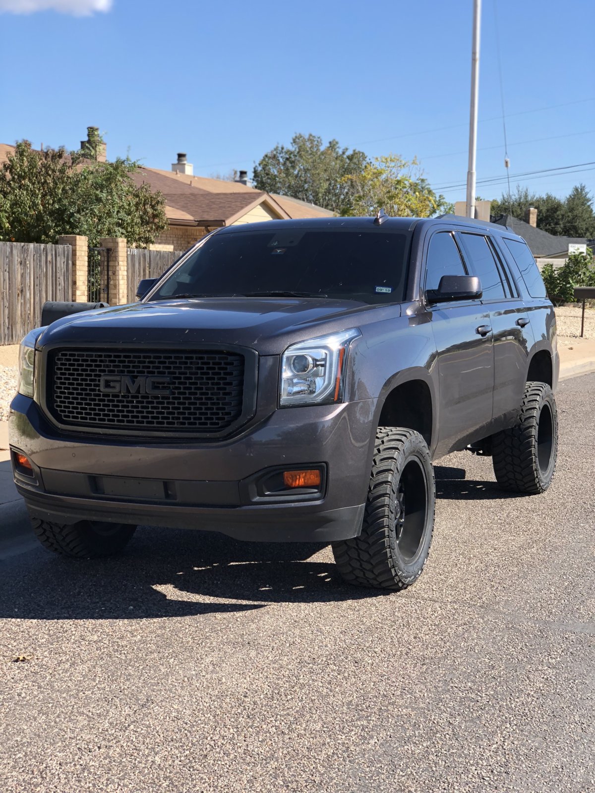

Looks great man! What are the specs on your wheel and tire setup you're running? I was looking at the 6" lift from Rough Country but I really like the height on yours.

20 x 10 -24 offset wheels
33 x 12.5 Tires
The ride heights are exactly what I wanted to achieve as I feel 6” on the shorter Tahoe/Yukon frames are just too much and 4” looks good....but doesn’t stand out really much more than those whips rolling around leveled. 42” all the way around really seems like a 5” lift.

Looks super tall. Got a pic of your angles? And your front strut with the spacers?
I feel like mine sits low for 2.5. You just did the Monroe struts and added another spacer to it?
