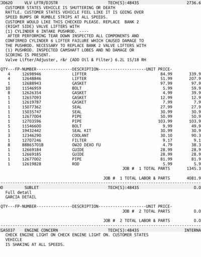

My 2016 Yukon XL Denali, with only 35,000 miles, started to shake so I took it to dealer service last week. Can someone please advise me if they have had repairs covered for this type of issue? It seems I'm not the only one with the Denali death rattle. They want over $4100 for repairs. This seems like a lot for a car just recently out of warranty and with only 35,000 miles on it. attached is the invoice from the dealer service. Any advice?!
$2700 labor seems exorbitant for this work. If GM does not come through with full/partial coverage I would shop well-thought-of independent repair shops in your area.
