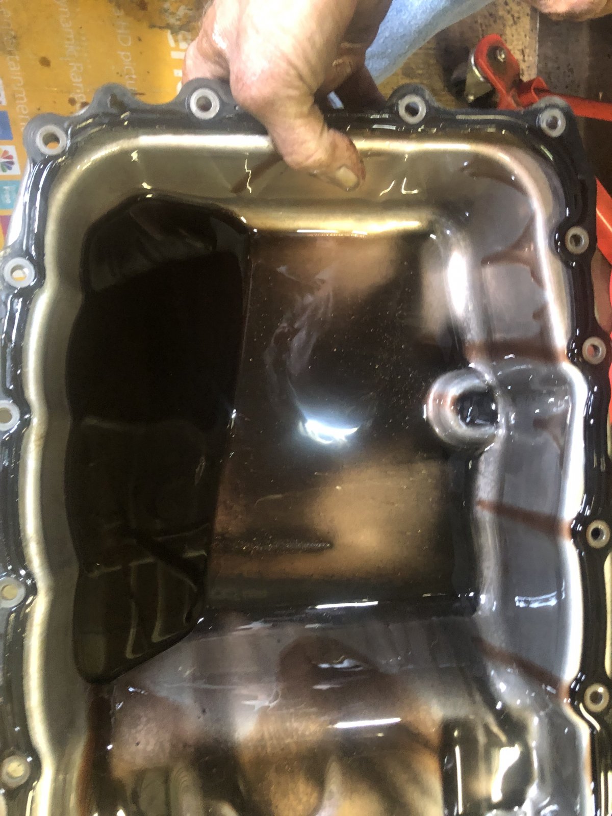

This Wednesday. Installing my rebuilt 6L80 and Circle D converter 1800-2000 stall with Penzoil Platinum full synthetic LV ATF.
The builder said my 4-5-6 clutch was smoked and there was slight scoring on the pump. He rebuilt the trans, gave me a new pump and installed some Sonnax upgrades that I provided.
When I bought this Burb it had 94,000 miles on it. All stock. I had done a Diablew tune, and superior Tstat bypass. Serviced everything including a pan drop at 94k miles. The magnet at 94k mikes was somewhat caked with grey material. Anyway this 6l80 failed at 112k miles.
Attached is what the pan looked like when I ripped it out at 112k miles.
Hoping this goes smooth and will keep you posted Wednesday night or Thursday. Just sharing.

Wow the fluid with only 20k miles looks nasty. Did it smell burnt or anything? But I guess if the 4-5-6 clutch was toasted that would explain it?
Yes it smelled burnt. Not sure why it went out all of a sudden. I was just cruising at 60MPH and it started shuddering and slipping. No warning or anything.
Yep, 4-5-6 and 3-5-R packs burn down quick once they start to go and transform the fluid to what you see in that pic. I always recommend the 3-5-R apply ring and 4-5-6 piston kit on overhaul as both add one more clutch and steel plate to each respective clutch pack, increasing carrying capacity by 20-25%...
