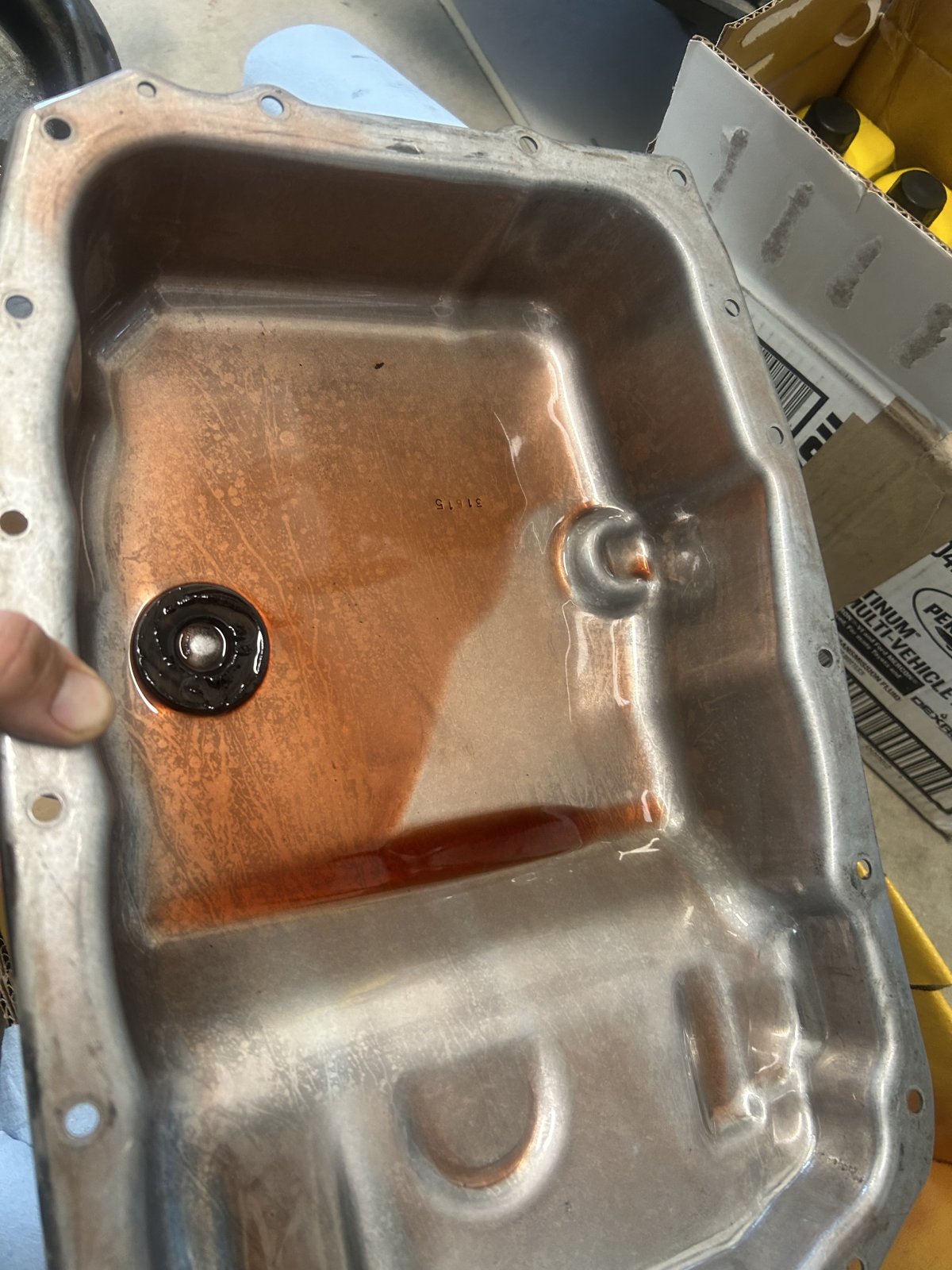

After 8,000 miles I conducted the first transmission service. I wanted to do it sooner but life wouldn’t let me. Lol.
Here’s some pictures of what the fluid looks like after 8,000 miles on the new rebuild. Looks pretty typical to me. I use the Penzoil LV multi-vehicle ATF Full synthetic fluid.
