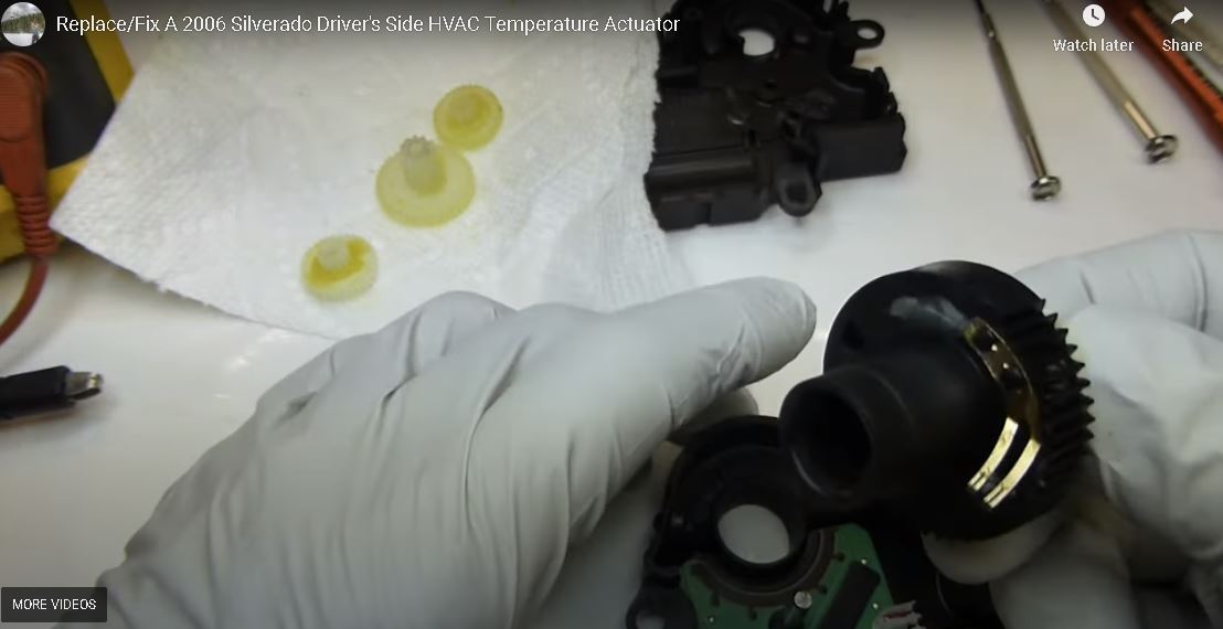

sometimes the actuators can get stuck, either just random or because the actuator is failing.
if you ever open one up it is just a little motor and plastic gear/s with a couple copper feelers that run across a contact line, it works by resistance value as it moves from end to end
the contacts get dirty over time, but the plastic gears also wear so fixing one is iffy.
