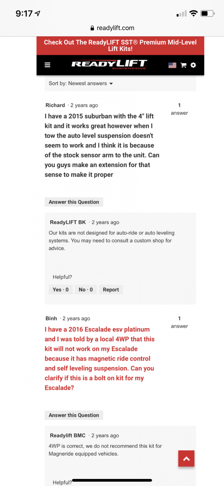

QUOTE="ben n, post: 1567595, member: 84235"] ...What are my options moving forward?[/QUOTE]
The 4” ReadyLIFT SST lift kit is not designed for the magneride/ air suspension equipped vehicles in the GM 2015-2020 model years.
I found Q&A items on their website, not sure if you were able to speak with customer service yet.

1) Xineering (Orlando based) builds a MRC (magnetic ride control) delete product branded as GM Shock Sims. They have resistors that “delete” the magneride and/or air suspension, allowing the driver to install the appropriate fitting shock/coil of their choosing. Xineering is releasing a product that plugs directly into the OBD II port under the steering column. Pretty cool actually (and works GREAT).
You could choose to use The Xineering product, but would need new front and rear shocks (perhaps coils) to accommodate the MRC delete.
IF you decide to go this route, Xineering is a terrific company to work with and they truly have a legitimate product. This opens up a new can of worms because you are talking about switching to a completely passive suspension. I have suggestions and would love to discuss with you if you go this route.
2) Keeping the OE magneride suspension and running this 4” lift kit will require some kind of fabricated bracket, or DIY manufactured suspension sensor control rod. Both of these items will essentially “trick” the onboard computer that you are sitting at the “normal” ride height. You could checkout SuspensionMaxx and their leveling kit, as an EXAMPLE. Their product is listed as fitting magneride vehicles and they include the BRACKET type of product to “trick” the computer
https://suspensionmaxx.com/product/SMX-GM715M
3) Keeping the existing setup with no changes: I’m guessing you are getting a Service Suspension System message and/or Service Leveling System message on your dash. Perhaps not, but I’m guessing you are.
As the lift kit you have installed is not designed for the magneride/air equipped vehicles, the computer is sensing that the vehicle is needing to absorb approx 3-4” of added travel. Thus, the computer is controlling the dampening of the magneride or air shock and making it “stiff” or “rough” in order to properly absorb this increase demand of downward travel. I’m guessing that since you are riding around now “stock plus 4” that the computer is dampening and making the shocks “stiff” nearly the entire time. When you do need to absorb an actual impact while driving then the computer will only increase the dampening more, making the ride feel even more rough and uncomfortable.
