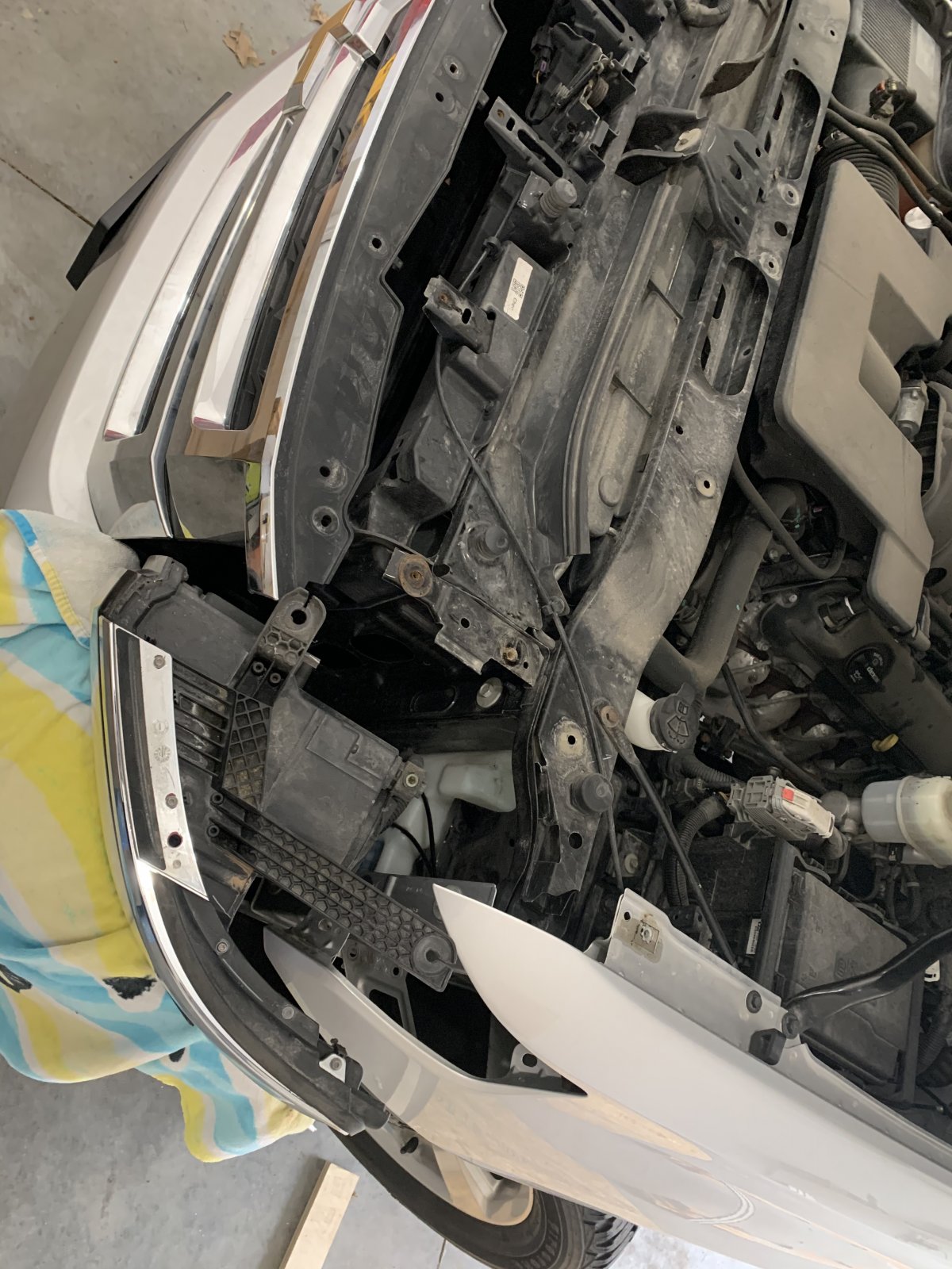

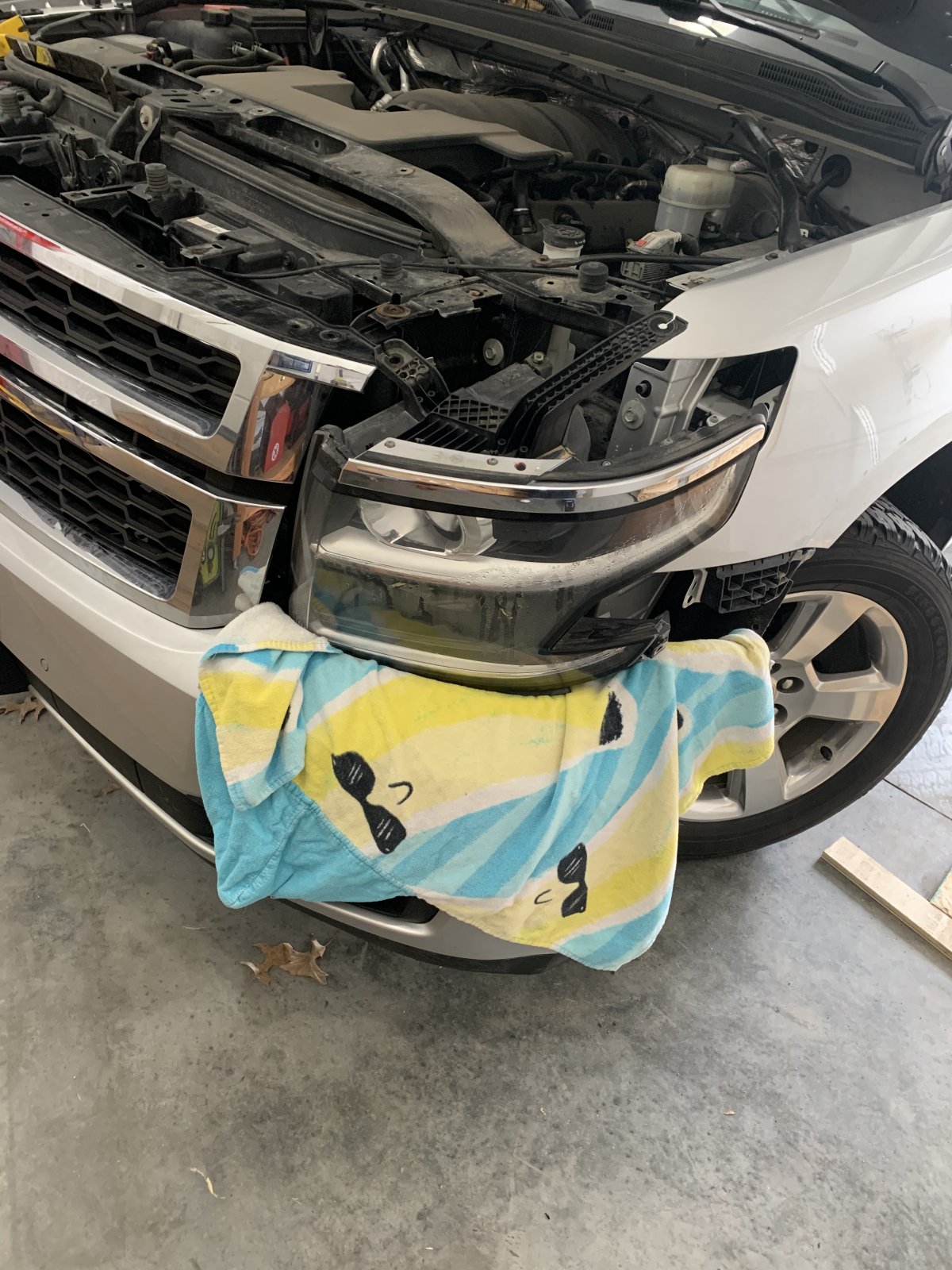

Only way I was able to get it was to pull off the bumper. It’s a pain in the arse.
