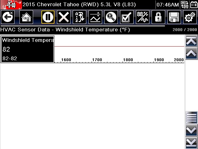

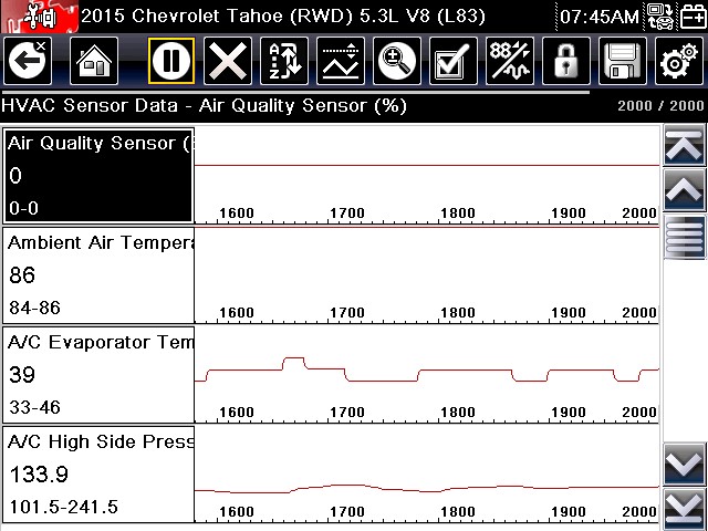

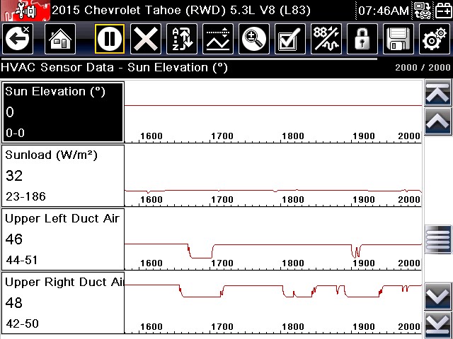

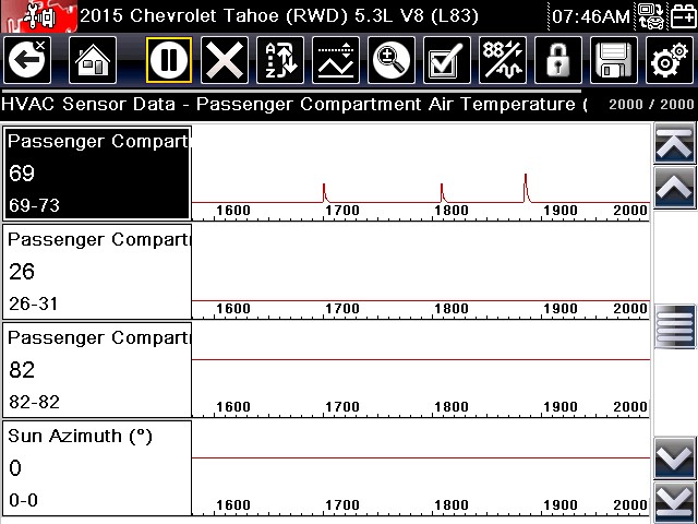

Thinking some of my issue might be partly in my head and maybe I shouldn't be expecting much better. Believe some of it is the ai also.
Part of the problem might also have been i was using a analog dial thermometer. Its actually doing a little better than i thought. setting bi-level and decreasing fan speed helps get the vent temp as low as 43.5degrees after bulk of heat load is removed from cabin.
Borrowed my buddies 3k snap on ethos scanner, and digital thermometer for the vent. And able now able to see more exact details of what's going on.
Following pics were taken on the way home at highway speeds.
Think you might also be onto something about it being the ai. On the way home it seems to peg the evap core temp at 39 (i know it can do better). As you can see from the following pics it can range as low as 33. That low peak was in park with me holding the rpms at 1800 and ive seen it down to 32 shortly after take off from idle after dropping cabin temp from 105 to 95. Only way to get the evap core temp down from 55-60degrees at idle (at least initially from cold start) is to hold the rpms up around 1800 for a minute or so, it will drop evap core temp down to 41-44degress when the cabin temp is 105.
Using the scanner has allowed me to see what settings allow the evaporator to get the coolest and there by allowing vent temps to get their coolest. Bi level and 60% or lower fan speed seems to give me 43.5 vent temps (by my vent gauge anyways, i know the pics show a lil different) after bulk of heat load has been removed. which is actually pretty cool when ya think about it i guess and is acceptable.
I guess my next questions are and where my problems are
Why wont it get evap temp very low at idle upon initial start without helping it by increasing rpms manually? (like i said after you hold rpms higher for literally 1 minute, evap temp drops significantly then its able to hold itself there at idle)
Why does it seem to peg evap temp at 39 going down the highway when it can do 33 in park? should be able to to better or at least as good with more airflow over condenser. im guessing ai is holding it back for some reason.
Why are my radiator/condenser fans allowed to shut off if i dont have the ac blower fan at 100%? This sucks, my evaporator core and vent temps rise 20-25 degrees within seconds without the radiator fan pulling air across the condenser. It goes from a nice cool 44-45 degrees at idle to blowing 65-70degree air out the vents. Also just noticed this on the way to work sitting at a red light. Guess the truck thinks the coolant temp is good and disregards the the ac is still on and shuts off the fans.

So there is a sensor that blends or reduces ac to keep evap from freezing up. It was faulty in my ride, the evap would freeze up at low fan speed, but it would get cold for sure. But evidently yours is working correctly, It will try to maintain above freezing temps to keep it from icing up. Your vent temp on low fan should be in low 40s. I think the evap temp in the high 30s is spot on and is working right. That's why it kind of adjusts on you without your input.
So if you watch the pressures, when you rev it up the pressures will drop on the low side and get you in the good cold zone of operation with lower pressures on the low side and an increase on the high side pressure. You may be over or under charged or there is some air in the system. Air or improper charge are the two normal factors with ac issues.
Another possible issue is air flow, the high side switch to request fan speed from the cooling fan on the condenser is set pretty high if I remember right. You will find that just even going 45 mph at almost idle rpm its cooling better than sitting, this is part to do with the programming of what high pressure is needed to trip fan into max mode.
On a cold start in 100 degrees, 50 or 60 out of the vent is all you could ask for when the interior is 135 roughly, its alot of thermal load. In 10 minutes down the road it should really start getting cool then . My black burb takes 15 to 20 before I reduce the fan speed from 3/4 to 1/2. Just to give you an idea for food for thought.
Your ambient temp that day with the scanner was 86 and your high side was 130. that seems low to me.

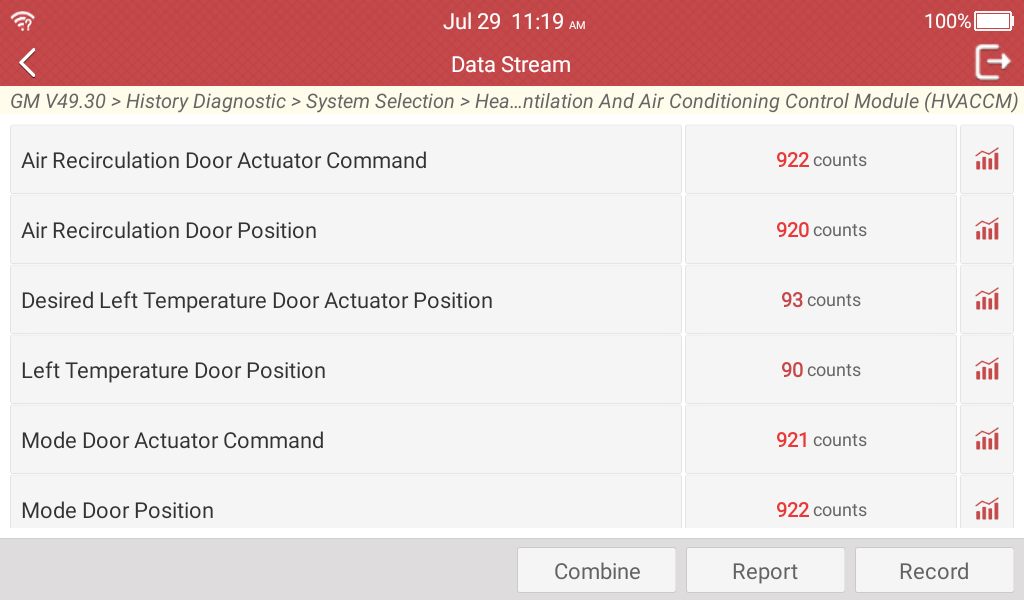

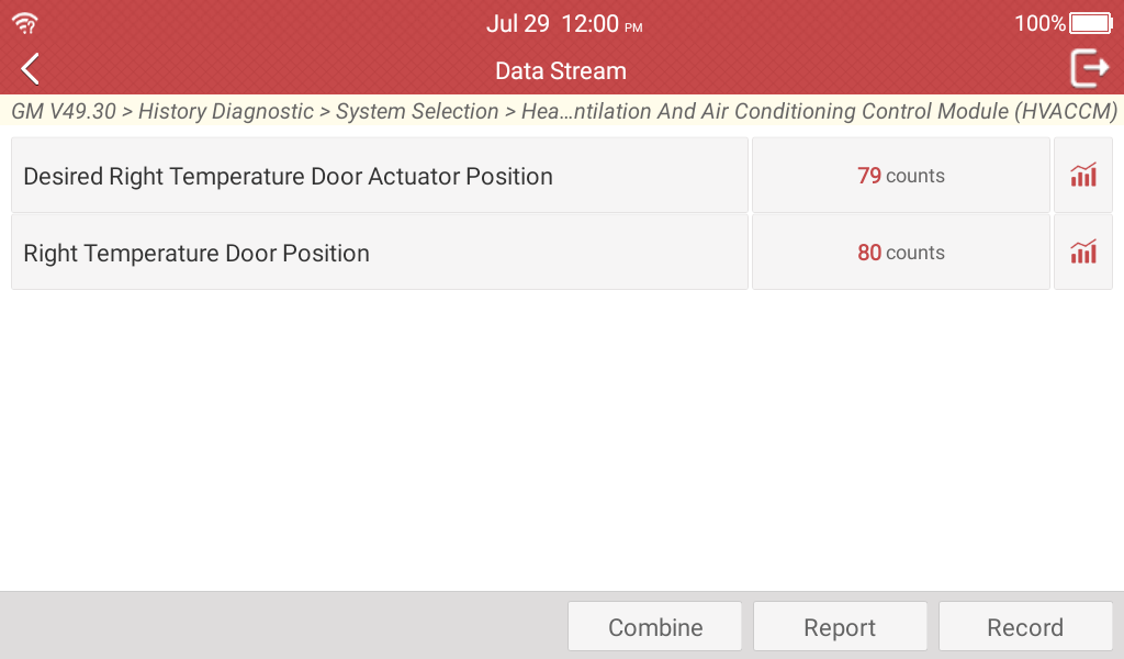

Desired vs actual on the blend doors are off by 1 on most. The driver side is requesting 93 but constantly bounces back and forth between 90 and 91. Don't here any clicking. On wife's car all blend doors desired vs actual are dead on.
Think mine are slightly cracked? Likely hood of that being why it doesn't cool as well or is that normal for these years?
