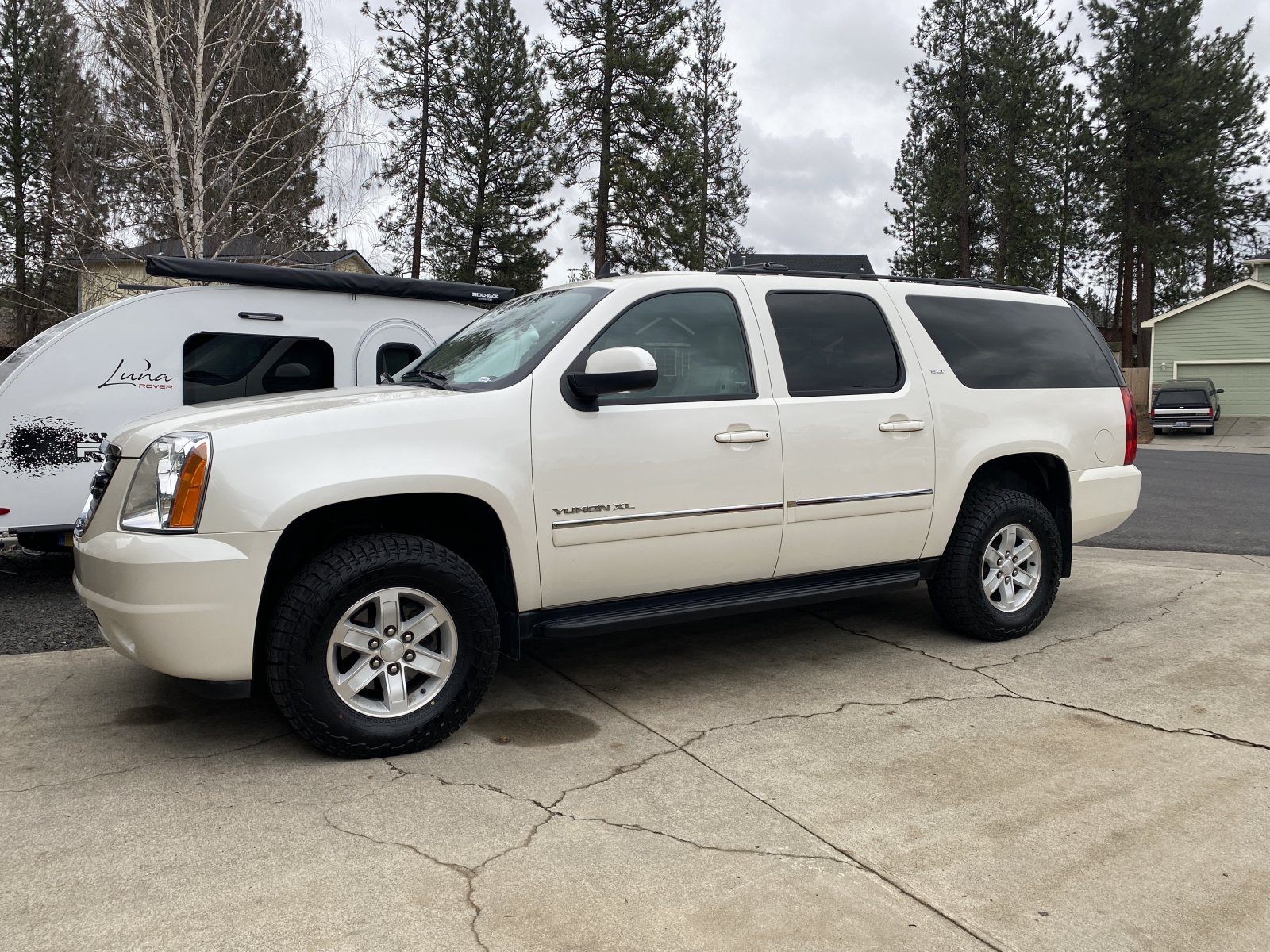

Got the CCM leveling kit installed. It was easier than I expected. 2.5” front and 1” rear. The lift amount was accurate to the prediction, and my tires (275/70/17) now clear the rear of the front fender well! It also looks really good. The change is subtle as far as appearance, but readily noticeable at ingress and egress. Pics coming soon.

The new stance. 2.5” front, 1” rear.
