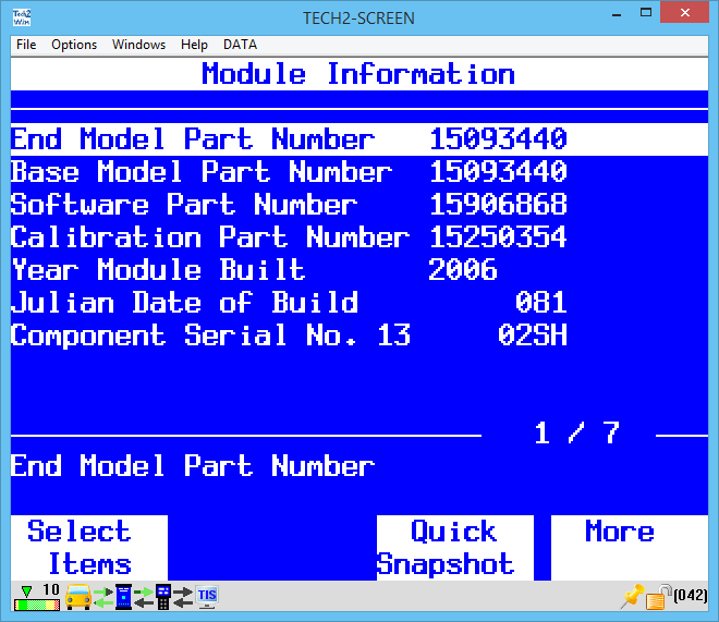

I was not expecting this with the VCX Nano... Failed/Current DTCs
U0156 Lost Communication with Information Center A
U0208 Lost Communication with Seat Control Module A
U0199 Lost Communication with Door Control Module A
U0164 Lost Communication with HVAC Control Module
Historical Codes:
U0140 Lost Communication with Body Control Module
B1590 Mirror Vertical Position Sensor Circuit
B1580 Mirror Horizontal Position Sensor Circuit
B1023 Integral Switch Malfunction
And a few inconsistencies here:
According to TIS2WEB, I should have OS 20805422 and calibration 25809823 amongst other PNs.
I'll check the wiring next, but after that I'm not sure if I will attempt a SPS reprogram for $45, or if I should get a new module.
