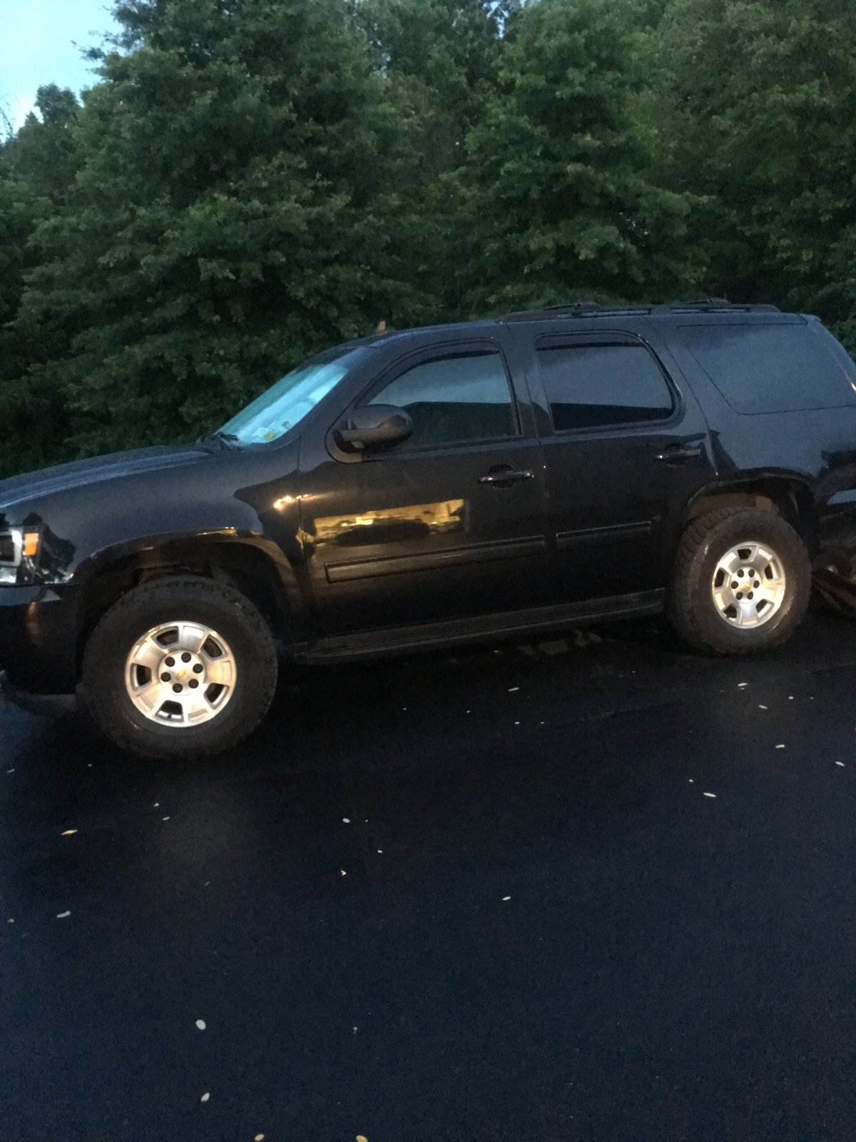

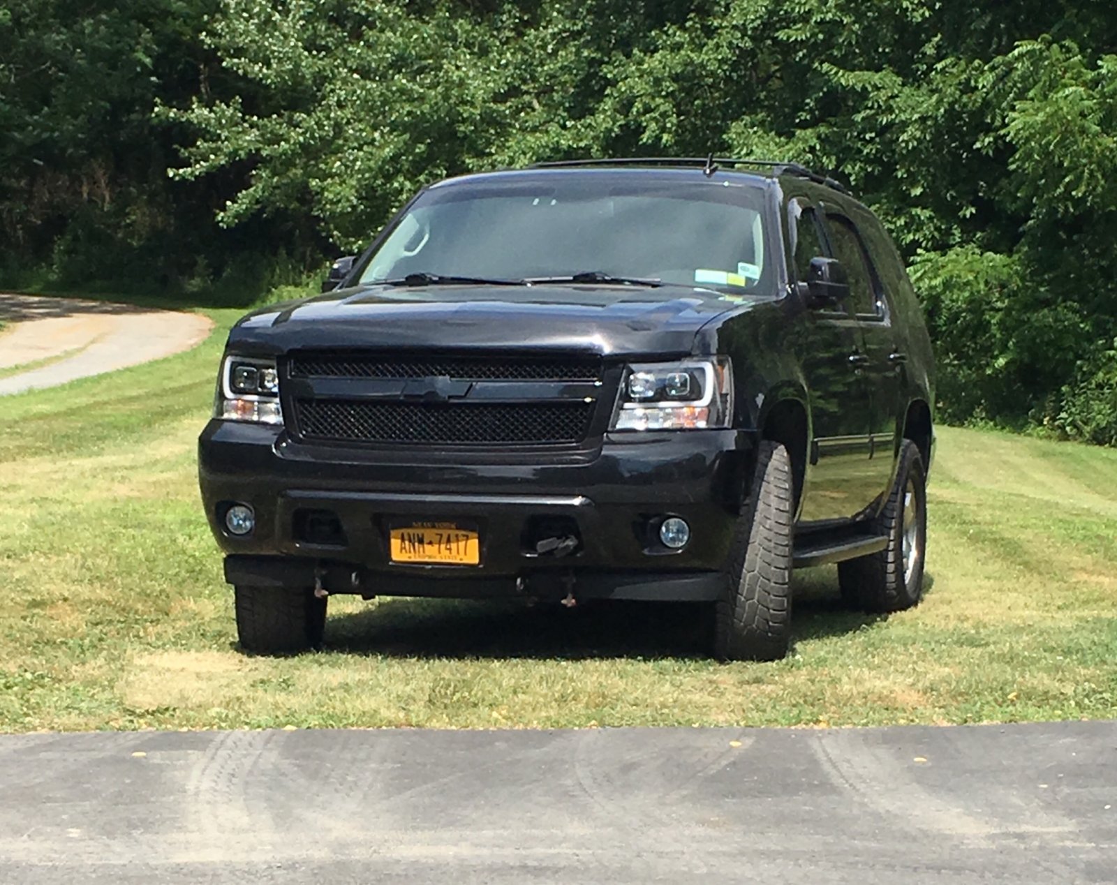

Up here to the right
2013 lt 2” level (spacer under front struts nothing in rear)
17” stock rims 285/70/17 tires. rubs slightly at full lock in reverse
View attachment 249438 View attachment 249439
I think that this is what I was looking for. Tires are good size and it looks great. Thanks for the pictures. I'm definitely going to buy tires once I leave the U.K. next year.
