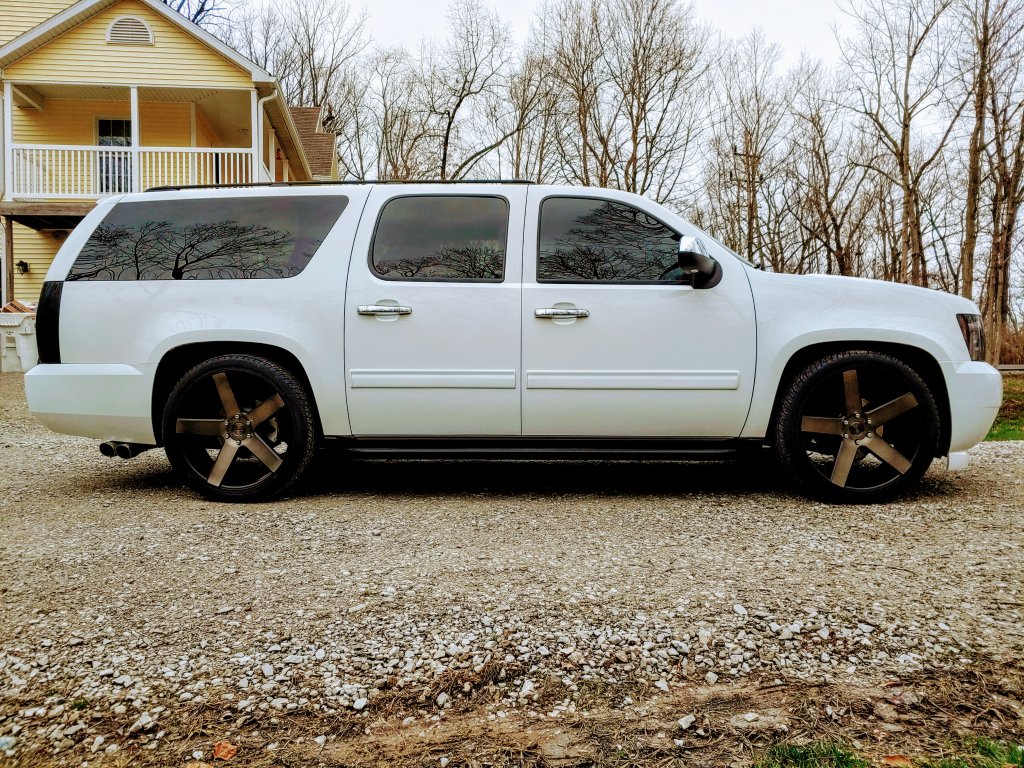

I am dropped 3.5" front and 4.5" rear with Belltech stuff. Rides great even with the 24's and I just drove to Florida from Indiana 2 days ago.
