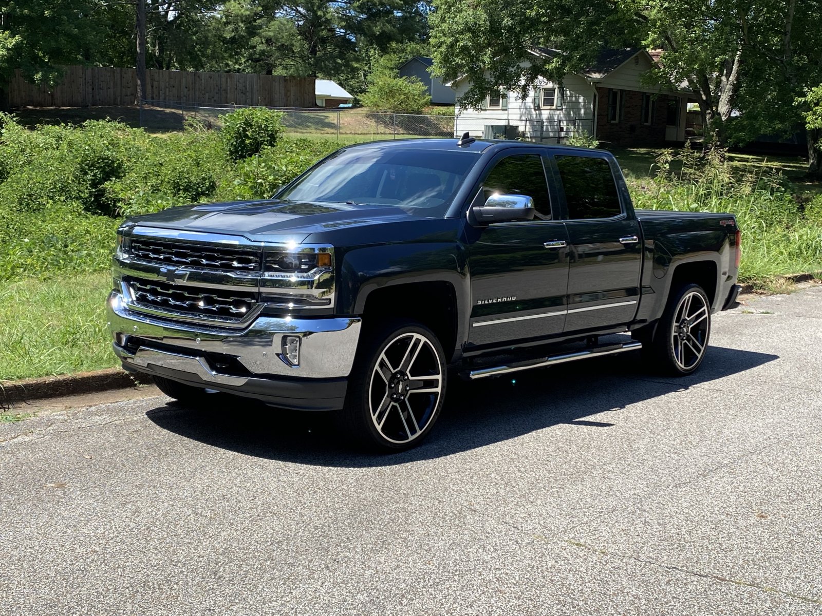

I have the Belltech 753 kit. It is a 2” drop front spindle and a 4” drop spring for the rear with a 1” puck for a 3” drop. On 24x10 with 305/35 tires.
