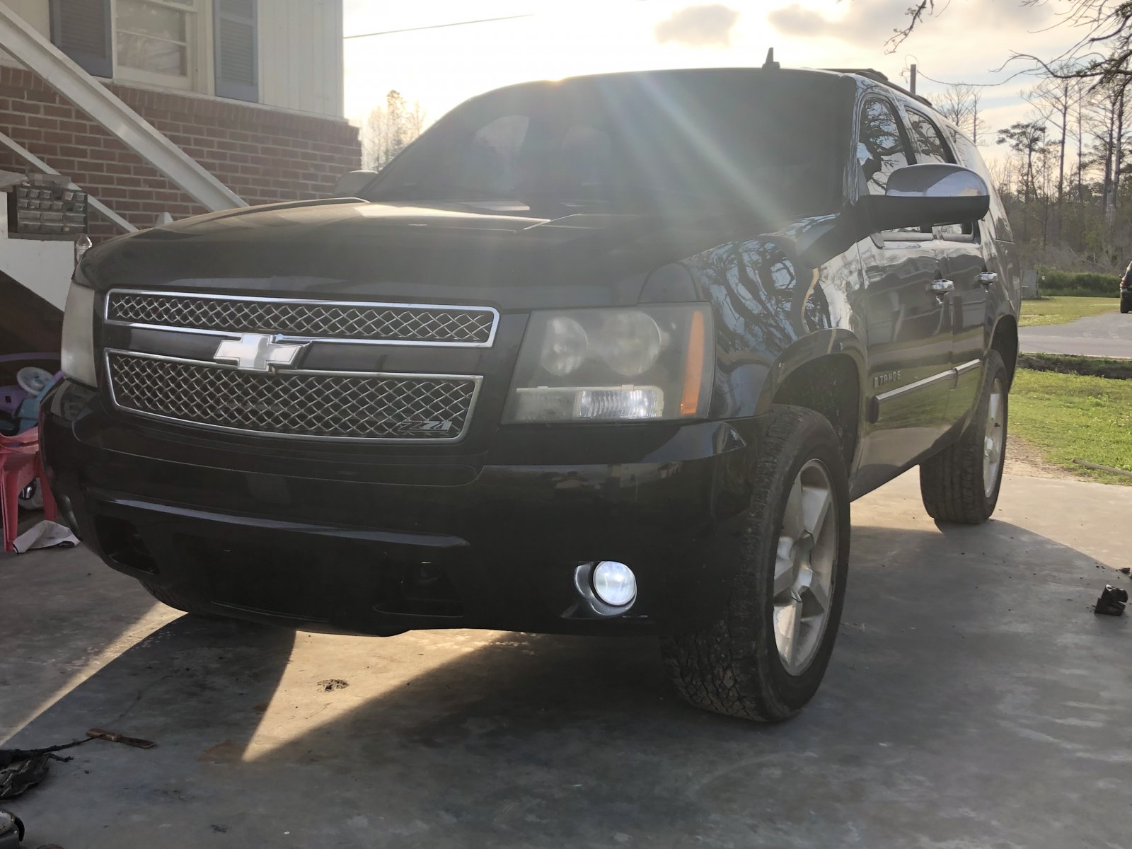

Led fogs and turn signals and a chrome bow tie that hardly fit off a 06 cateye I had
Put new headlights painted the stock emblem black and sold the chrome one to my buddy put a z71 emblem in the grill to help the black and chrome scheme and demolded/debagged it

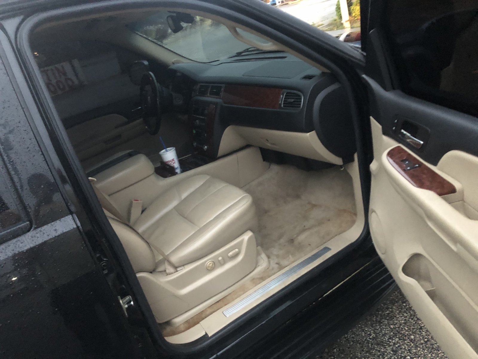

Some interior pics when I got it

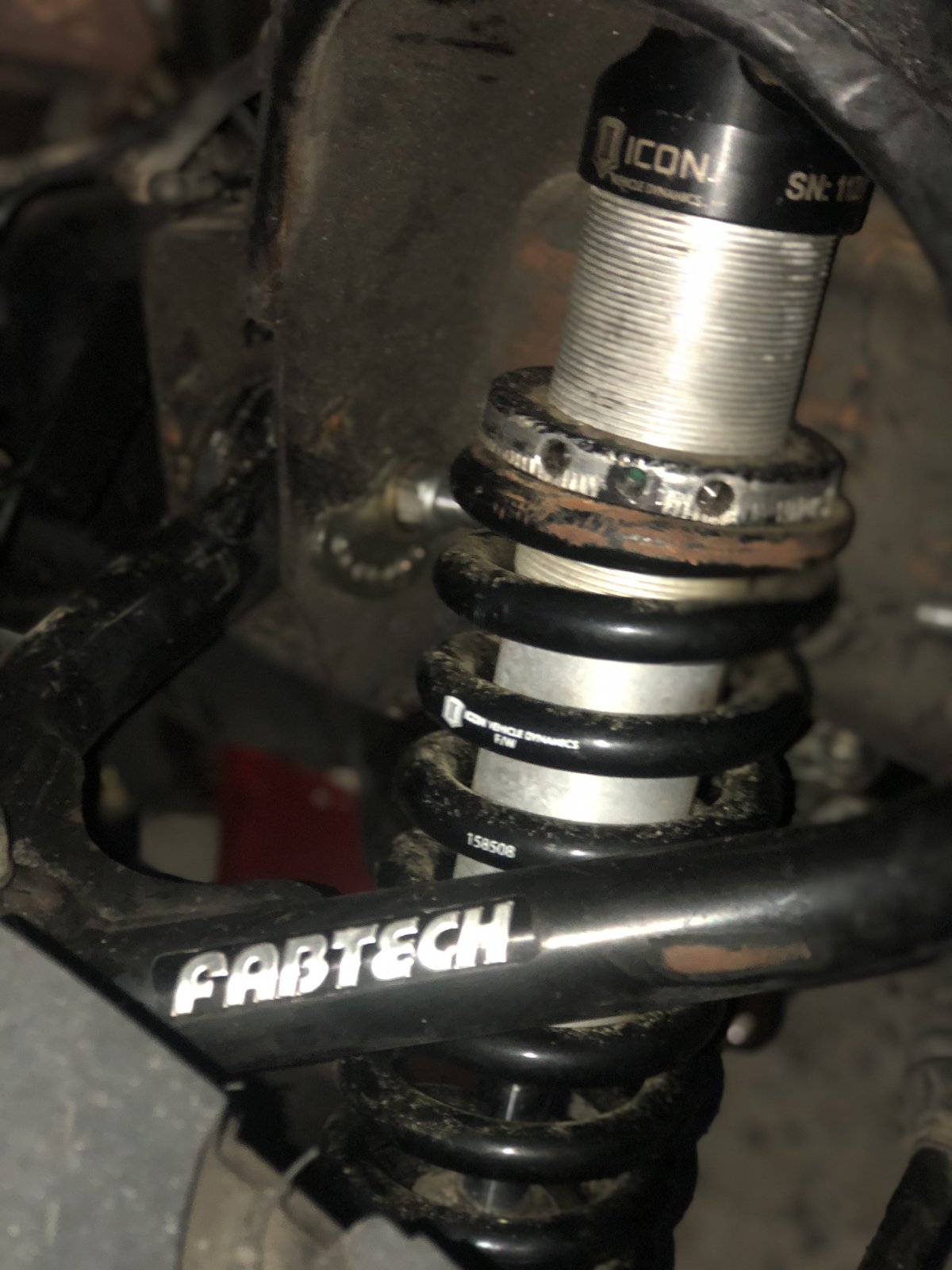

I got this set of icon coil overs off let go for like 425$ shipped only a month old off a 2020 at4 I said screw it and ordered em lil did I know their 2” higher from the factory so the 3.5” was more like 5.5-6” of lift I forced it to go together by hooking my in-laws tractor to the to hooks putting weight on it so I could get everything bolted together then used a chain style filter wrench to loosen the coils because I had no spanner wrench in sight

Ended up doing new Monroe’s and a 3” level with rc upper control arms

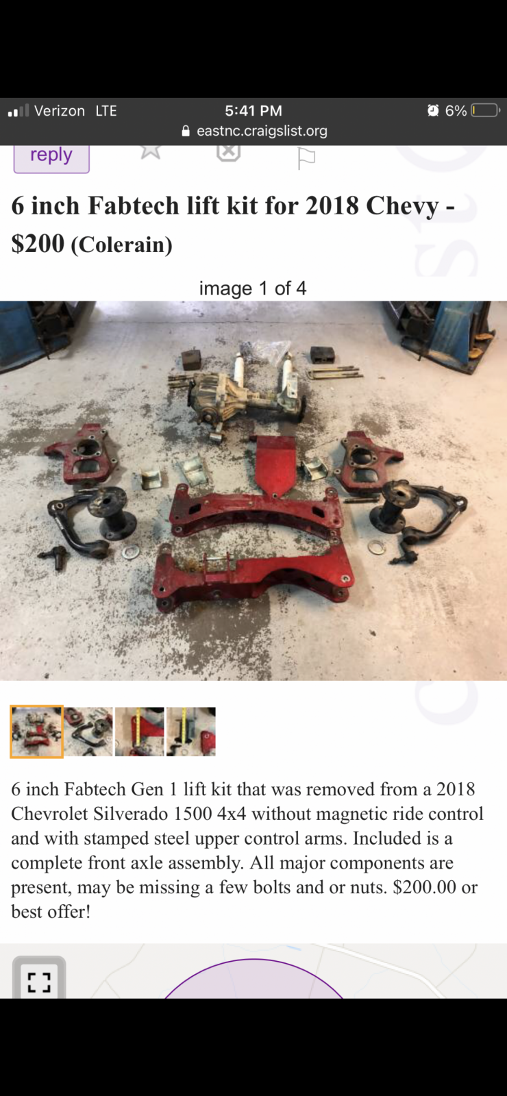

So I was to work and me and my buddy was talking about rear lifts to level my ride and he swore he had one but bull crapped me well god sent down a angel and that angel Told me to specifically look up lift kits on Craigslist I never look for used parts on Craig’s list only wheels and tires so idk why I did it but look at the very first post that popped up
Man what a deal! Broke as a joke I called and asked the wife if I could get the ok and surprisingly she said yes but no eating out that week! So off I went 2 hr away at 8pm in my boats crew van to go pick up this kit!
No it isn’t perfect but dude for 200$ I got almost 3500$ give or take of suspension! It cleaned up damn good
First thing I did was post the diff for sale and it sold a week later! 425$ I more then doubled my money but in reality I was trying to recoup the 425$ I spent on the icons I weren’t able to use so therefore I had 200$ in the whole suspension!
The wife was against me putting it on and I was scared I would tear it down and find out this lift won’t even work it’s for a 2018 but the day came where the wife was tired of our old Tahoe nickel and diming us after replacing heater core Ts, radiator and hoses, alternator, battery, thermal fuse, blower motor, blend door actuator, window motors, oil pressure sensors she was just over it because she was getting to the point that she diddnt feel comfortable to drive it to work and back every day. I work on my own stuff I keep tools in the trunk at all times so we talked and we finally bit the bullet a month later and went to get her a new car!

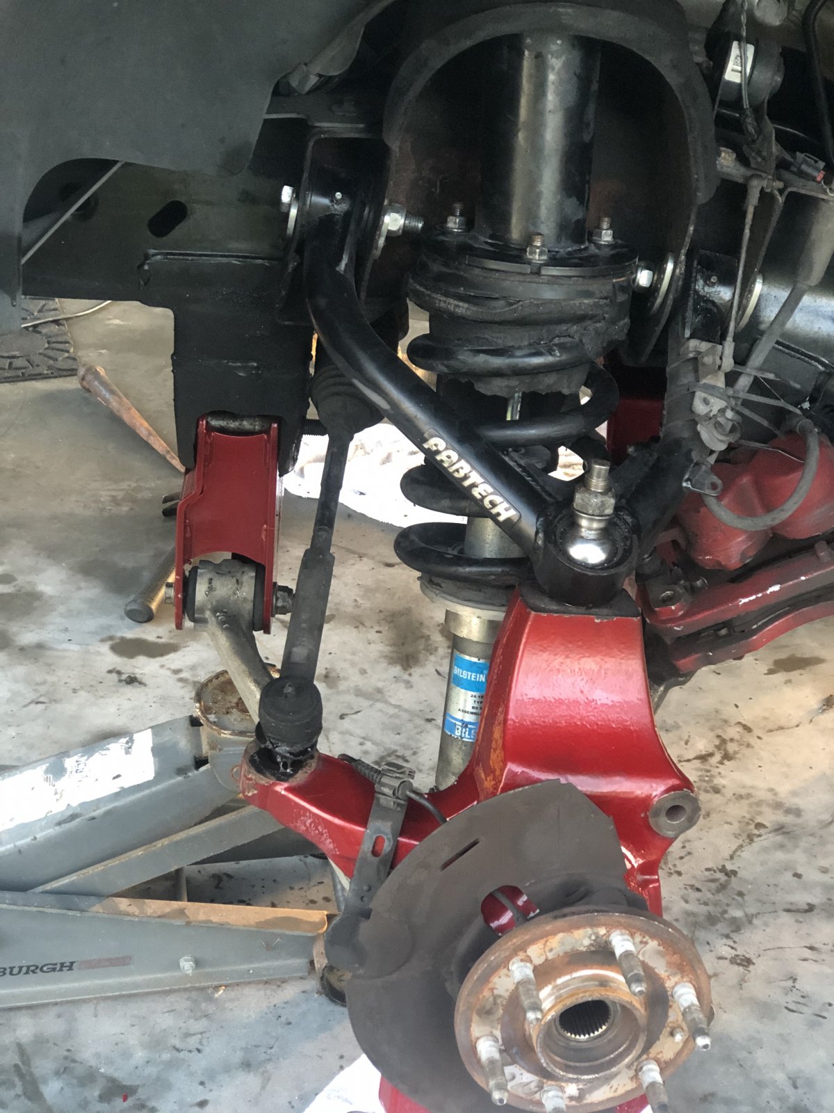

It’s on like donkey Kong now! We got her car wensday on our way home by Friday I had the front end ripped out the Tahoe!
I like wide wheels and I already knew the kmc wheels were going to look retarded on the Tahoe so I traded for these two piece 22x14 fuel marvicks that was twice the value
I was waiting on a leveling kit to come in so I could use the icon coil overs I had laying in the garage to compensate for the height difference with the lift kit and so I can crank the preload down some for a smoother ride
Got my new calipers rotors pads and lines from power stop and got my icons in also
I know the red don’t match the lift but hey I’m on a budget maybe one day I’ll buy a Craigslist stove to Powdercoat with I’ll probably be to cheap to buy the powder then though….

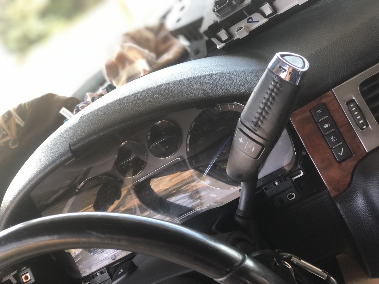

Had a 4 month brake after I broke my foot and had to have surgery. In the meantime my buddy picked up a Escalade to rob the motor out of for a Camaro he said I can have whatever I wanted off the thing for free if I wanted it so I took off!
I got as much as the black plastics as I could from front to rear (seats were too bad to use) I did door panels kick plates glove box gauge cluster which was a PITA
Shift lever and cluster installed

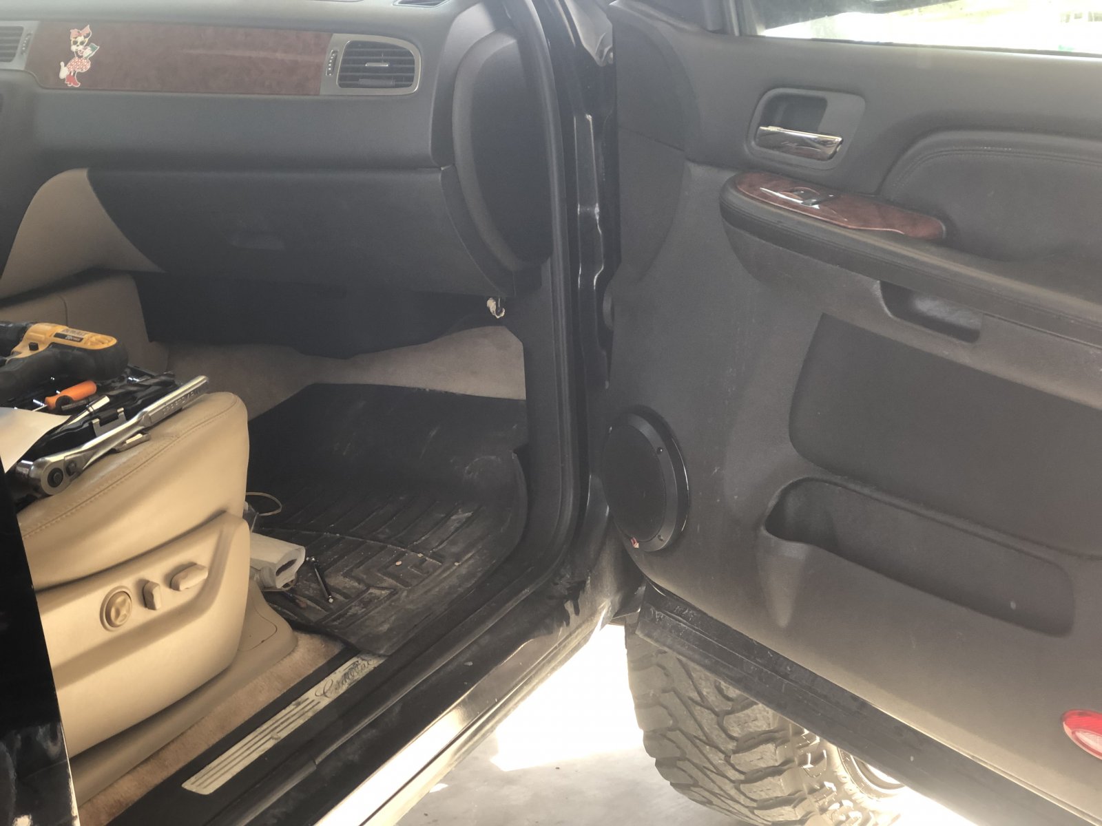

My new door speakers and amp now I just need a highs amp and a good alternator to power it all!I can only turn the bass up 1/4 way before it drops the voltage this amp is a beast!

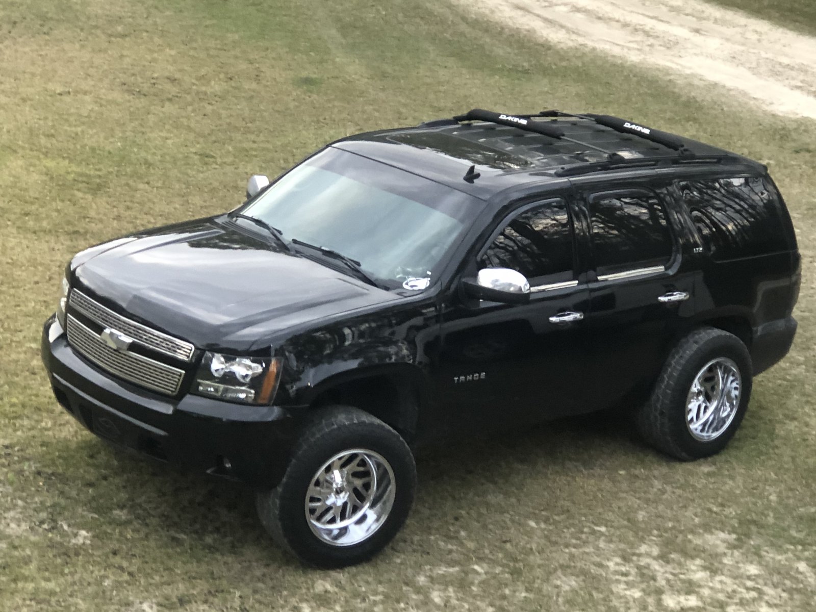

And this is how she sits as of now!
Still got a lot to do but she’s come a long ways from the day I got her
