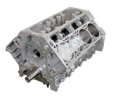

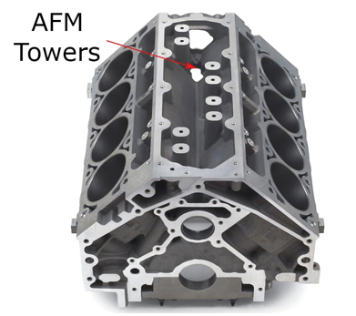

I thought they were 1,4,6,7
Lifters - AFM engines use special lifters for cylinders 1, 4, 6, and 7. They are taller and have special oil holes.
You're correct! Note that they have the image of the L94 block is taken from the rear on that page, which is where I got my reference for my post. The AMS image below is taken from the front with the AFM towers on the 1,4,6,7 cylinders. Thanks for the catch!
Summit site (taken from the rear)
AMS racing site (taken from the front)
