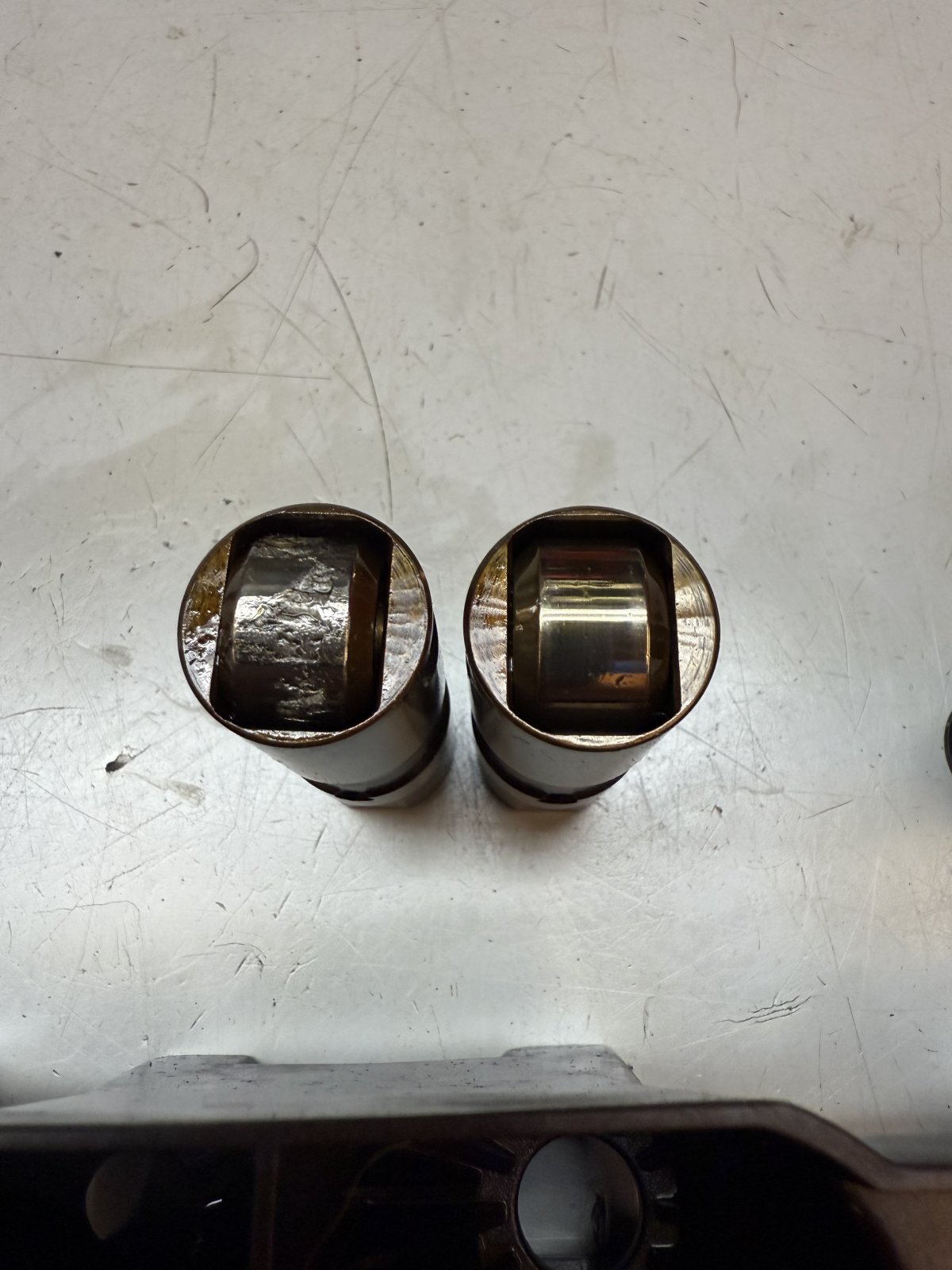

Found it. #5 cylinder intake non-AFM lifter roller is fragged.
I have not gotten a look at the cam lobe yet, but I am assuming it is ruined.
Will post full update later.
Full DOD delete is now beginning. :cool:
Sure enough!
I'll bet the cam is damaged also. Could've been a bit of debris squeezed between the cam and roller that started the spalling, but that looks like bad metallurgy to me.
