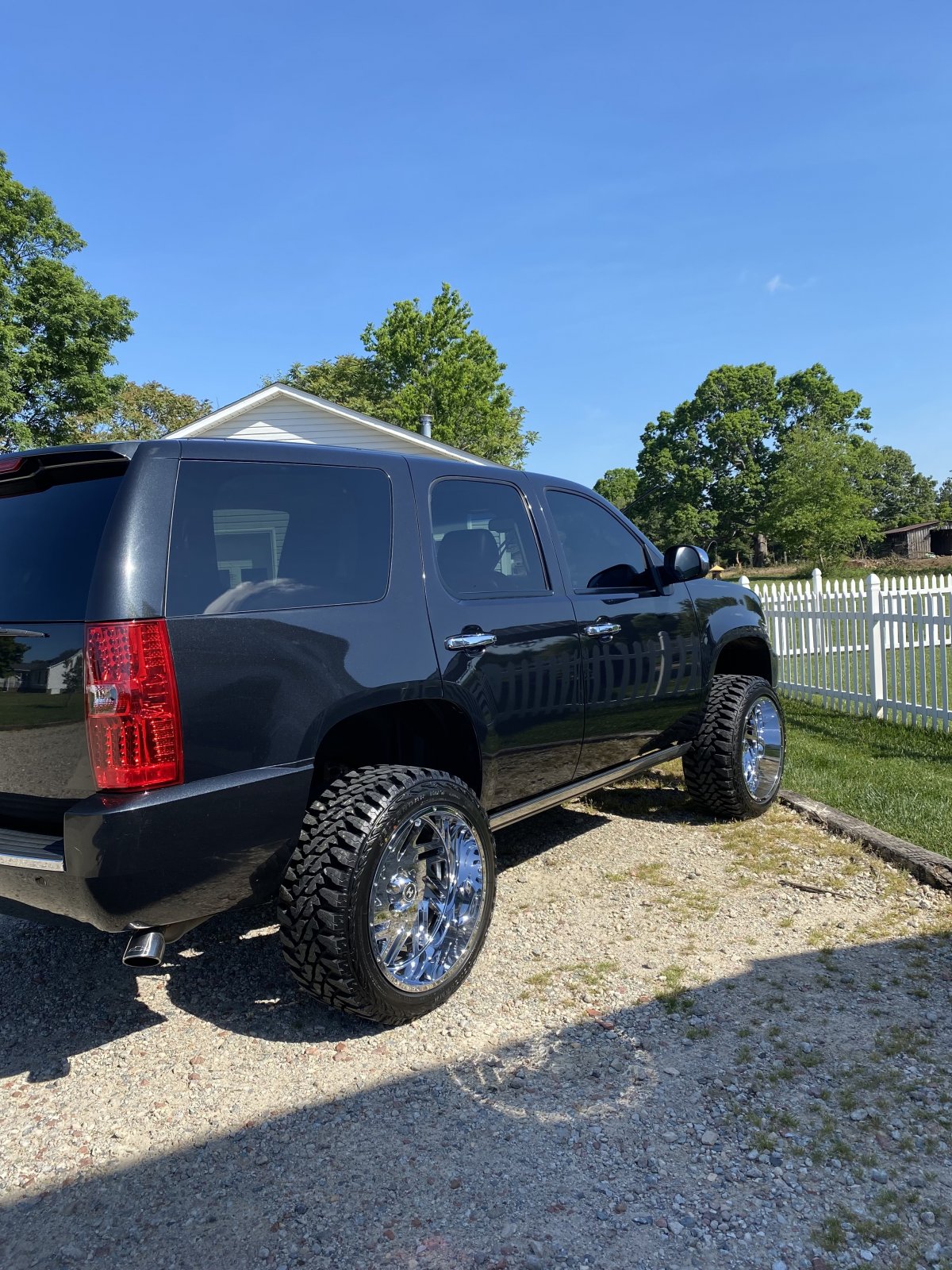

How’s it going . Been on here a few times trying to get some help with my tahoe and still really don’t know what to do. So i have a 2013 LTZ Tahoe with Z55 the tahoe has a 3inch lift from what i was told from previous owner. Under front struts and then a spacer under the rear coil spring. And man it rides like absolute crap you can feel every bump and dip in the road. Its on 22x12’s and 33’s but my sierra had the same set up and did not ride this bad. Any help would be appreciated. Really hoping to not have to get rid of the Autoride or have to get a bigger or smaller lift. But I definitely would like to figure out why its riding so badly compared to my truck. Thanks Guys!

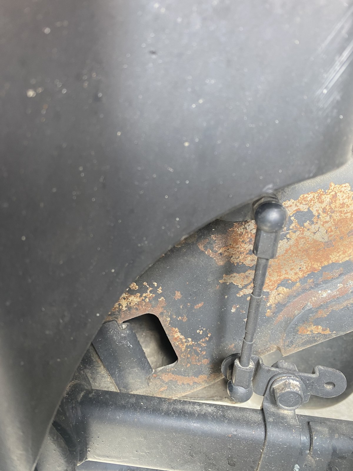

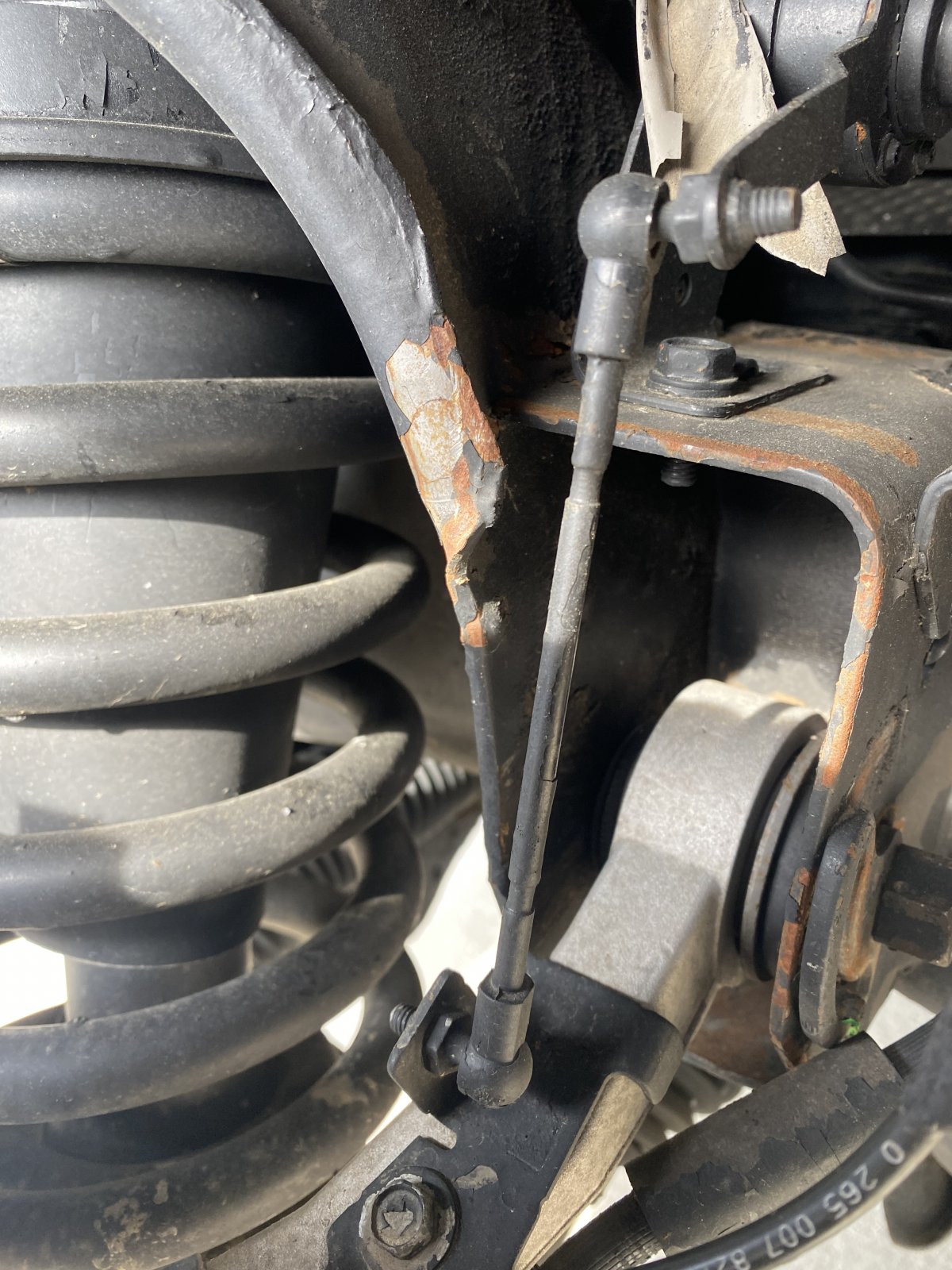

Don't you need to to rig the ride height sensor so that it isn't maxed out all the time because of the lift?
Yes i had bought some sensor extenders but it seems they still are tapped out which i suspect is why its riding so badly

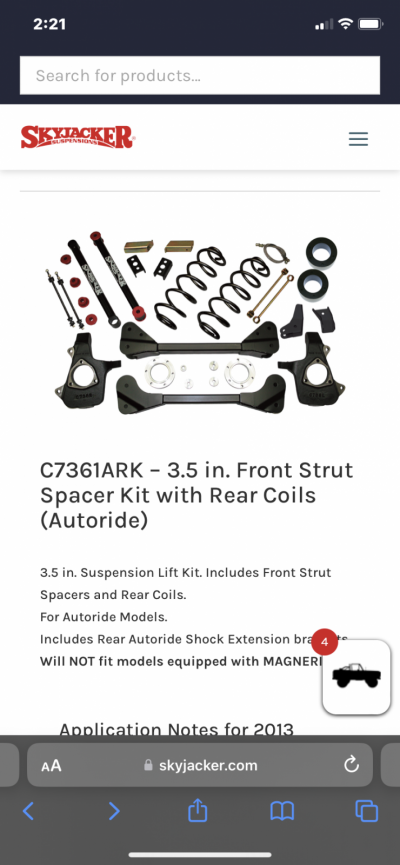

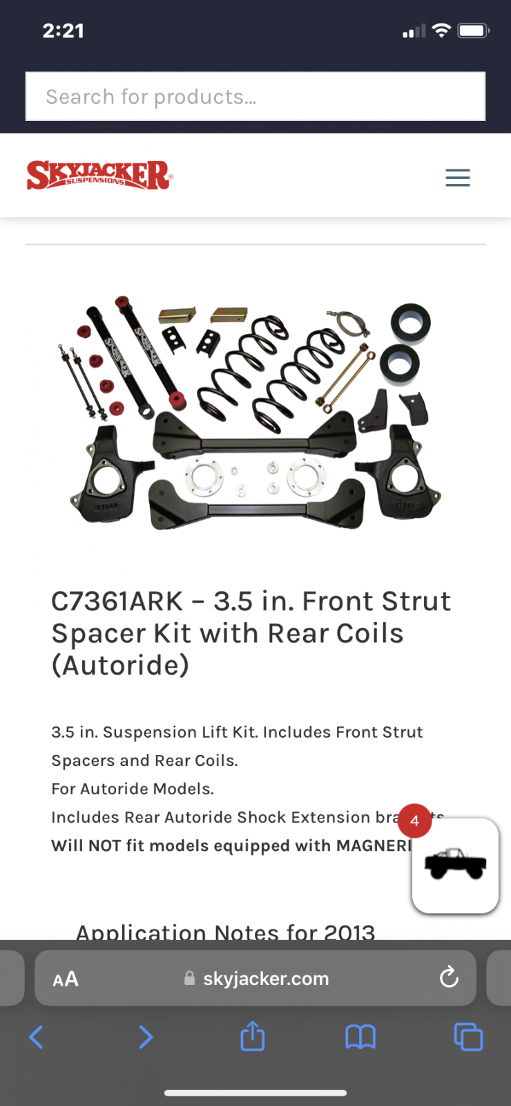

Honestly thinking of just pulling the leveling/Lift and ordering a new kit so i know exactly whats going on it. Vs now i have no idea what all is done and if it was halfway done which seems like it is

The first thing to do would be to have the ride height sensors as close to the position they were in before the lift. Maybe even zeroed out (requires a Tech2 or capable bi-directional scan tool). Do you have shock extenders on the rear?

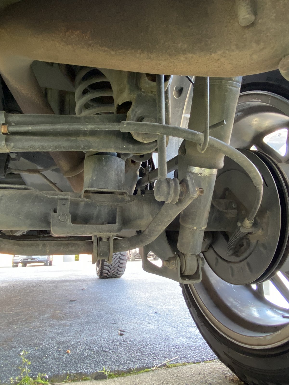

I don’t haven’t been able to find any that are compatible with the Rear Air Shocks

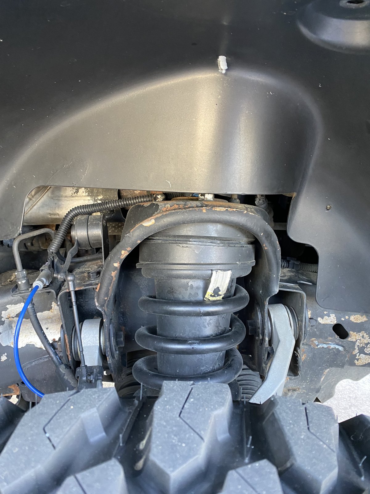

@13_Metallic I see multiple things wrong with your suspension.
1.) Ride level sensors are maxed out, that's bad. I can't tell which struts those are but lets assume they are the factory struts auto ride.
2.) Rear shocks are fully extended at ride height, also really bad.
3.) Rear sway bar end links are too short now your rear sway bar is at crappy angle.
At this point you need to decide if you want to keep auto ride. I'll give you a hint, you need to get rid of it.
I recommend you get a set of 4 bilstein 4600s or 5100s, rear shock extenders from Rough County, Moog 81069 rear springs, and some 3 inch lift JK sway bar end links. That should set you up nicely.

Sounds like the lift is stretched out so your uca may be bottoming out? Are the bump stops cut out already?
