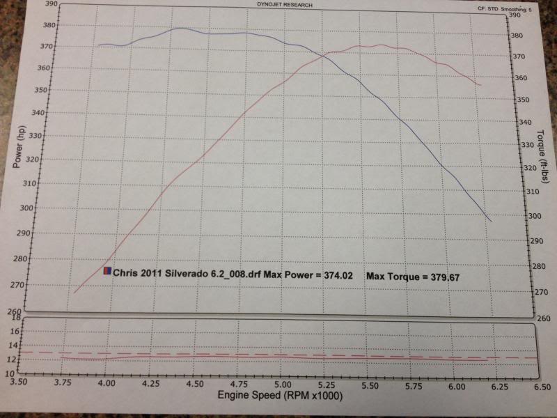

I havent ever taken this truck to the strip, its such a heavy ***** Im afraid ill break something lol but I do eventually want to get it Dyno Tuned, hopefully sometime next year so we should evntually know what she makes...when i had my 2011 L9H Silverado Dyno Tuned it made 374 RWHP, it was stock except for Kooks 1 7/8 Headers...I would expect similar numbers from this one since it has a cam but Im using the factory Manifolds and Y-Pipe with Corsa Cat back....
I found my old Dyno....
