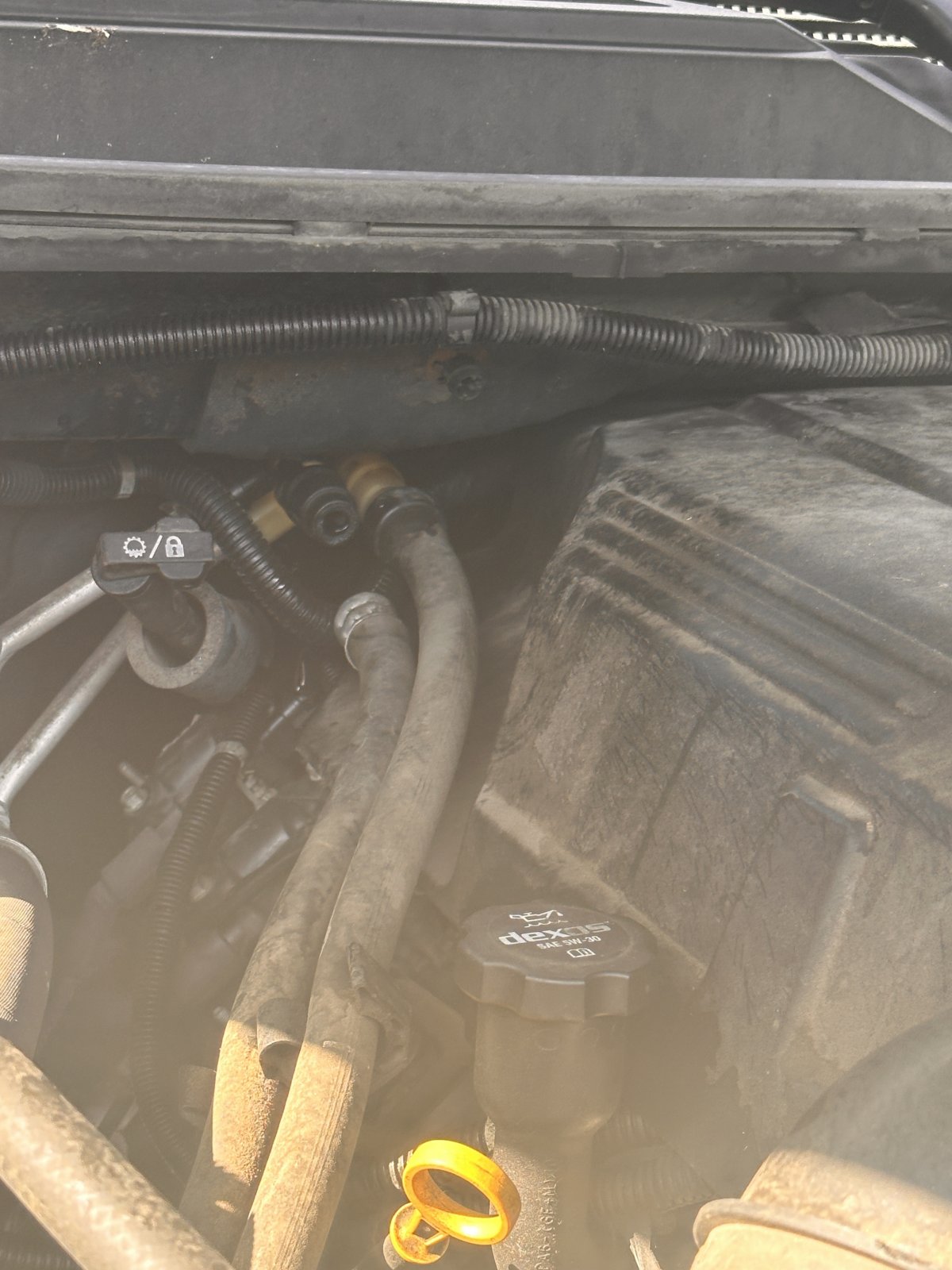

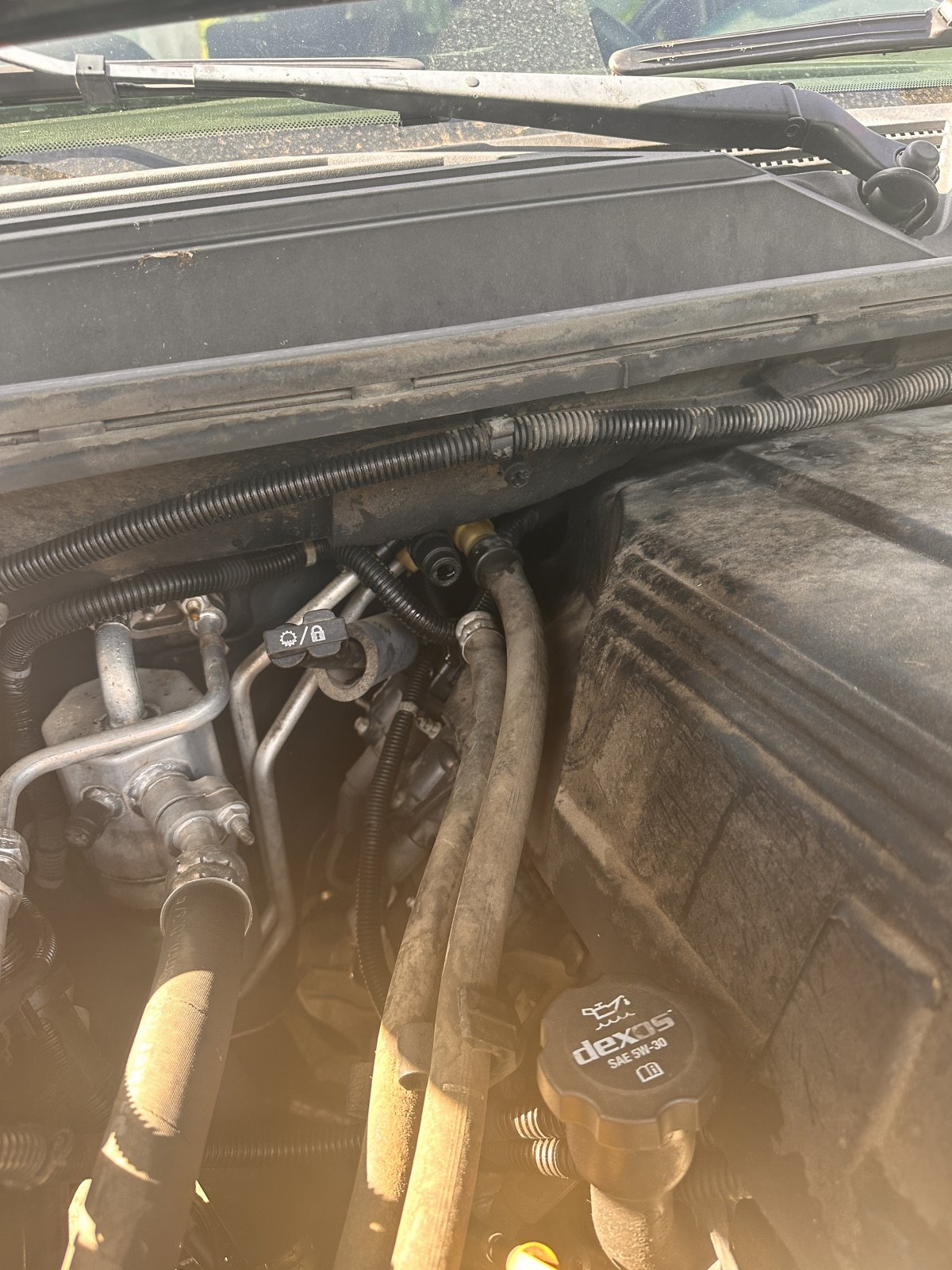

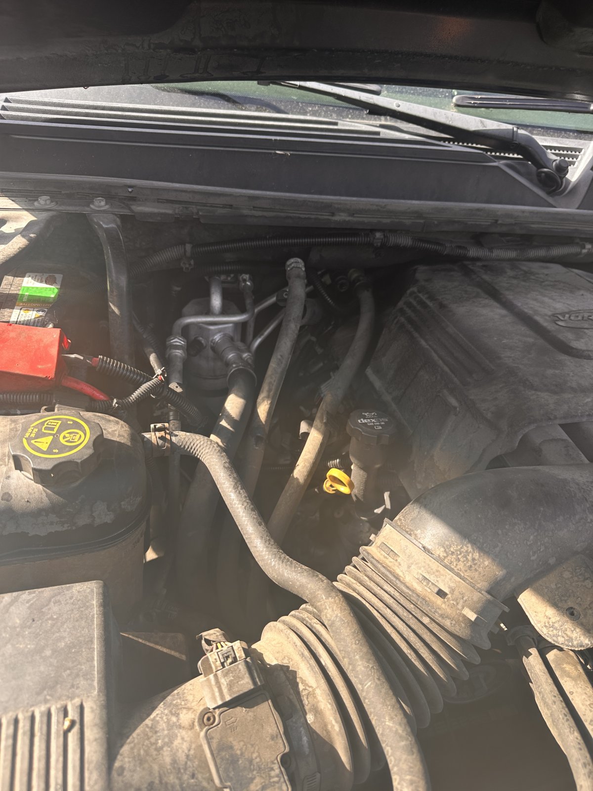

Hi everyone! I was driving home today and all of sudden my 2012 Yukon XL started making this horrible sound and I popped the hood and found this; I've searched online to find out exactly what this hose is but cannot find anything that will actually give me the name. Could someone please tell me what this is and if I am able go to an auto parts store/online
and get a new one or if I'm going to need to take this in.
Thank you so much!

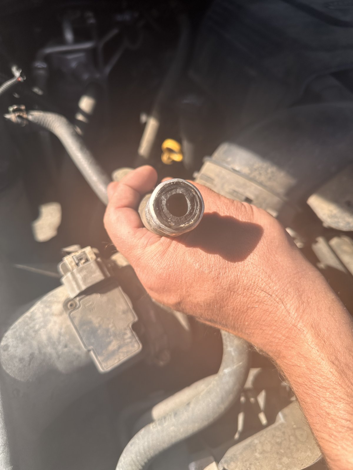

Heater hose and heater T's. Although it looks like the hose end broke, you definately want to do the T's while you are in there.
Definately do both while you are there. Don't drive it until you do, or very short distances only.
Throw a blanket or cardboard over your radiator support and kneel on there to reach it.

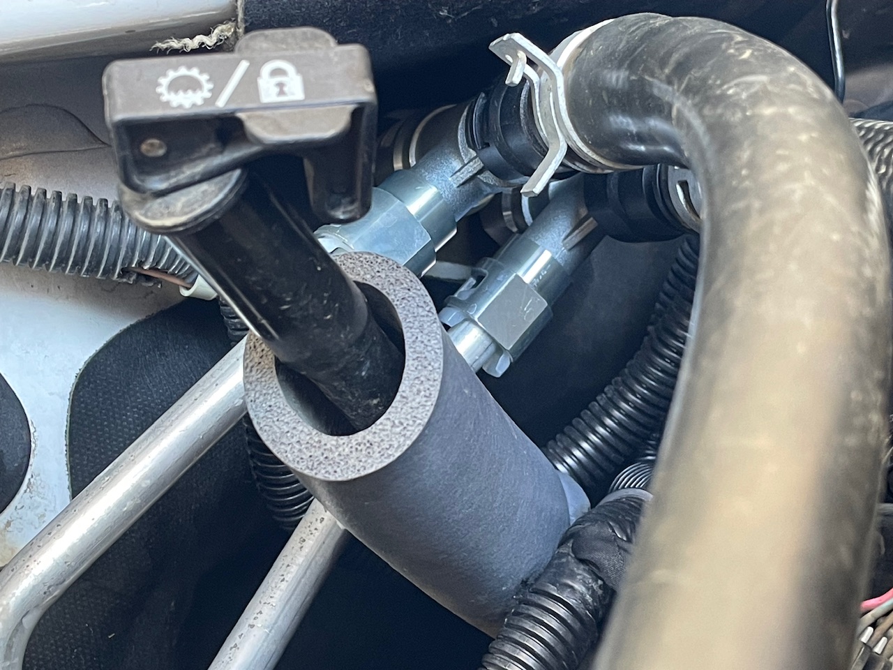

You gotta push two opposing tabs that stick out the end of the fitting.. Remove connection from firewall, then the aux lines that branch off.
90 degree T is inboard line, angled is outboard line.

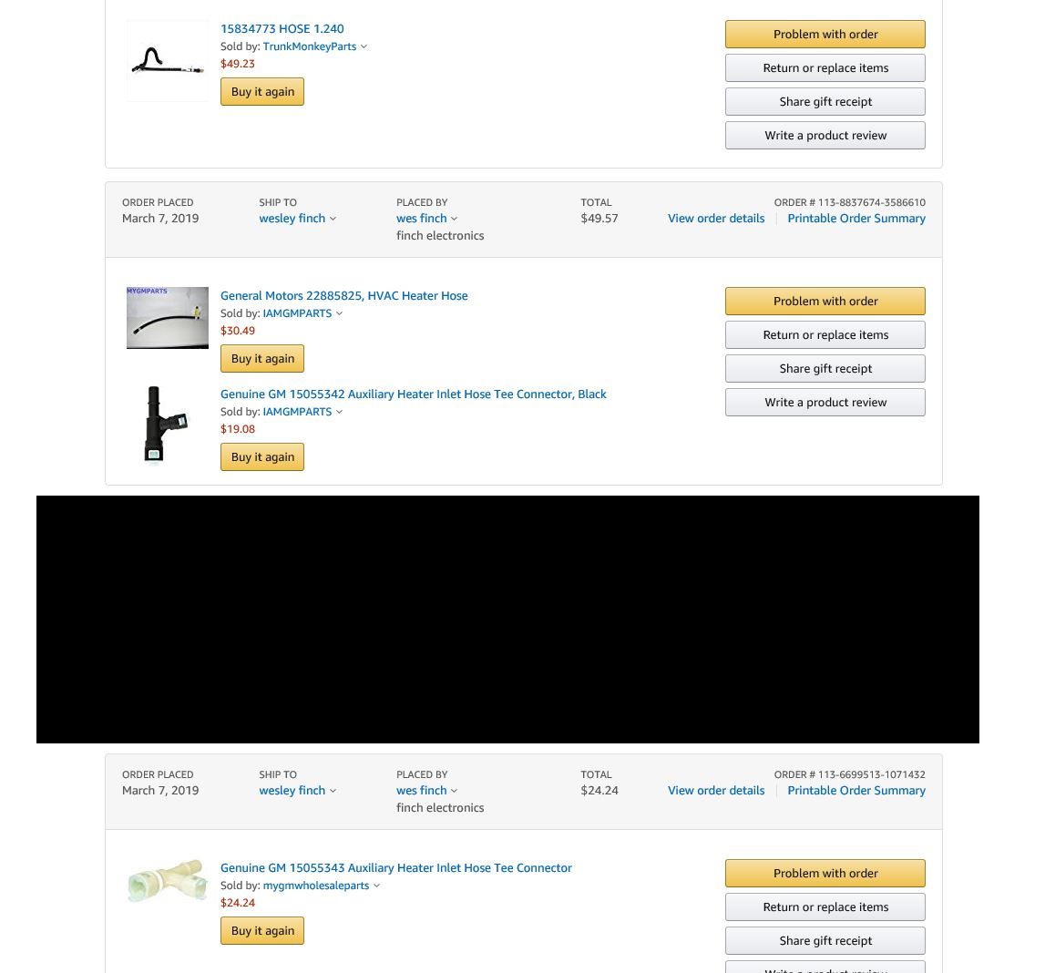

The Dorman aluminum T's are actually cheaper than the GM plastic ones.
