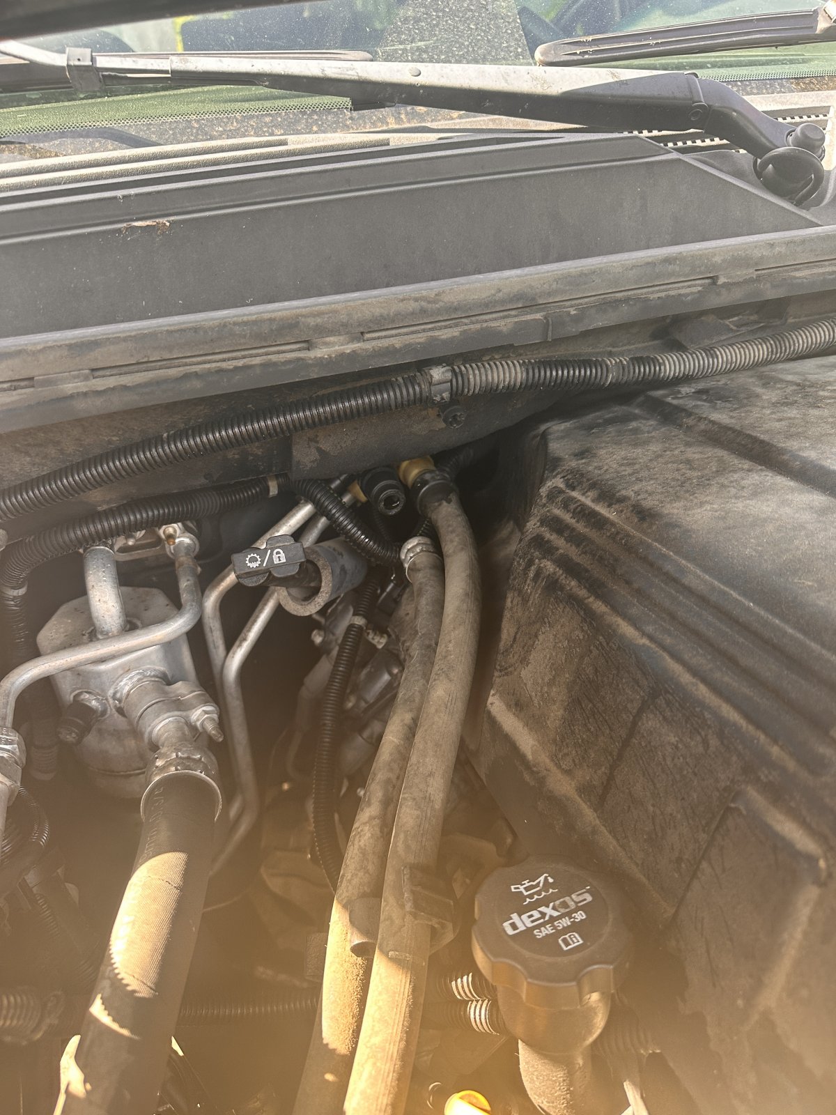

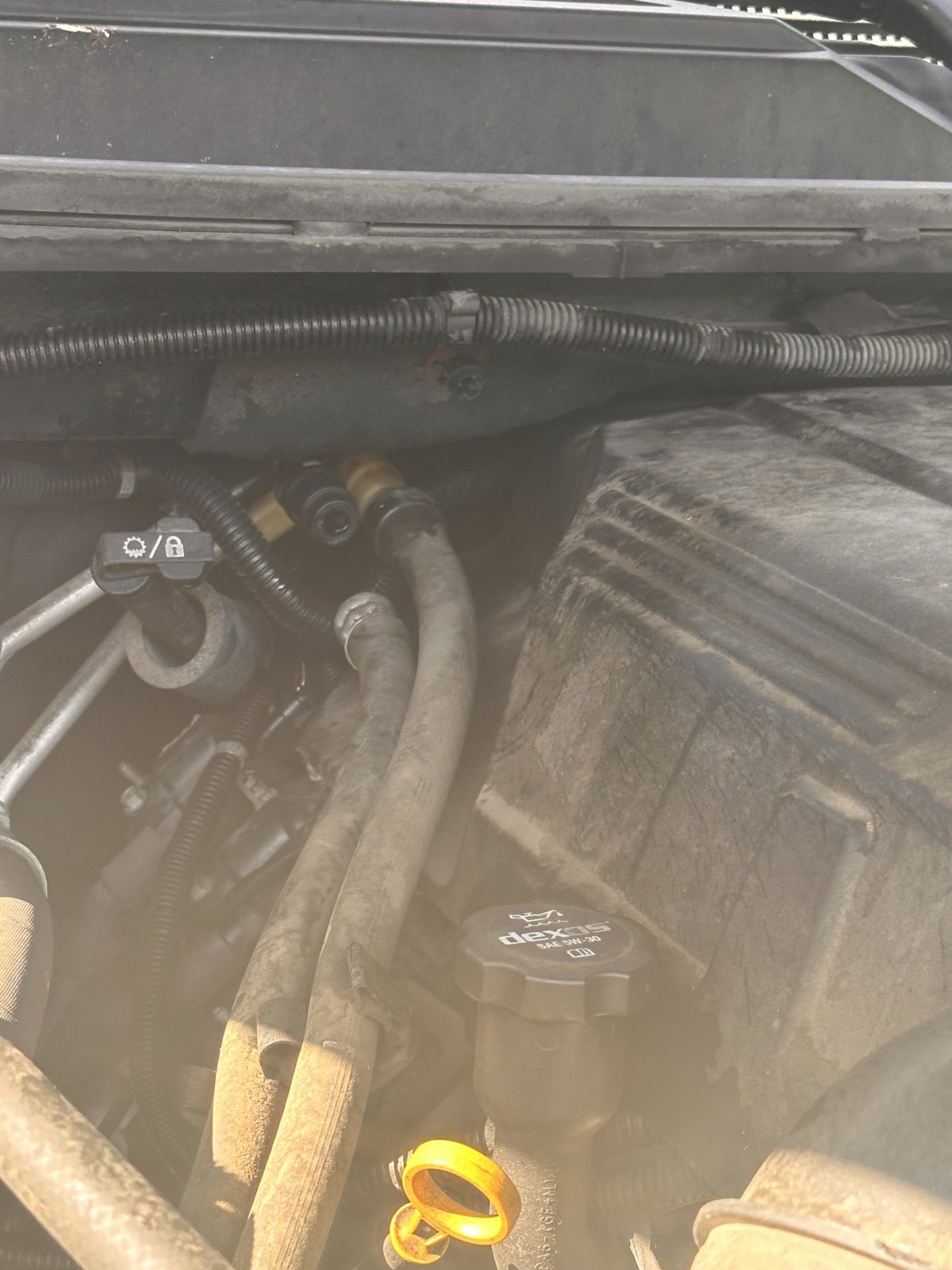

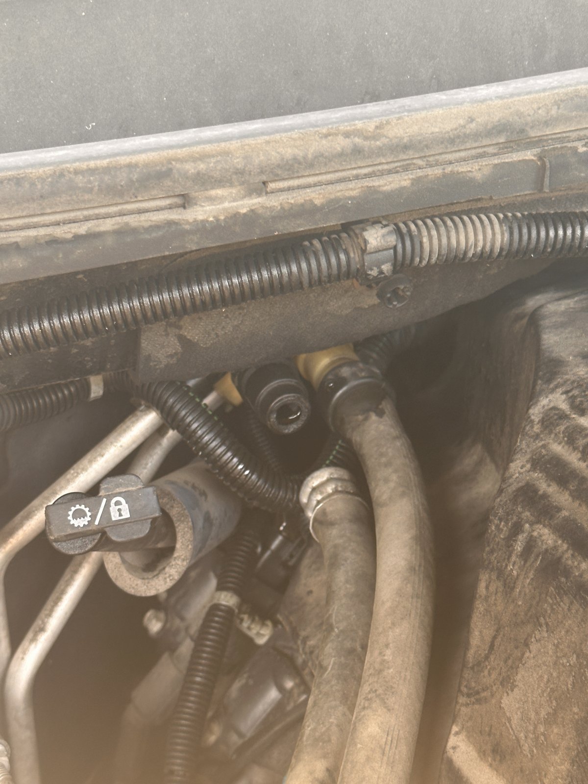

Hi everyone! I was driving home today and all of sudden my 2012 Yukon XL started making this horrible sound and I popped the hood and found this; I've searched online to find out exactly what this hose is but cannot find anything that will actually give me the name. Could someone please tell me what this is and if I am able go to an auto parts store/online and get a new one or if I'm going to need to take this in.
Thank you so much!

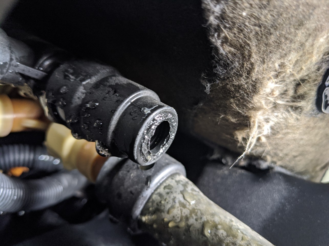

Oh yeah.... It was on my truck about 3 years ago.
You have a couple of options. Replace with an OEM Tee (NOT a Dorman aftermarket Tee) or a metal Tee (made by Gruven and others). Folks here will chime in on the metal Tee sourcing, which a a permanent fix. I went with OEM replacement Tees (~$30 each at the dealer), and I used the dealer, due to time constraints. Be sure to replace both Tees, and ALL heater and radiator and overflow hoses, as most are probably original (manufacture date is often stamped on the hoses).
When working with the Tees, be sure to use gloves, as the firewall insulation is quite aggressive, and you hands will itch for a few days. When trying to de-couple the Tees, push the hose into the Tee, while twisting slightly, and while pushed in, squeeze the 2 clips on the side of the Tee, and then pull. Sometimes, the hose will come out quite easily. Other times, you will need to cut the Tee off, being careful not to damage the metal tubes from the front heater core and rear heater core connected into the back sides of the Tee.
Let us know how this works out for you.

I did these and all the other hoses, thermostat and such at the same time. A lot of people complained about how hard they are to remove but maybe my skinny hands got luckily but I had no issues and had them off in like 3 seconds each. What I found was grip them fittings on the plastic tees, push them back towards the firewall and then push down on the tabs and pull forward. Mine came right off. If you pull them and the squeeze it seems to put additional pressure on them so push back, squeeze and hold, then pull forward. I bought OEM ones from Rockauto and have had no issues in 6 months or so.
