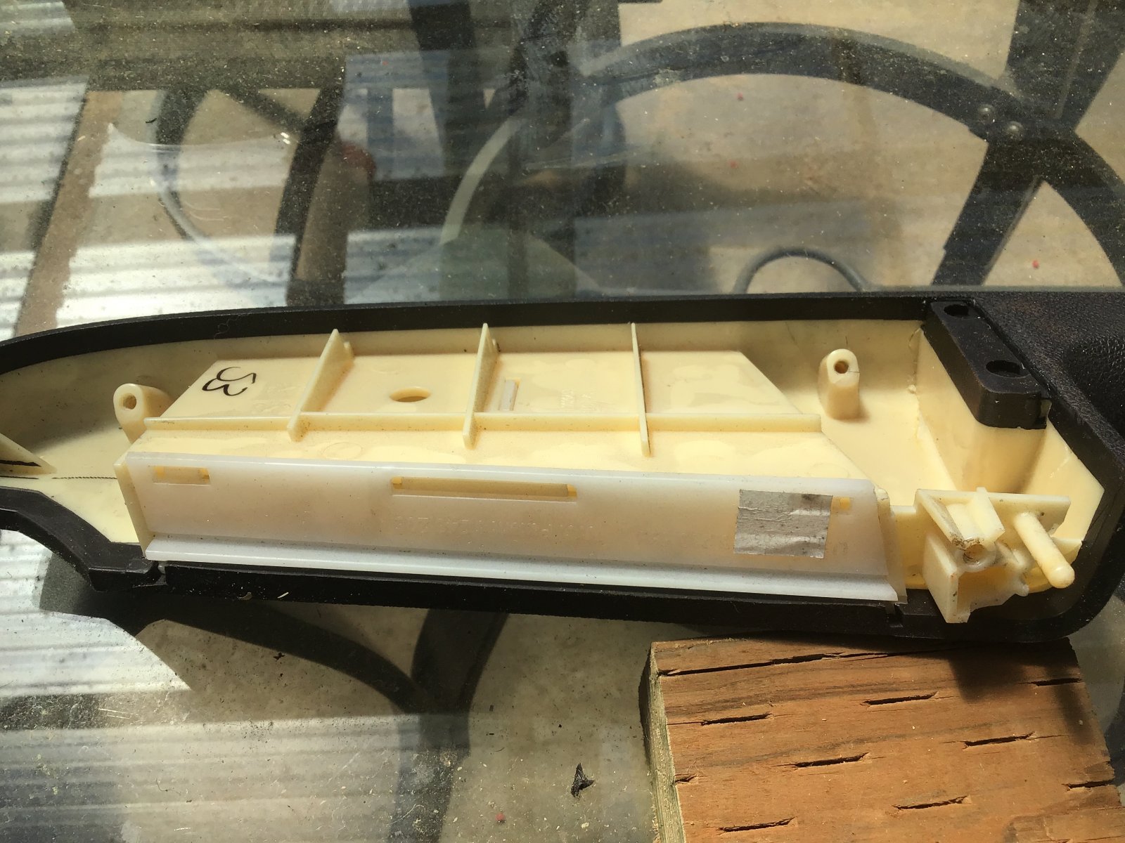

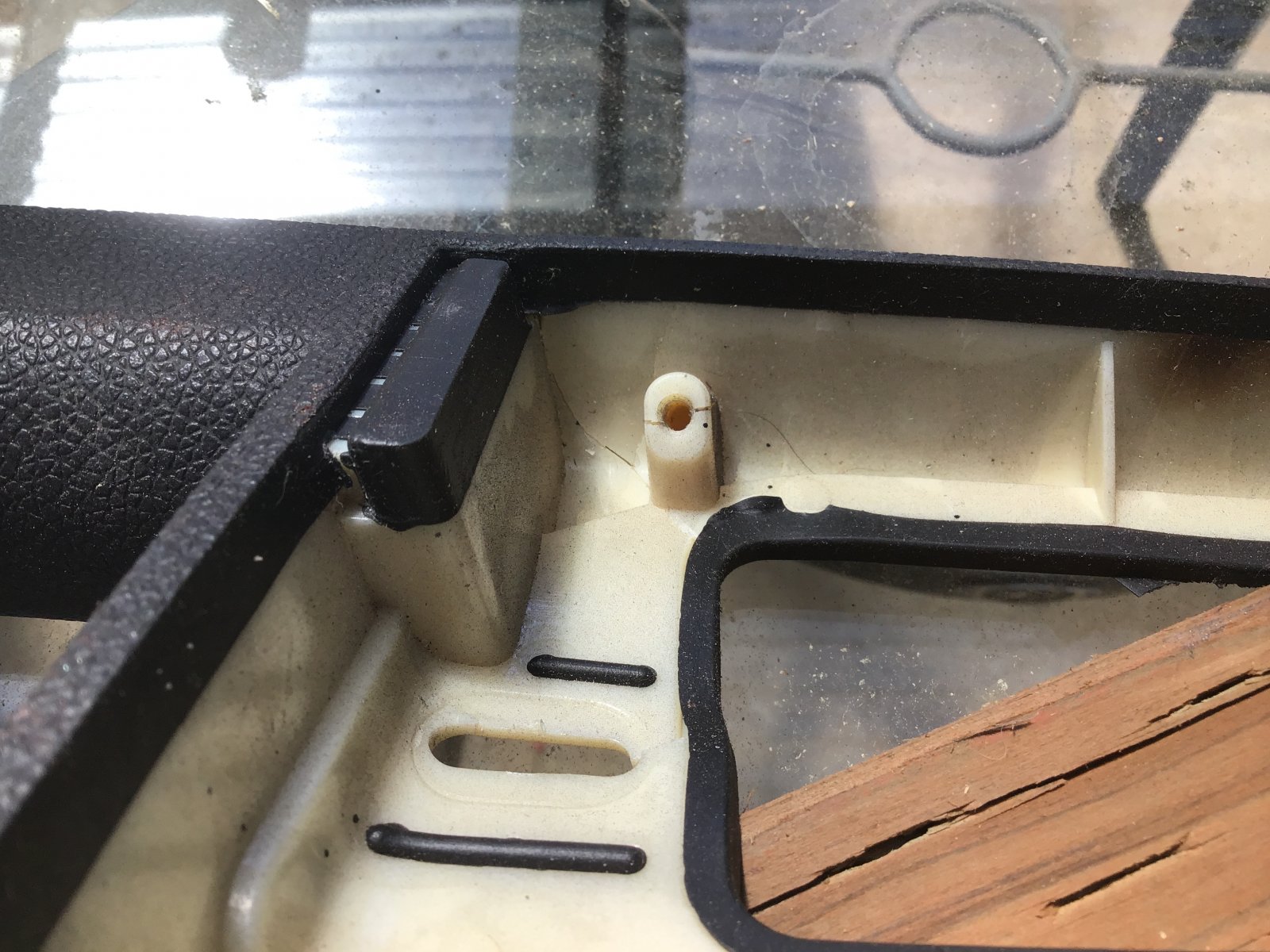

I don’t see how. A complete reinforced handle is needed. Here’s one that I saved. In this first pic there are 4 screw locations. The 2 in the foreground that are kitty corner next to each other are 2 of the ones that the metal plate attaches to. You can see one is completely wasted and the other won’t hold a screw tight. The 2 in the background are where the door panel attaches to the handle. One is cracked and won’t hold a screw. The handle itself is cracked around this area too, because the metal plate wasn’t doing it’s job because it was no longer attached to the panel, it was just attached to the door itself.

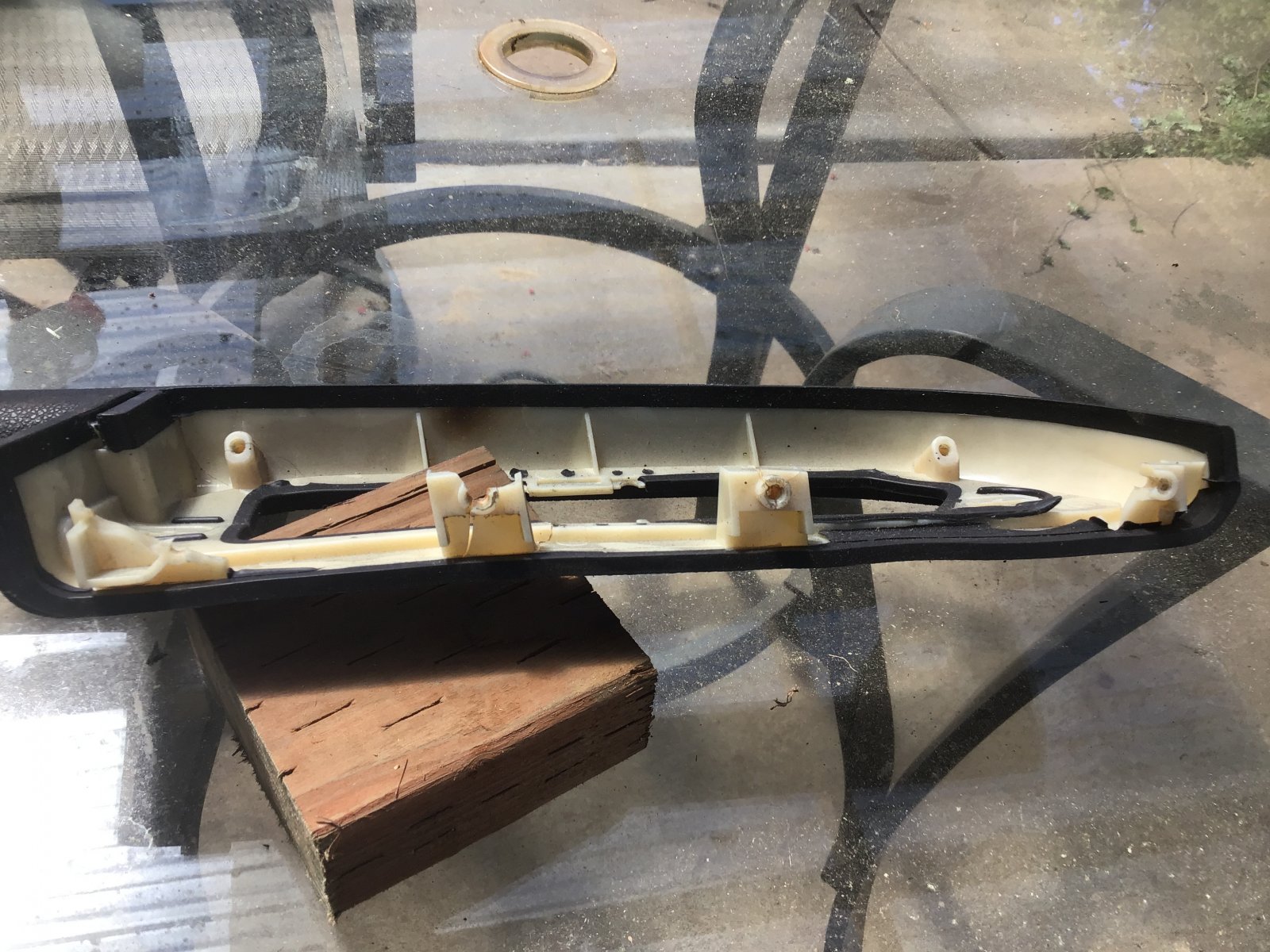

Here’s the other half of the handle. It has 7 screw locations. The area where the metal plate is supposed to attach , left foreground, is completely broken. There’s nothing attaching the handle to the door itself on this side without that plate being attached to the handle, it’s just attached to the door panel itself via the other screw locations of which there are 5 total and 4 of those won’t hold a screw. Notice the broken plastic in the area by the left screw in the back. It’s cracked in the corner. Keep in mind, this door panel and handle was still functioning when I bought it. I disassembled it to paint it, and that’s when I found out how bad it was. There was no use installing it. All it needs is the handle but I can’t buy just the handle. I don’t see how Gruven could make something to fix this. And I don’t care how gentle you are closing a door with this panel on it, it’s just a matter of time before the last 2 screws come out since the steel plate isn’t doing anything.

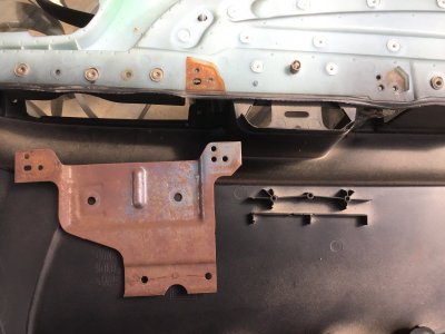

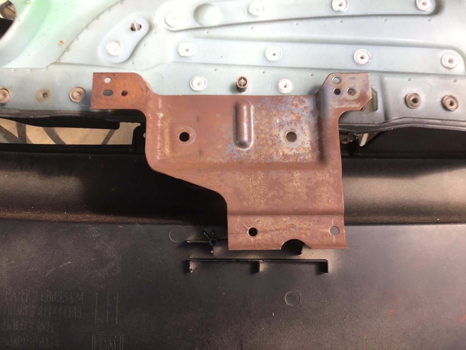

Here’s a metal plate, it’s not the right one for this panel but you get the idea. It attaches with 2 screws at the bottom into the panel and 4 at the top into the handle, then it attaches the panel and handle to the door with 2- 10mm bolts. If it’s not attached to the handle because all the screw races are broken then it’s not doing any good and your panel is weak. And you cant even tell unless you remove the handle because the 2 at the bottom never break but that’s not doing any good.
