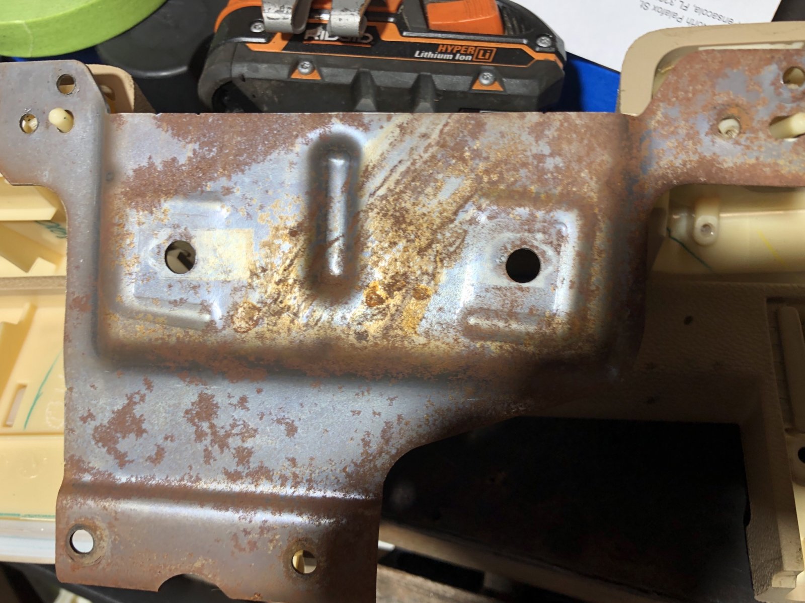

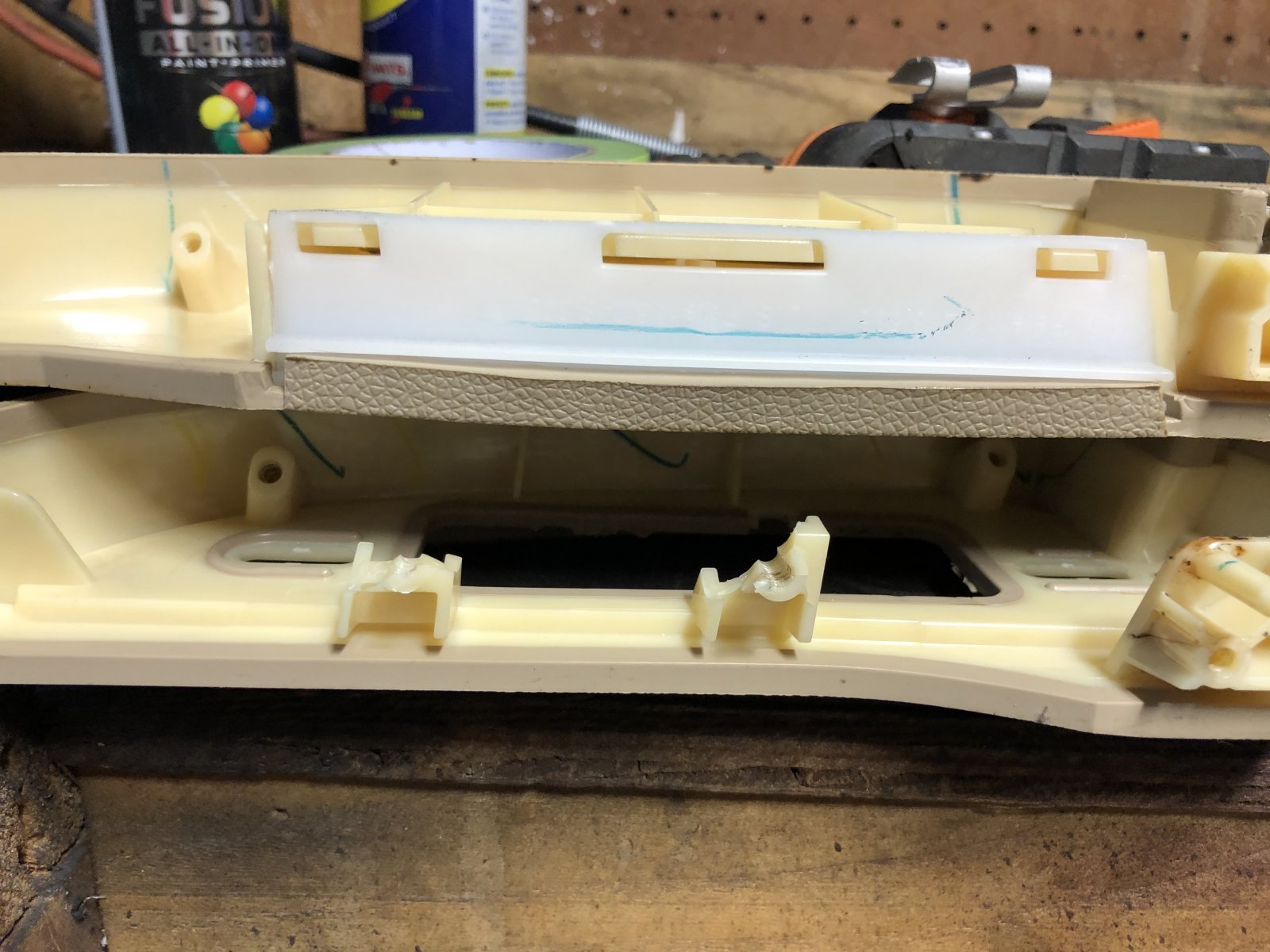

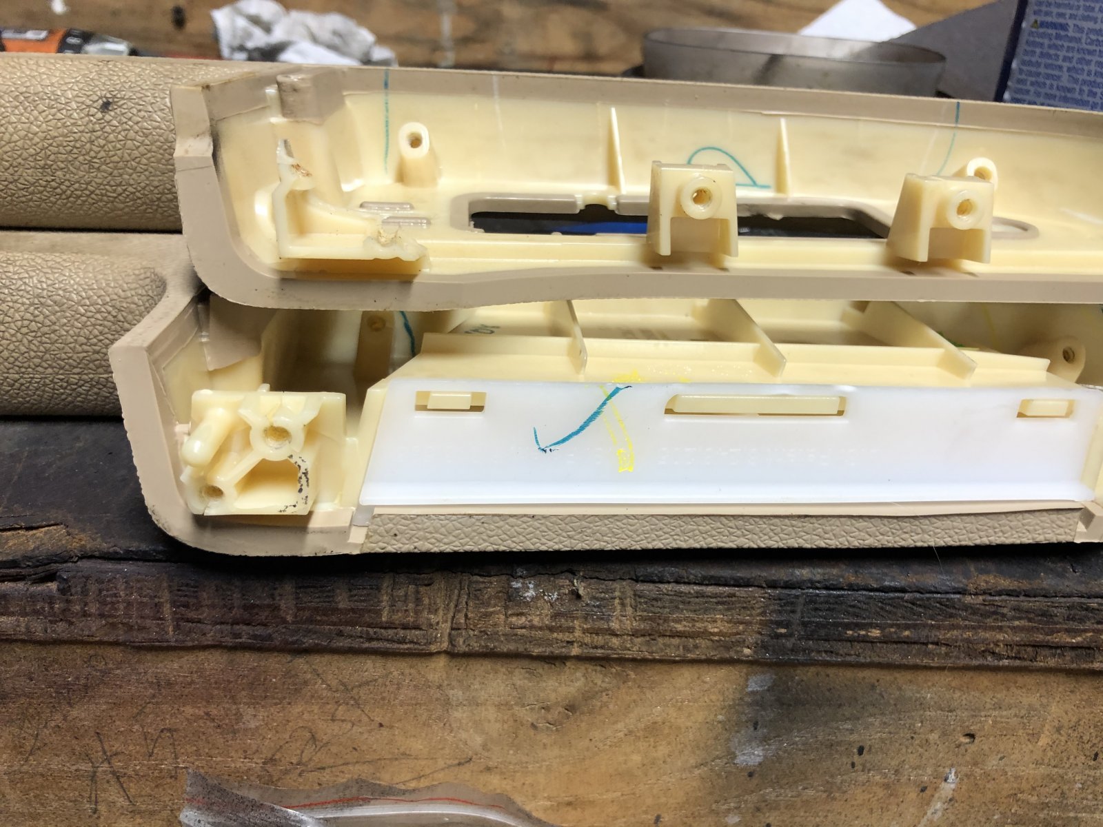

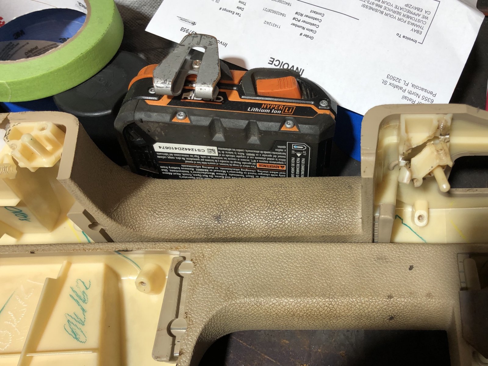

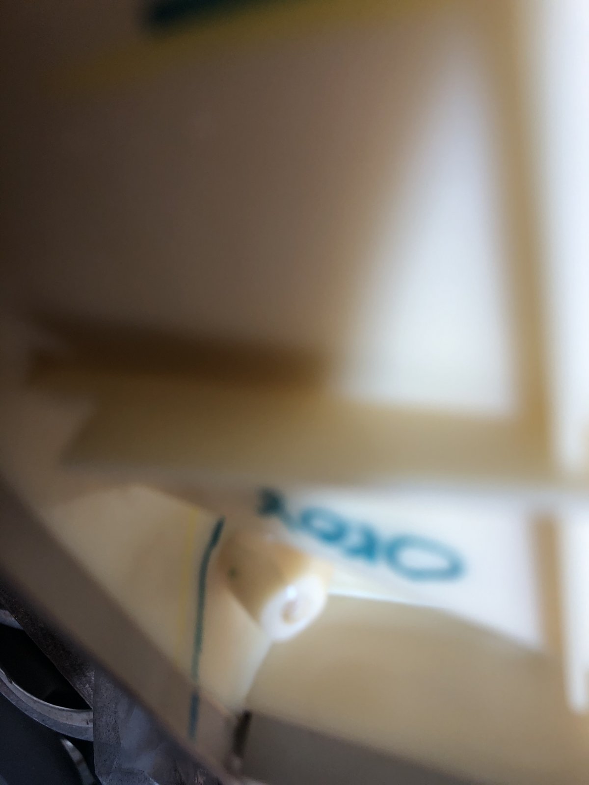

They’re a weak design just like the dashes. I bet if anybody pulls the handles off their door panels on these trucks you’ll find where the screws thread into the plastic is all broken. Eventually the handles will pull off the majority of them and fixing them is almost impossible due to the design. Here’s some pics of the broken screw races. Of the 7-8 door panels I bought, 75% of the things were broken and wouldn’t hold a screw. There’s about 12 screws that hold each handle and the metal plate to the door panel and most of them wouldn’t hold a screw. I got refunds on 3 panels and made the other 4 work but they’re not 100%.
E4310376-06DA-45CB-AF5C-64CAF51809FE.jpeg F6524BDE-E185-4261-A0A2-38DEBDBD52F4.jpeg 71971745-1A5D-4BB9-BEDC-D92A1597629B.jpeg 7BF8748D-8D9D-4B39-9253-B519C0B5DC1D.jpeg D23F8820-E22F-4BED-9E4B-42B47C9A8378.jpeg
52,954
You can see the pic of the metal plate there’s supposed to be 6 screws that hold that to the panel, and when you install the panel you bolt that plate to the door. That provides all the strength so when you pull on the handle it’s supposed to be directly attached to the door via that metal plate. But as you can see in the picture nearly all of the plastic screw races in the door panel are broken and when I removed the screws all the broken plastic fell away and there’s nothing for the screws to screw into. It’s one of the worst designs I’ve ever seen and once that plastic breaks there’s no way to fix it. At least not without re-engineering the whole thing.
