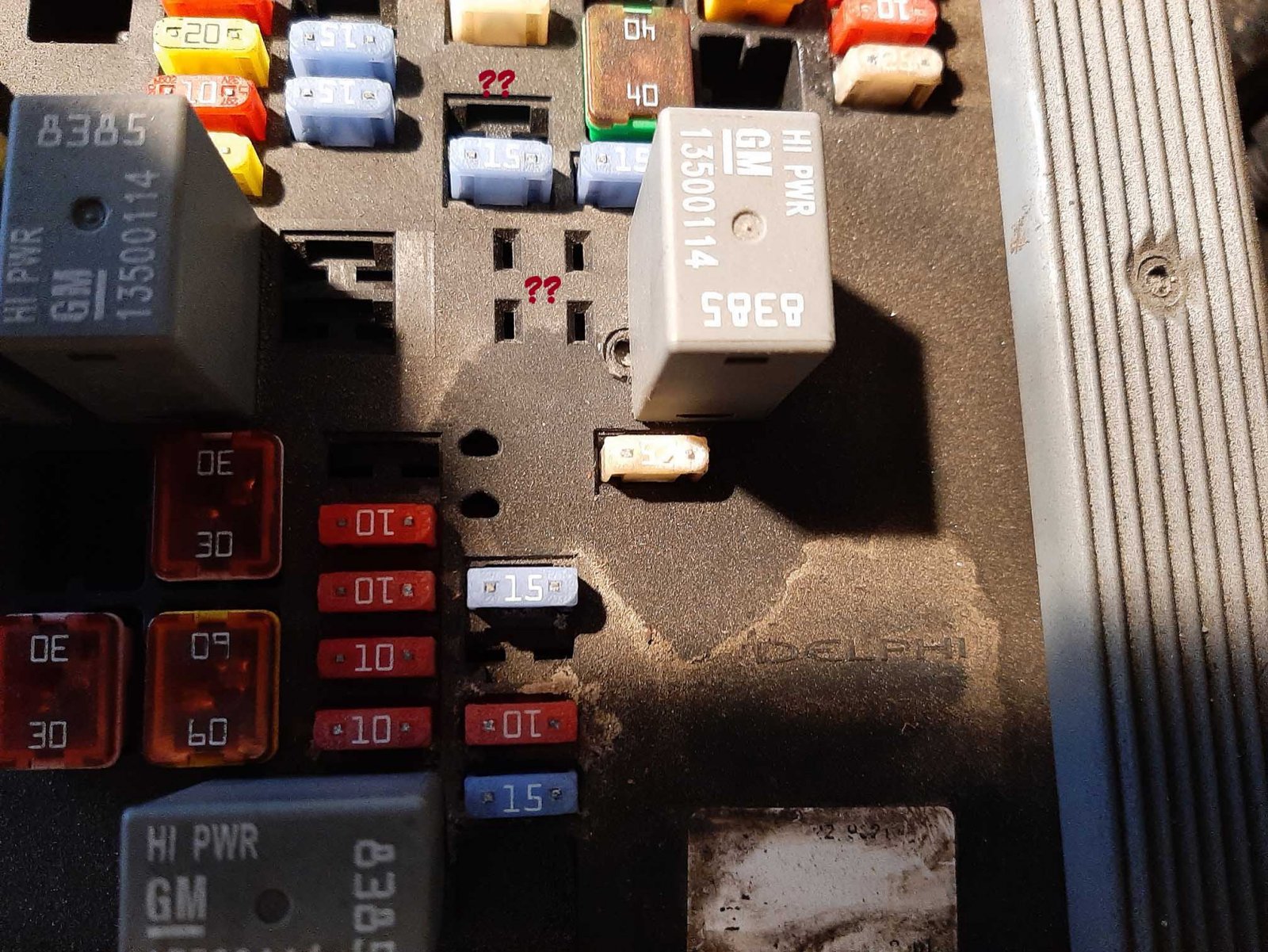

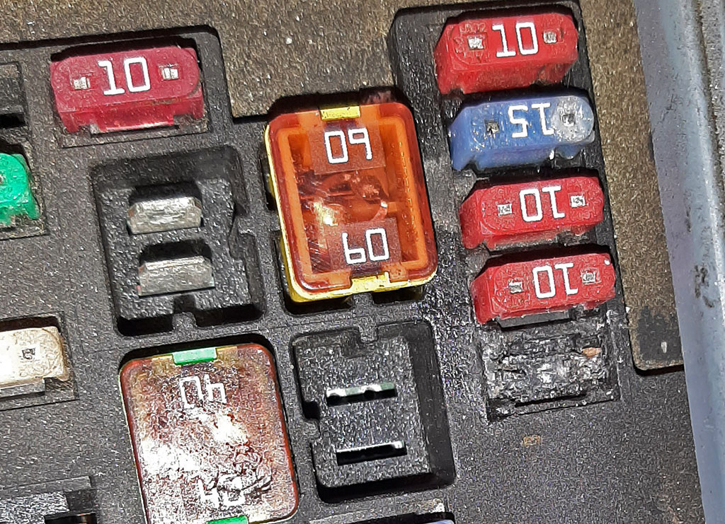

FOUND Something: Going over the Fuel System Control Module tests in the link @Fless sent, before dropping the Spare Tire, AND:
SWAG: Check power on both sides of fuse #21 for the Fuel System Control Module.
So I tried to lift fuse #21 a little so I could probe it. Seems stuck. Use needle-nose pliers.. stuck. Rock it a little and it came apart!!!
I have the top half of the fuse and it looks corroded. The PINS are still in the electrical block. I will go out this morning and try to carefully pull those pins out. I have good Contact spray and will use that first.
Any pointers on handling this kind of broken fuse appreciated!!

Hopefully you can get those fuse legs out without damage. I don't have any good tips for that.
The regular fuses can be tested in-circuit using the test points that are on each fuse, but that won't necessarily test for damaged legs or full circuit continuity.

It looks like that fuse had a bad connection and, being a relatively high-amp circuit, the connection burned and corroded solid.
I believe that whole top panel that holds all the fuses is removable. You could find a good one from a part-out, in person or online, and swap it. Take a clear pic of it and compare it to one from another car.

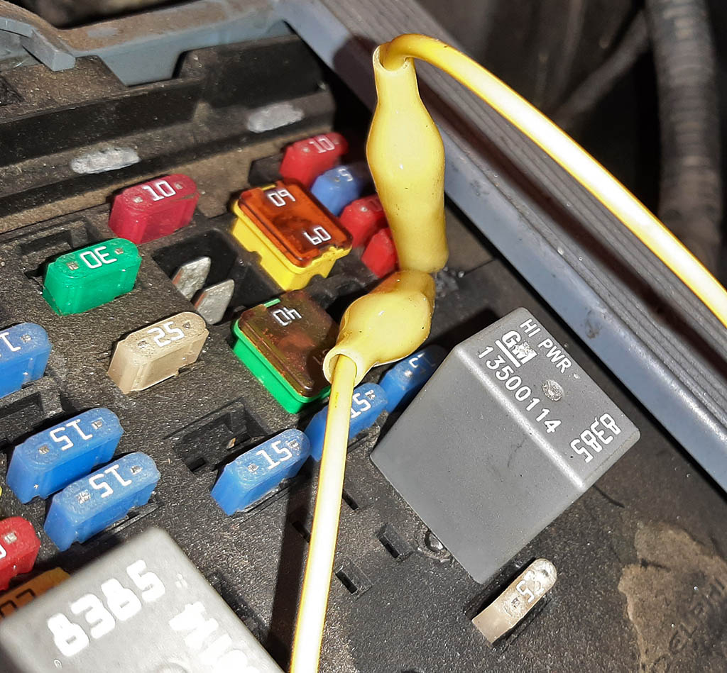

OK Here's the UGLY BUT RUNS for now. THANKS to everyone who helped with this. It's an amazing Forum of Friends...
AND Thanks for the parts pointers; I have found a VIN matching fuse panel within 50 miles. THAT will be the actual solution.
BUT In The Meantime:
The UGLY connection with soldered Bronze Nails, 25A Fuse and holder:
That carefully hammered in place, just aside the broken-off fuse legs. I sprayed some contact anti-corrosion stuff first.
The Fuel Pressure came up to 55 PSI and started immediately. After warmup pressure was 45PSI.
(Don't know how to put text to right of that....)
Warmed up, ran smoothly all the time. Locked brakes and put some throttle/torque in Drive (in the barn..) All smooth running.
So I need to carefully secure that fuseholder and get the cover back on.

@Fless, I ran this for 10 min or more and felt the top of those nails. Not hot at all as I felt it. I measured the voltage between the two tops and it was .018V (18 millivolts) and I assume that was mostly from the resistance of the fuse/holder.
I was able to ziptie the fuseholder a bit away from the edge and was able after some juggling to get the top cover completely in place (Always difficult).
