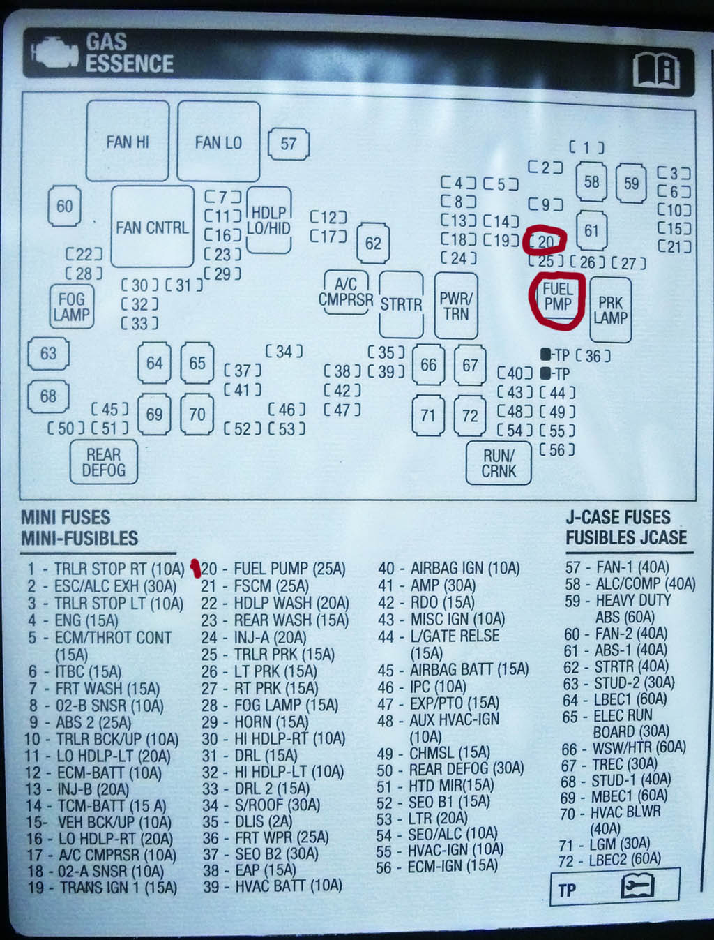

CURIOUSER and CURIOUSER: No FuelPump Relay OR Fuse in main electrical box...
FIRST: NO FUEL PRESSURE at key-on or Crank. DID hammer fueltank.
But I have the actual photo of the layout of the main electrical box:
There is NOTHING in the FuelPump Relay position and NOTHING in Fuse position 20 (Fuel Pump (24A)
I'm sure no one of my friends snuck in and took those, because the dirt in those locations is untouched. Also they are not THAT weird...
Here's that area of the Electrical Box:
This was a Government vehicle (Federal not police). Here's the actual RPO list:
So my burning question of the moment, of course, is WTF??
Anyone seen this? Any pointers? Any wild ideas?? Suggestions on Where To Start Looking?

SWAG: Check power on both sides of fuse #21 for the Fuel System Control Module.
When you turn the key on, can you hear the fuel pump run for a few seconds?
If you get this far, here are some test procedures for the FSCM:

They eliminated the fuel pump fuse and combined with the fuel pump control module. so you do not have a fuel pump fuse per say.
since there is no fuel pressure you could try pulling the harness off of the fuel pump control module and be sure it is clean and has no corrosion it is located under the spare tire on the bottom of the body. otherwise you may simply have a dead fuel pump I would certainly be looking under it with a flashlight for any chewed wires though mice love barns.

The video in the link I posted shows where it is, and the tests to confirm that it's the module. You can also test the pump using jumpers while you're there.
RockAuto listed two different GM OE parts, one with JL1 and one without. You have JL4, and it appears that the Dorman part in the link would be compatible since you don't have JL1.
The GM modules would require programming. I don't have any experience with these but am just playing show and tell. ;)
30,614
48,141
you could try the dorman module but if you plug it in then they are usually not returnable if it turns out to not be the problem, my money would be on the fuel pump froze up from sitting if the wiring isn't chewed up anywhere. Watch the video in the link Fless gave and it will allow you determine the problem.
