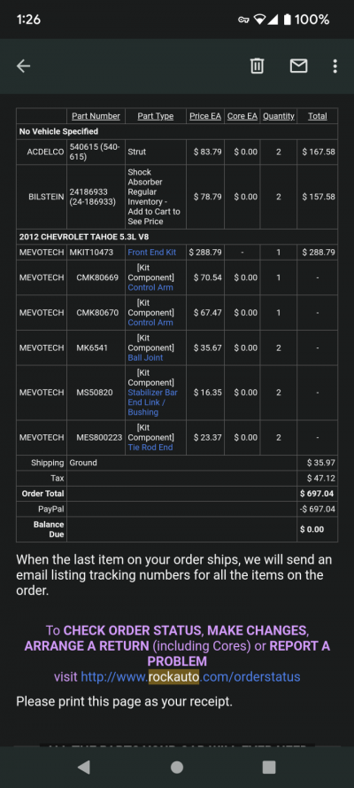

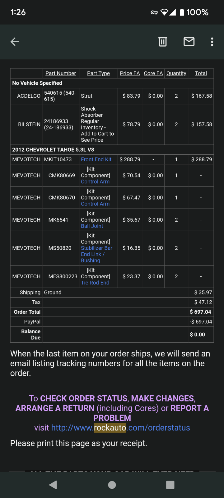

S1W99
S1W99
Nov 14, 2020
167
69
This is what was replaced as part of the mevotec kit. I also replaced the rear shocks with Bilstein 4600s

Well, the answer to my earlier question seems to be no. You really can't consider this a ZW7 suspension anymore because it is mostly a Mevotech suspension with Bilstein shocks and struts. You are still sporting the original bushings in the lower control arms, inner tie rods and all of the ten year old strut components and probably the same out back.

Front struts are Acdelco 540-615 OE.
