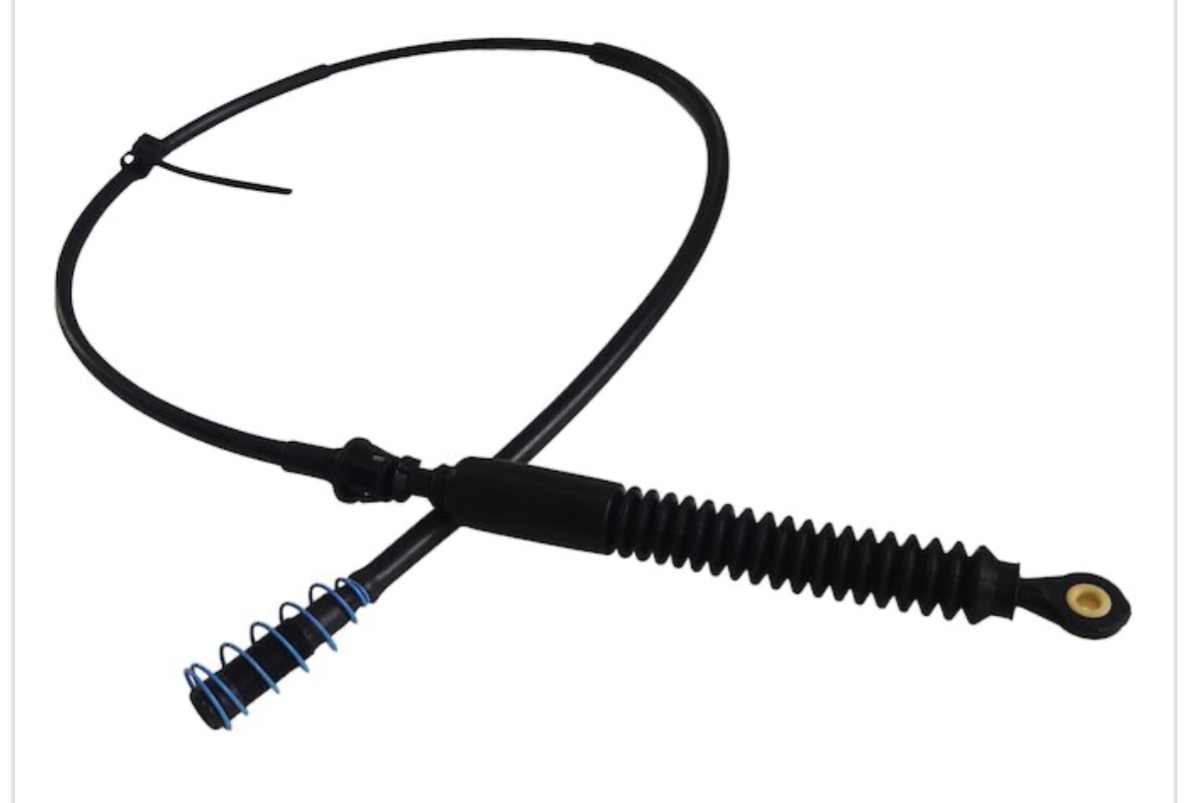

GM makes a 1/2 cable repair kit as well as SKP. Verify your fitment for any differences in 6.2, 5.3, XL and 4 or 6 speed.
I used the GM version of this one. It’s a timesaver as you don’t have to monkey with the cable up in the dash.

I ordered the new GM cable from Rockauto with the intention to replace it. I said screw it and just swapped out the bushing. Expensive little bushing. Lol. Worked great.

These 1/2 cable kits are for when the expensive little bushing, little bolt and bailing wire hacks have left the shifter felling like stirring mamma’s Mac n cheese. Eventually you’ve gotta fix it so the Mrs. isn’t stranded with the kids on a 100+ day.

after going thru a couple replacement parts that would also just "pop off" I drilled a small hole in the nipple and used a cotter pin
I ended up using a FITZALL T74498-1A replacement and went ahead and used my cotter pin fix as well and it has been fine for quite a while now
this would be the one needed for the 6l80

The Fitzall solution is very simple. They have a great application chart that makes selection easy. I'll try to attach it here.

just to update the fitzall has been working fine for me with my cotter pin as a secondary measure, I threw a spare in the center console just in case
