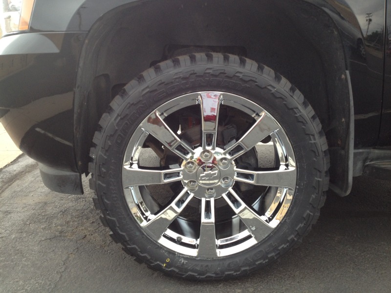

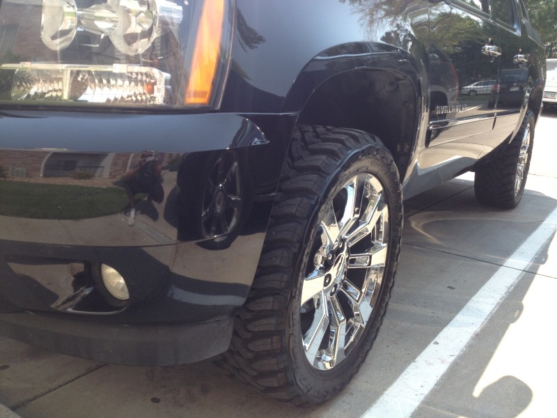

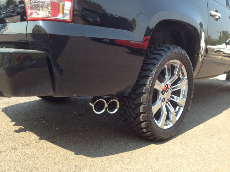

Honestly if he has 4x4 he should be fine as long as he stays in 4x4 when in snow/rain. My escalade is AWD so I put on some Nitto NT420S tires bc it's the sickest tread pattern i've ever seen on a road tire. My avalanche has 33x12.50R22 Toyo Open Country M/T's on a 22x9 with +31 offset rim. Here are some pics:

Thanks bro. They might fit your 22's BUT lowered it'll be rubbing pretty badly. I have a 2.5"/1.5" leveling kit on my avalanche and still had to trim the wheel well liners and take off the factory mud flaps since it was rubbing on those too. Depending on your offset your rims has, it could be better or worse. A positive offset would make it a lot easier for you to fit. My rims have a +31 offset which is a good thing as far as rubbing is concerned.
