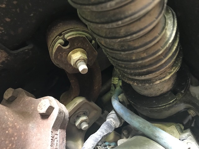

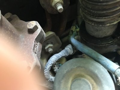

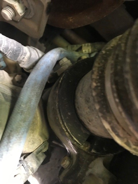

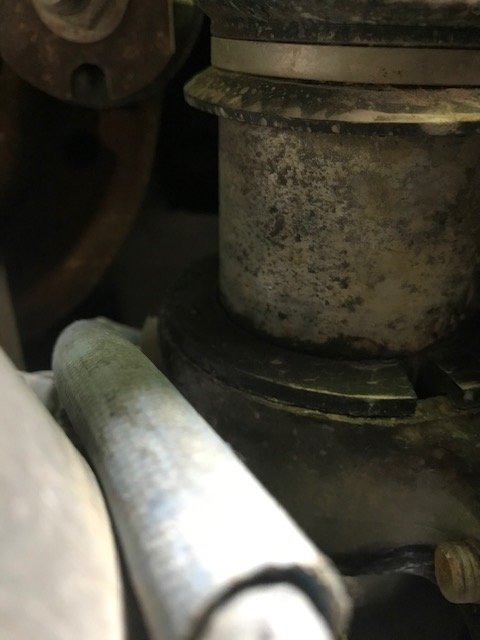

Looking for a steering rack bushing kit for a 2009 Chevy Tahoe Hybrid. It looks like I could just replace the larger one on the passenger side and be fine that is the one that moves and my alignment guy says needs to be fixed before he can do a proper Alignment. Got a few pics. It is an electric steering rack on the 09 Hybrid and may be a different diameter from the std fluid/pump powered rack and pinion? I think Chevy may have gone to Electric steering on ALL later models not jusy Hybrids maybe 2015 and later? Those look to be mounted differently though. It is either replace the bushing or maybe use some brass shim stock carefully cut/rolled and slid/worked in between the old bushing and the rack body to tighten it up. Maybe some .010 or heavier brass........
