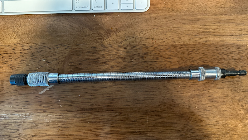

I stripped out one of those same bolts on my 2012 and was able to get a helicoil in there. I used a flexible shaft for my drill and a 1/4" shank drill bit to fit in the chuck of the flexible shaft. The threads for those bolts are M6-1. Didn't have to drop the diff, steering rack, exhaust or anything else and it worked great, even if a bit of a PITA with limited room to work. It was only my second time using a helicoil and the previous time was 20 years before that so I wouldn't call myself an expert with them. But it only took me 20 minutes or so and was way easier than dropping the whole oil pan.

Important point. I tested the depth of the original hole with a toothpick and then wrapped masking tape around the drill bit at the same depth to to keep me from drilling too deep. Can't get a ratchet in there really so the flexible shaft drill running slowly works fine.
