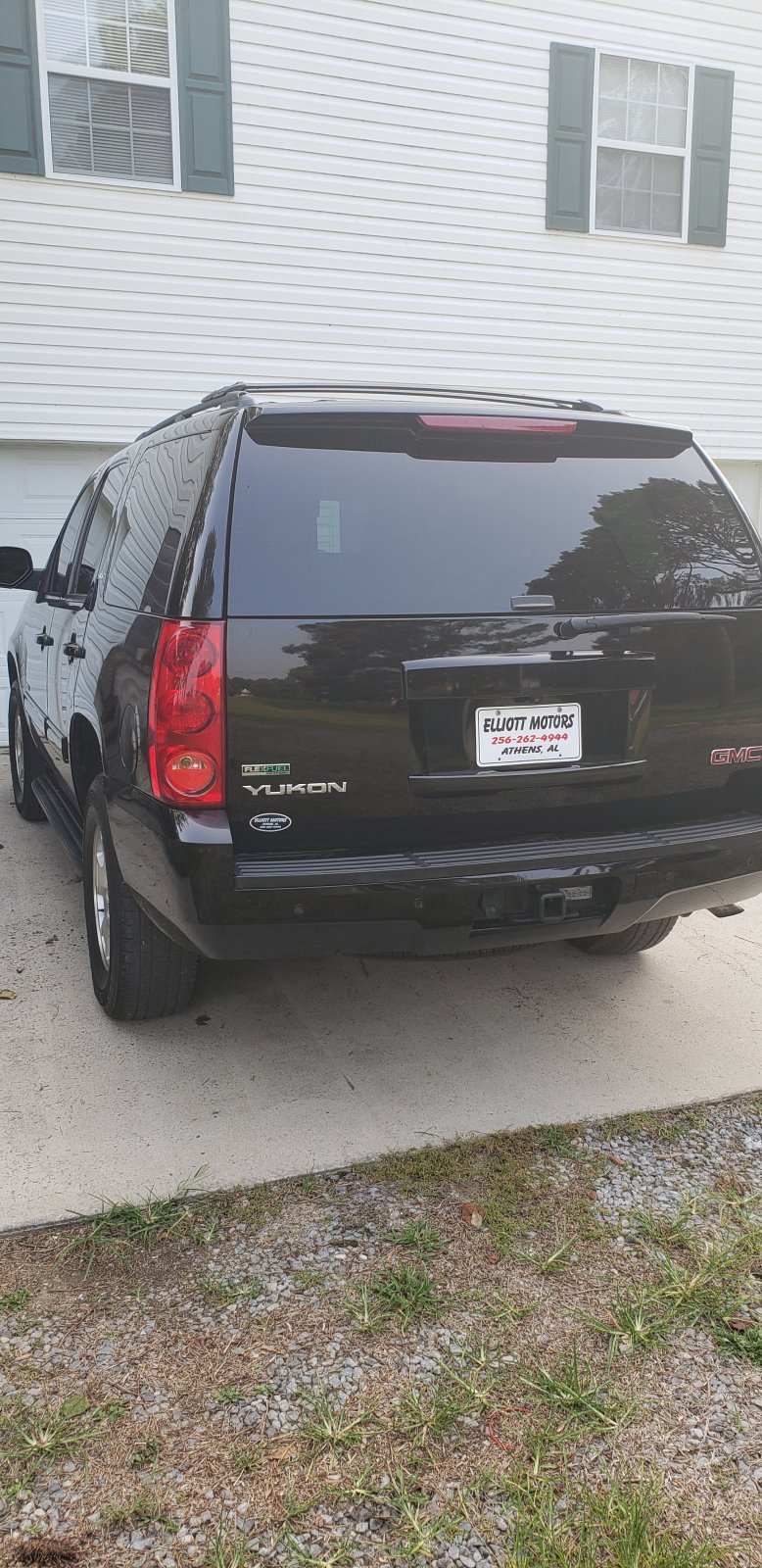

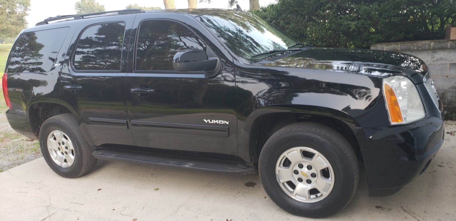

Evening everyone. New guy here from North Alabama. Just purchased a used Yukon to build out for Camper/Weekend warrior/Dirt Roadster. And also will be my daily since I'm only 5 miles from work. Excited about finding this Forum. Ran across it while searching for potential issues. My main interest right off the bat as far as upgrades would be bigger, slightly wider tires just for a little more clearance. (Please make suggestions) Also want to upgrade bumpers for a more manly look but I dont want to build a tank either. Again, suggestions greatly appreciated as I have been scanning the interwebs and it looks like there are not a lot of options so far. I like the simplicity of the Move bumpers but their website doesn't appear to offer an option for 2011. Anyway, looking forward to the long build process. I would greatly appreciate any and all help I can get thats for sure. She's a little dirty from testing the 4WD.

Welcome from Florida!
You're going to get a ticket from the fashion police for running Chevy wheels on a GMC! LOL
