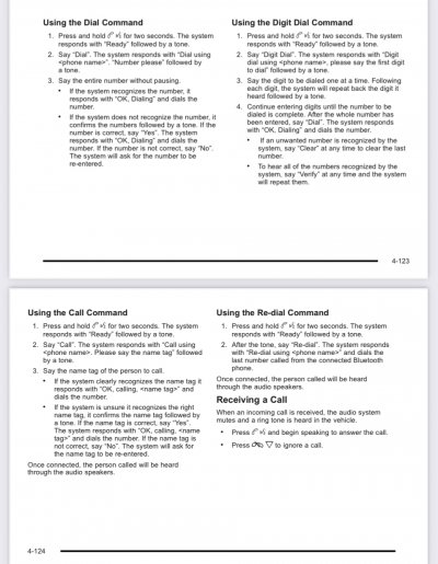

I think the bluetooth connection is in the VCIM? (onstar module)
Here's a thread, despite a hiccup somewhere, contains lots of info..
@petethepug can explain better..
petethepug
Michael
May 4, 2016
3,788
4,356
SoCal
Inside the glovebox door, on the RPO sheet you should find the 3 digit RPO code UQ2 (alphabetical order) for BT. Then follow directions to pair it up.
