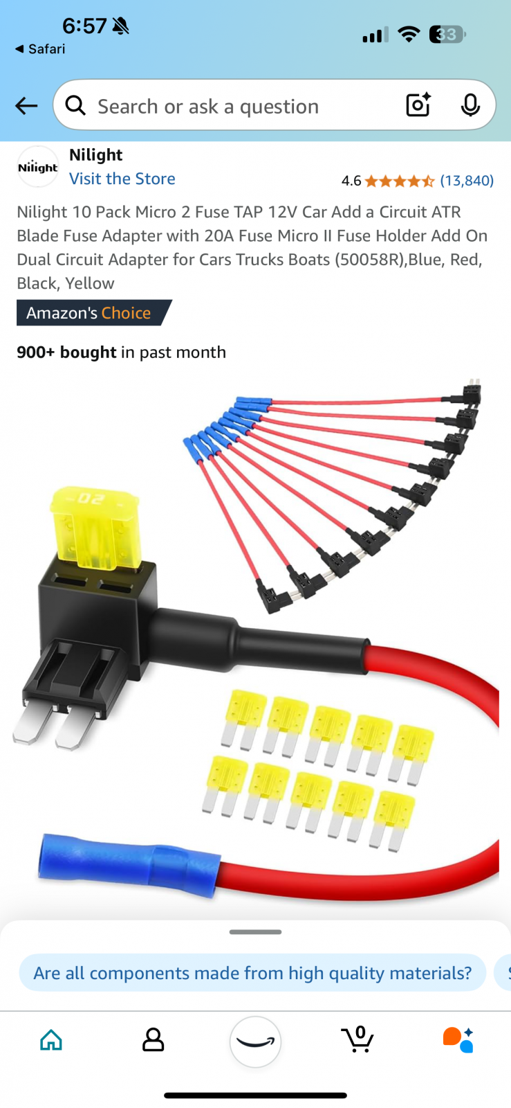

you don’t need to splice into the fuse box with anything permanent. Get one of these fuse taps and go after one of the fuses that turn on and off with the key like hvac control or something. Then run it to the back of the radio
Thanks! From what I'm reading the Yukon needs a separate module/interface for the SWC. Not sure if this is correct or not but the SWC isn't that big of a deal
