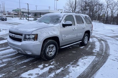

I found a 2010 Tahoe LT with the luxury package for sale and the dealer is currently holding it for me. It has 67k. The interior is in fantastic shape and the exterior is too but the underside does have a fair amount of rust. I do plan on getting it undercoated and rust proofed. I’m in northeast Ohio so this isn’t a surprise. It was owned by two people and came from New York. The dealer is putting new brakes/rotors on the front and rear as well as new tires. I noticed the trans line from the cooler had a leak and they are fixing that too. I do plan on doing the afm delete. The engine is clean and runs smooth, no noises. I’ll be trading my 15 Accord w/ 86k in for it. Just curious on everyone’s thoughts, this will be my first Tahoe.

check the air ride shocks in the rear, even after sitting not driven the bellows on them should be firm, just reach under behind the rear wheel and squeeze they are on one air line so if one is firm the other will be as well, same goes if they are flat (no air inside). on this platform it is typical to see them wear out around 80-85k not a big deal Arnott makes a replacement just go into it knowing it's a wear item but if they are shot maybe the dealer will address that as well before you sign. afm can be turned off with a canned tune or other devices, a full delete is probably not worth spending money on.

Yep I have the car fax. 17 service records. Both owners averaged about 6k miles a year on it. Two minor accidents reported. I looked it over well and didn’t see any kind of structural damage. Was dealer serviced.

$19k. The rear shocks are rusty but I didn’t see any leaking from them. By the looks of them I was planning on replacing them. I brought it up to the dealer but unless they are leaking they won’t replace them. Not a big deal since they are fairly inexpensive. I’m doing the afm bypass that plugs in.
