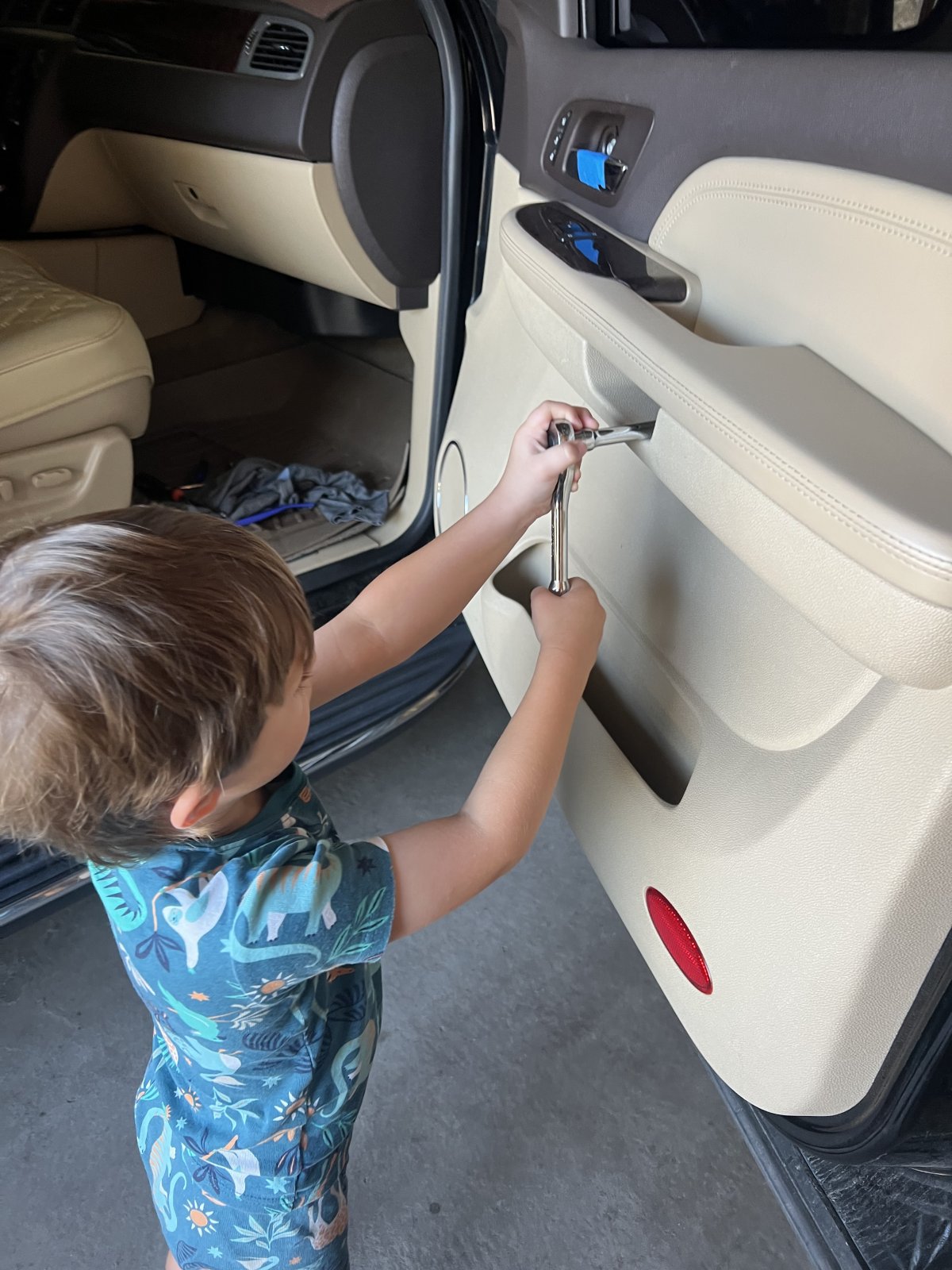

We got the rest of the interior and exterior handles changed out today. Turns out it goes a lot faster when you have a little help! Get em' started young I say!
Had some more of those fun stripped door handle bolts! Rear drivers side was the only handle that had zero.

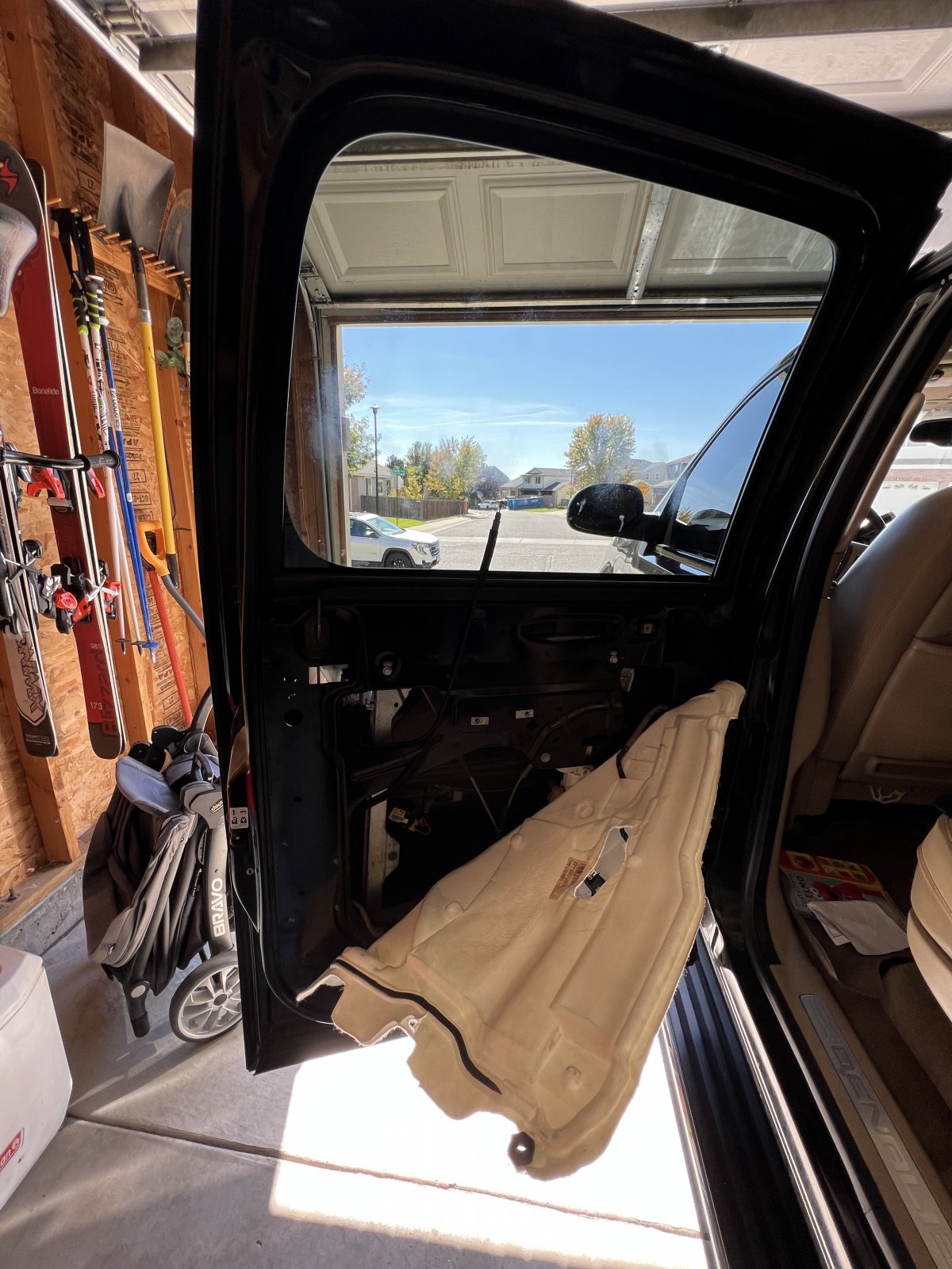

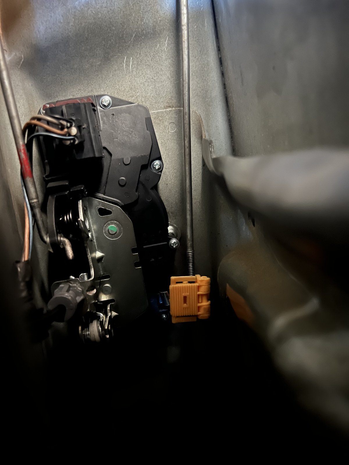

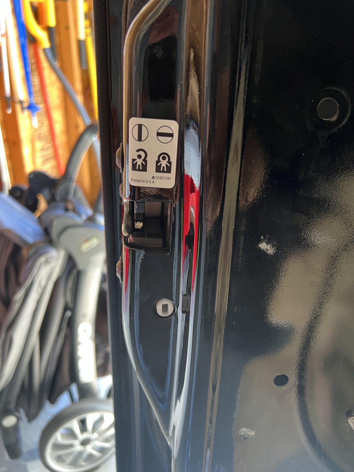

I had just replaced all interior / exterior door handles a few weeks ago but noticed one of my rear lock actuators was not unlocking / locking on command. I ordered a Dorman OEM actuator and installed it. The door now unlocks and locks perfect but when I put the door back together neither the interior or exterior handle work! So now I cannot open the door at all.
I tried pulling on the latch for the exterior handle to open the door with the panel off, which has worked for me in the past but it didn’t work this time. Does anyone know how I can get this door open? I have an appointment at the shop next Tuesday if I can’t figure it out this weekend.
Pic of new actuator installed
Got the panel off the door despite it being locked shut and still can’t get it open. HALP!

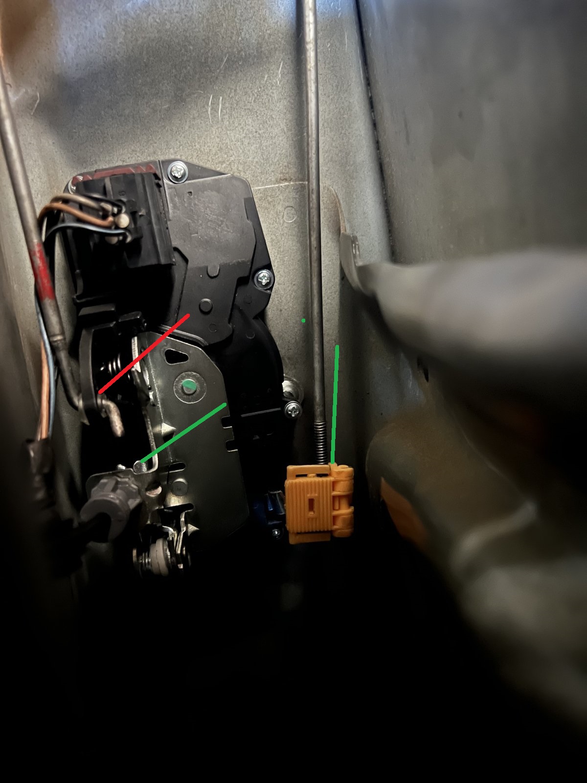

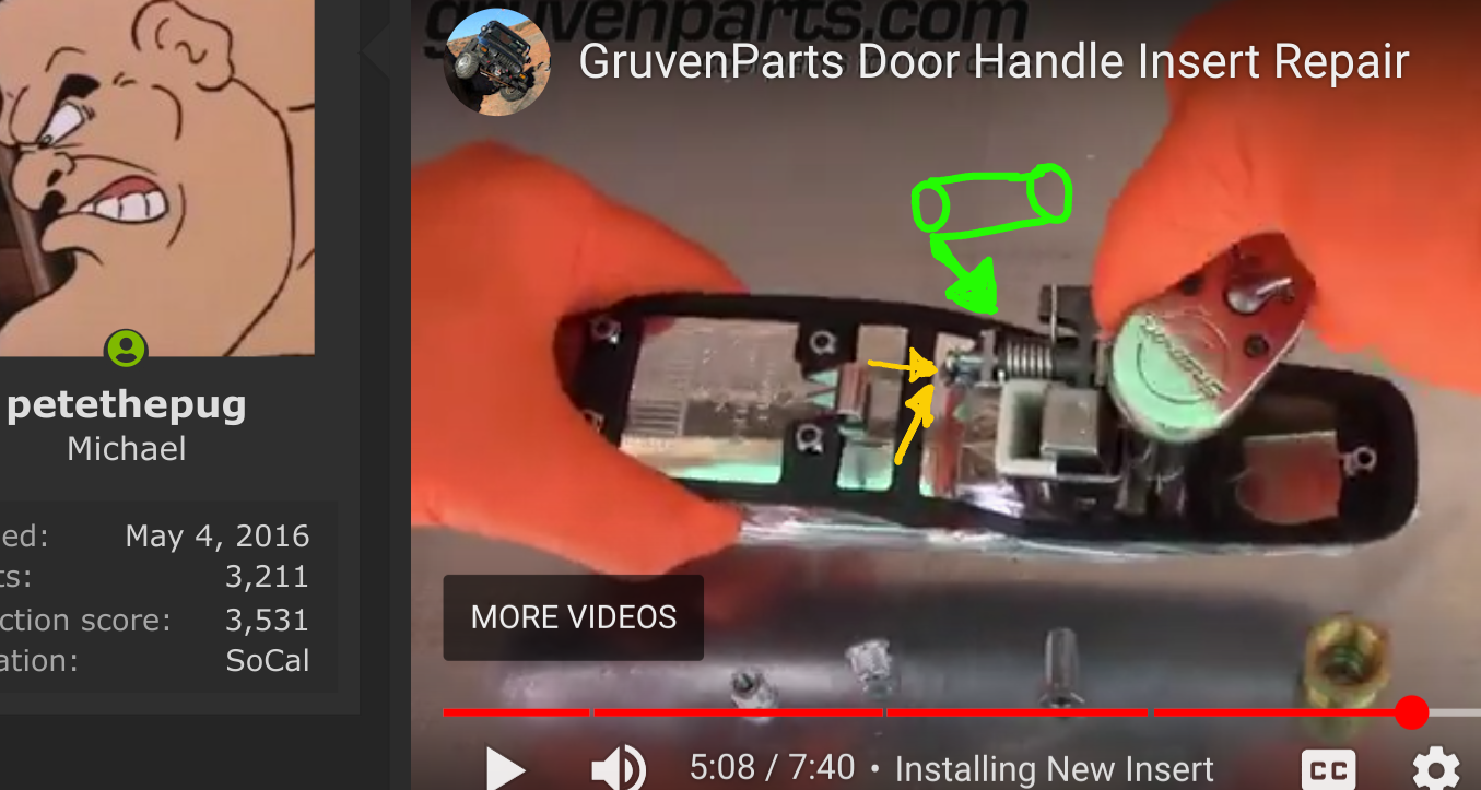

So in my pic here the red line that should be up all the way and either of the green lines should open the door. Maybe the child safety lock is enabled?
