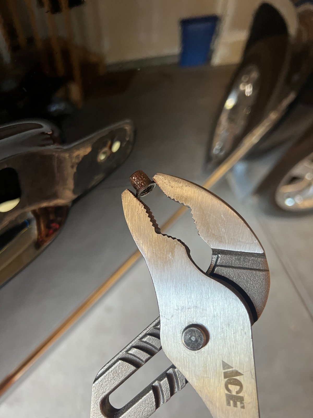

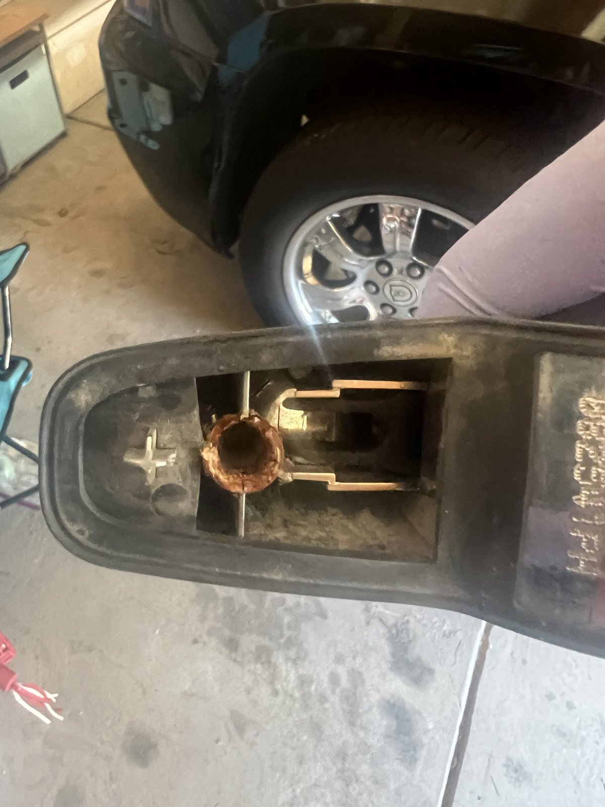

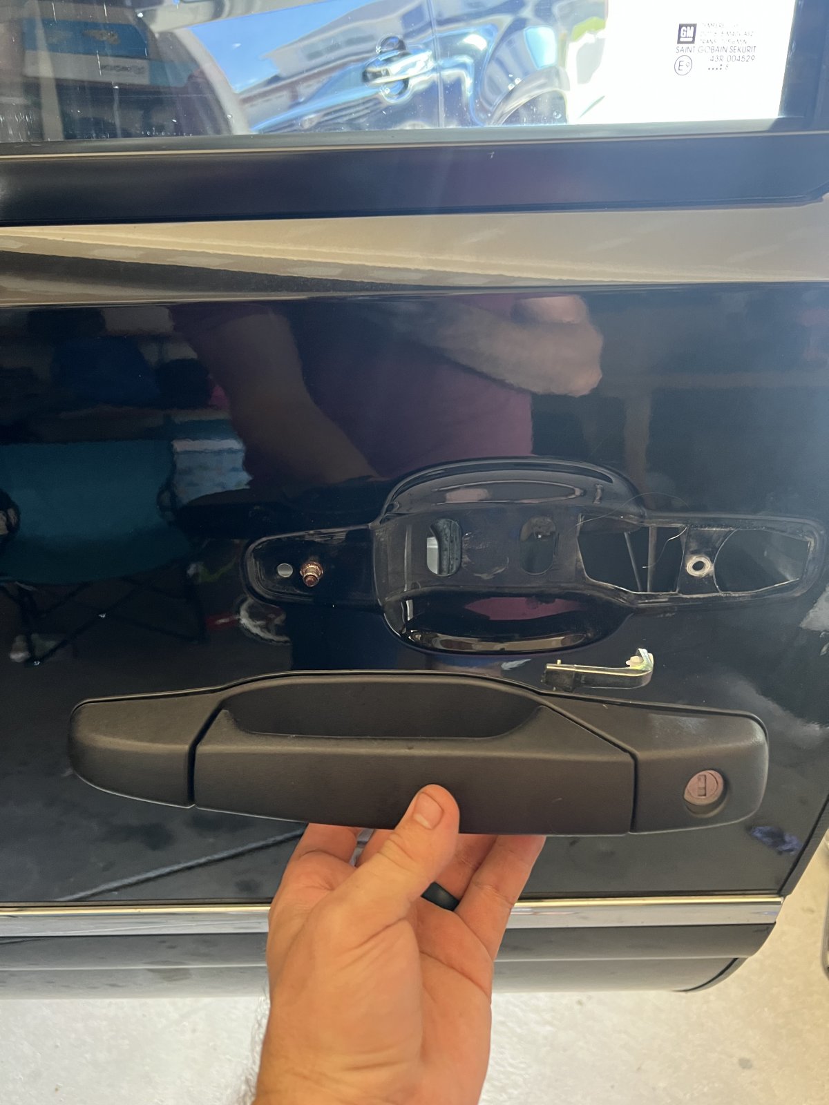

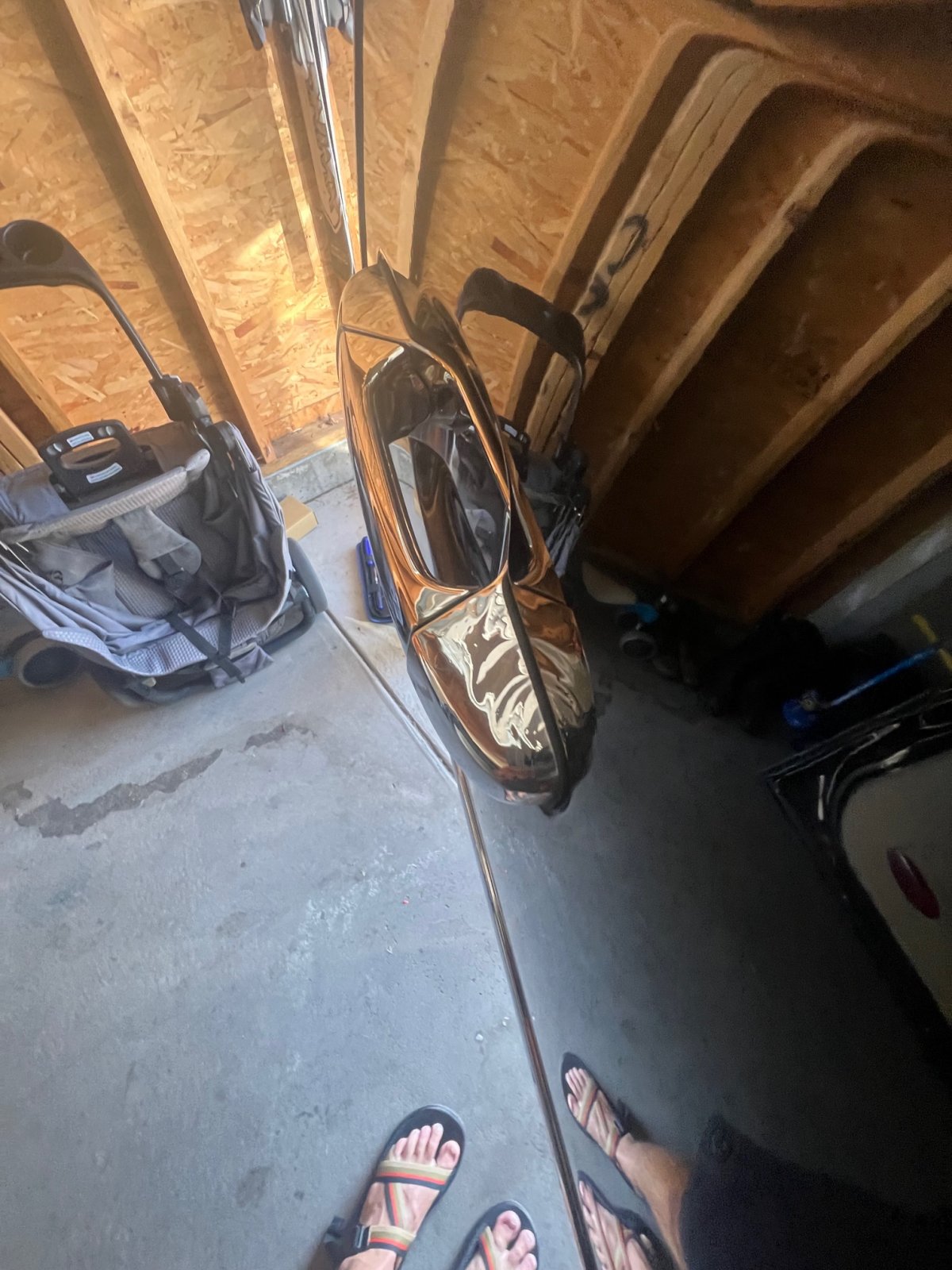

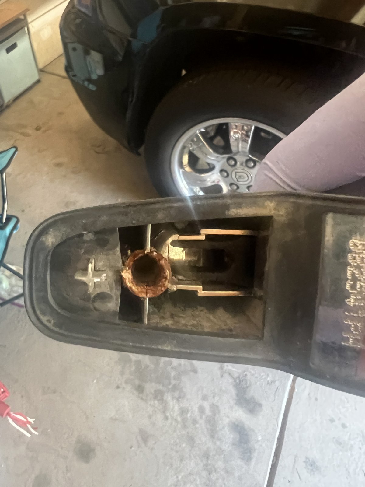

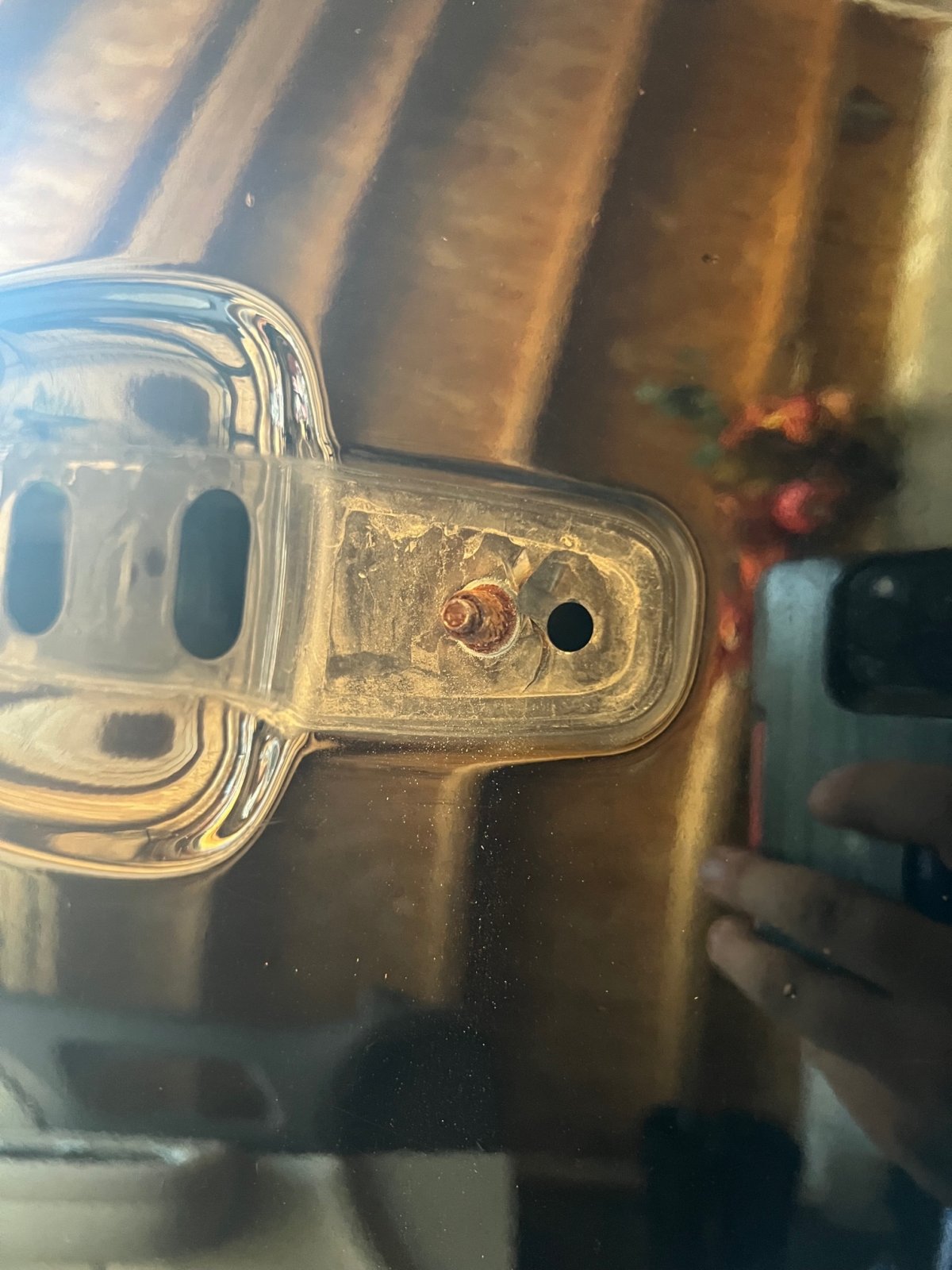

I ordered new textured black door handles last week, and they arrived yesterday. I walked out to my car to open the drivers side door this morning and the handle immediately broke and would not open the door. What terrific timing I have! So I took the door panel apart because I was planning to replace my interior door handles anyways since the chrome is peeling on some of them. When I attempted to take off the drivers side door handle, it appears the sleeve that the bolt screws into has separated from the handle. Does anyone have any tips how to remove it? I've tried channel locks but I am just stripping it trying to get it off. I can't install my new handle until I can get it off. Help!
30,500
47,887
if you can't get it off with vice grips, then I would just drill it out from the other side, using a torch to heat it up would probably damage the paint around that area. hacksaw won't fit

Spray some pb blaster in it, wait a little bit then clean it with some brake clean or the like and use some good vice grips.

PB Blaster and some vice grips did the trick! Got the driver outside / inside handles changed successfully. Found some candy wrappers inside the door panel not sure how those got there! Now only 3 doors left to do I'll do the front passenger tomorrow and the rear doors next week. I'm expecting to run into some more of these stripped bolts as I move along but at least I know how to get them off. Thanks ya'll!

The other option people use to free those bolts and nutserts is a heat gun.

WTF is a nutert?? :rofl: Soaked them in PB Blaster and let them sit for half an hour. Then applied dad strength torque to a set of vice grips on those boys and they usually came loose alright. I'll tell you there were moments where I was definitely getting a lil nervous. Luckily they all came loose!

The door handle is only attached to the body with 2 10mm bolts. Reused those no problem but the issue was that the sleeve in the original door handle would become separated. It would just spin freely because its a round metal piece and doesn't really have edges.

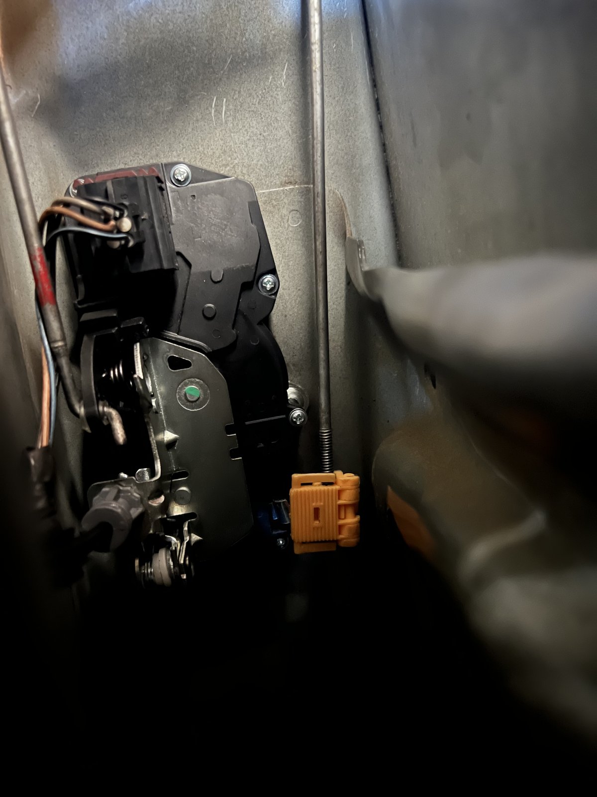

I had just replaced all interior / exterior door handles a few weeks ago but noticed one of my rear lock actuators was not unlocking / locking on command. I ordered a Dorman OEM actuator and installed it. The door now unlocks and locks perfect but when I put the door back together neither the interior or exterior handle work! So now I cannot open the door at all.
I tried pulling on the latch for the exterior handle to open the door with the panel off, which has worked for me in the past but it didn’t work this time. Does anyone know how I can get this door open? I have an appointment at the shop next Tuesday if I can’t figure it out this weekend.
Pic of new actuator installed

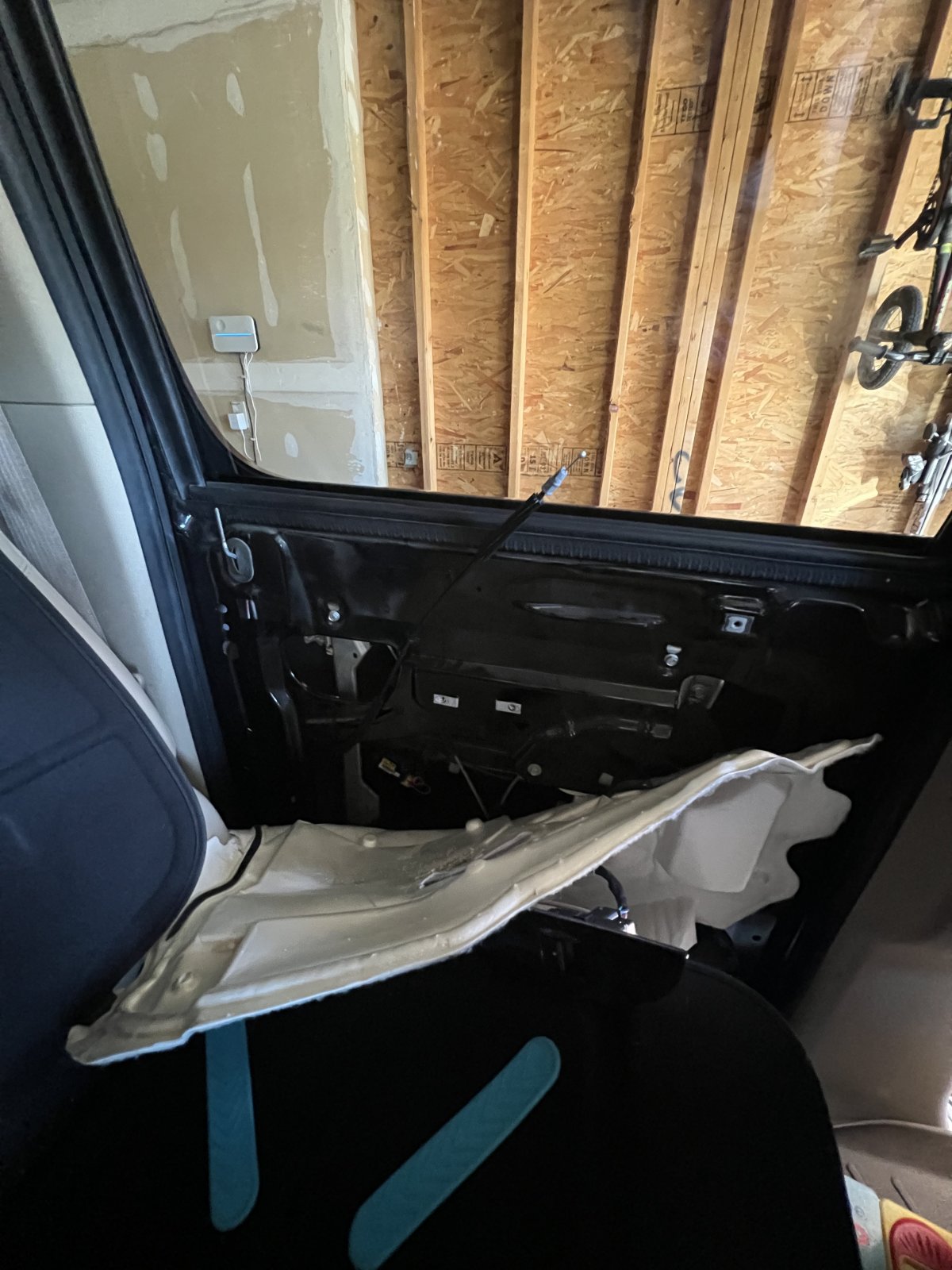

Got the panel off the door despite it being locked shut and still can’t get it open. HALP!

So in my pic here the red line that should be up all the way and either of the green lines should open the door. Maybe the child safety lock is enabled?
91RS
Nov 15, 2009
2,846
2,293
GA
Dorman is JUNK. You’re going to have to destroy the match to get where you can release it.
