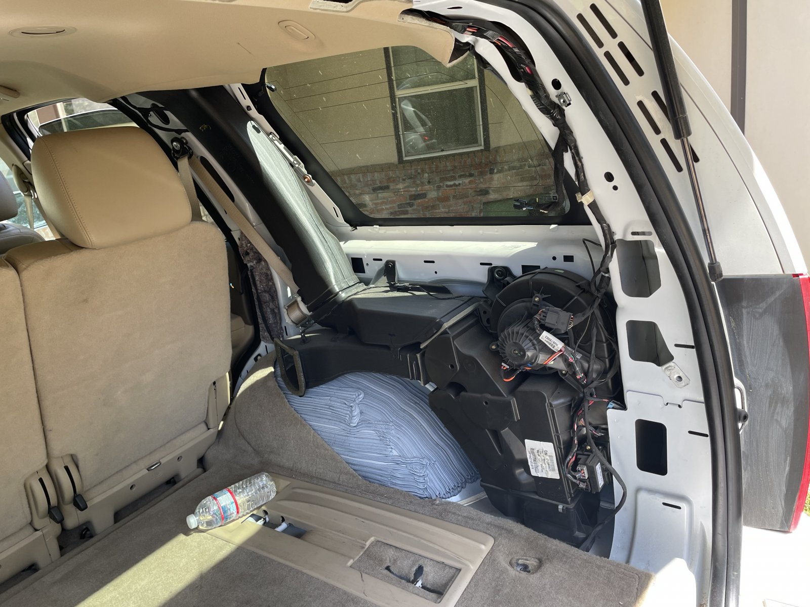

Here's a pic... Actuators are behind unit most? years.
Loosen a few screws (base of evap case?) and one screw holds the top, then you can tilt the unit inwards to reach actuators behind..
I removed the middle duct piece and temp sensor you can see them still installed in the pic. May have also had to unplug some wiring to get the harness out of the way..
