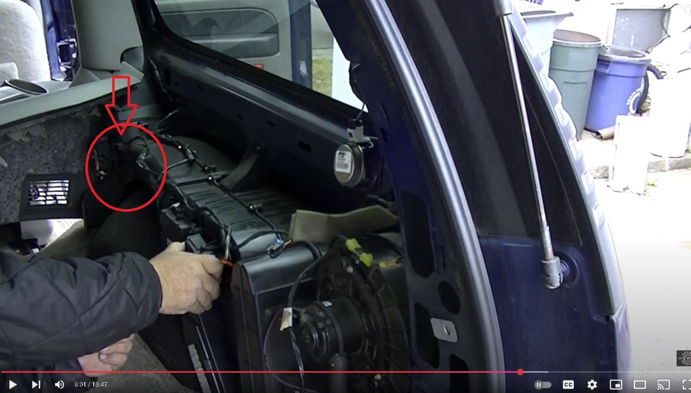

here is a often referenced video for "how to" only in his video he is doing the hot/cold actuator, you are going to do the same thing but at the Y where the up/down split is, circled in my picture below. you will need a 5.5mm socket to remove the 2 or 3 bolts that hold it in.
