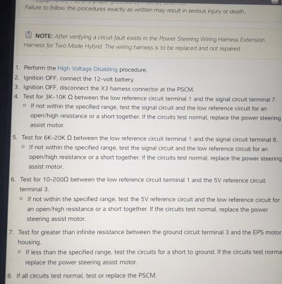

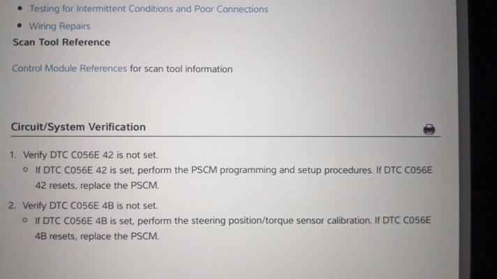

Hey there, thanks for that info. We checked power and voltage and keep coming up with nothing. But these two codes. The steeering wheel is still stiff so we cant calibrate it. So confused

can your scanner connect to the power steering module to look at live data? not just a fault code, those can be reported by other systems that can't speak to the module it's looking for.
it's hard to say if you have a communication problem or just not getting voltage to the module itself. if you don't have the 42v from the underhood inverter, you're not going to get any assist.
At this point you're going to need to do some hands on troubleshooting.

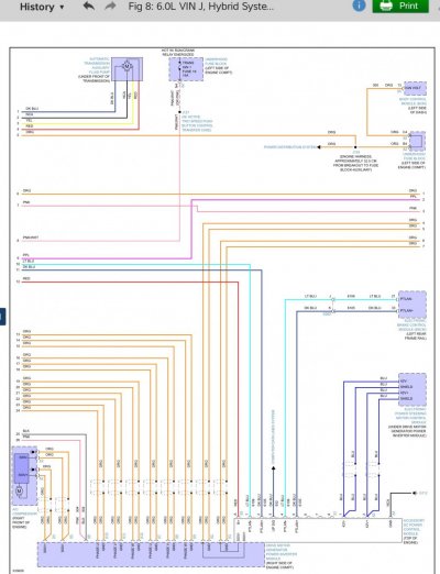

here's the diagram for the 42v +/- from the module to the power steering.

fuse 7 in the auxiliary fuse box is 12v to the module. at the module it looks like it's pin 6 of the x1 connector a rd/wh wire.
