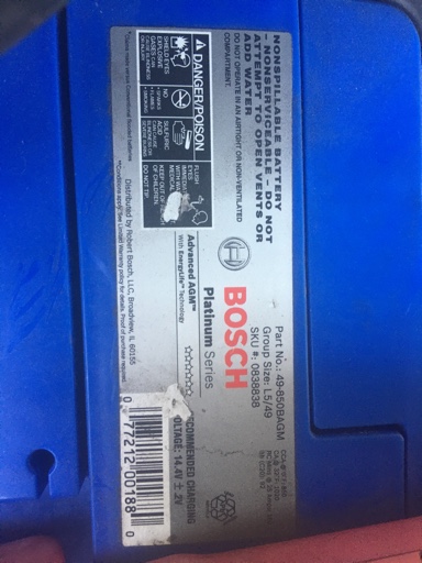

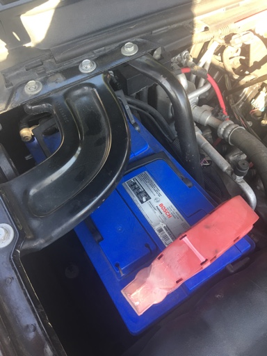

I did a Group 5 / L49 850 CCA Bosch / Varta AGM battery. It’s 2mm too big which means your coolant overflow on the 6.2L will sway to the side slightly.
This is the one with a 4 year over the counter warranty replacement warranty from any Pep Boys nationwide. They’re typically on sale for 25-30% off. You can bypass the online only pricing by simply printing the online add and bringing it to the store.
These are the best for extreme hot / cold conditions and spouses that like to leave DVD players running, engine off, key on. After a long run with Optima batteries for almost 20 years, I ditched them for Bosch.
“The battery always holds its contents inside and is secured against any leakage. The electrolyte would not spill (as it would in the flooded lead-acid batteries) preserving the battery capacity and saving the nearby area from burning. The battery posts don’t get sulfated, while the battery and car parts don’t suffer from corrosion.”
