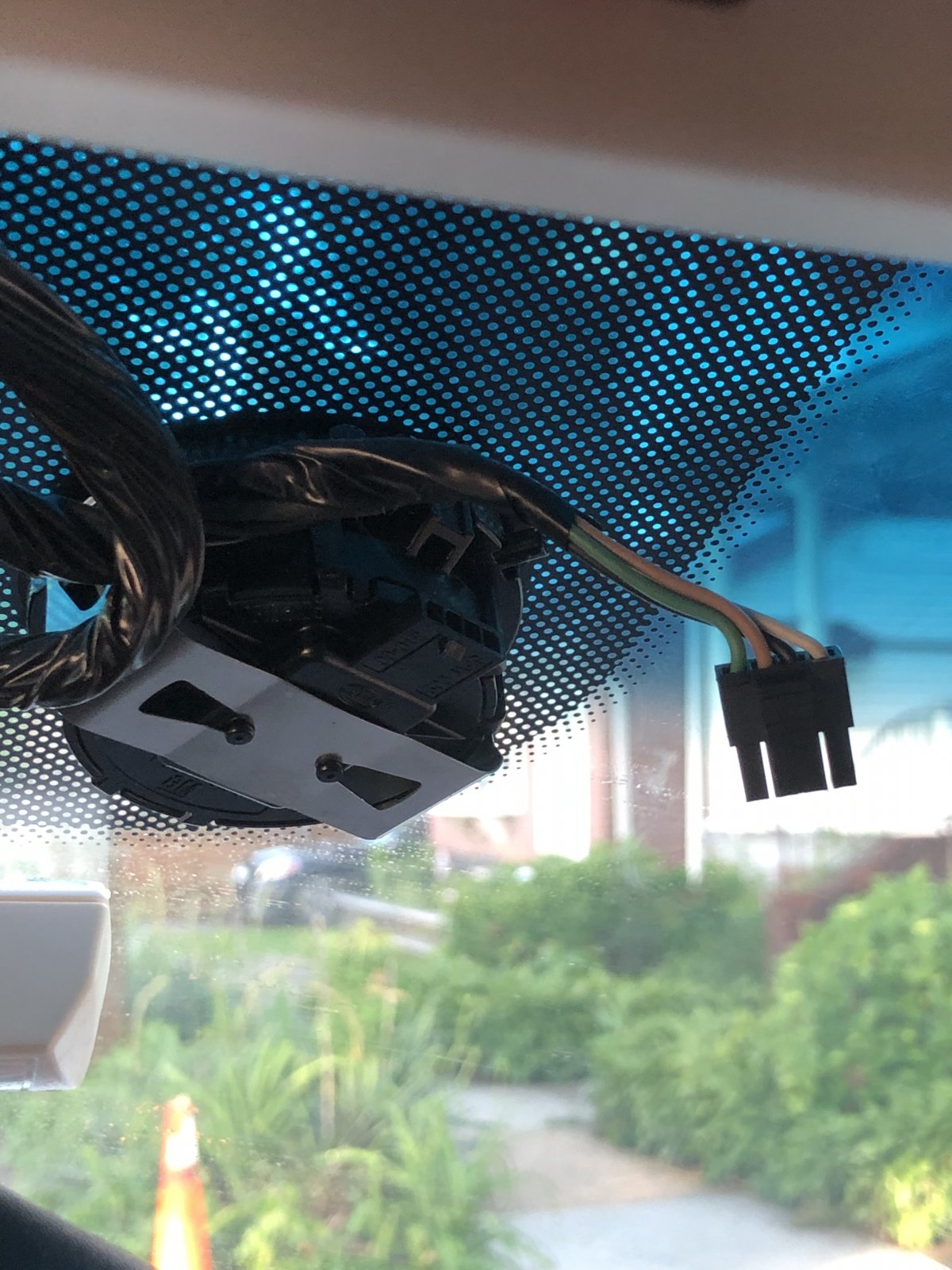

Hello all, first post here (I will have A few others).
I have a 2008 Tahoe LT and my front wipers only work on the last 2 highest settings. The low-medium settings do not function. Did anyone ever encounter this before?

I was looking this up and it may be the Wiper transmitter module. But that was my best guess thus far.

Hey! Guess what... Its fixed and every wiper setting works now! The wiper rain sensor cover came off way to easily (I guess it was taken on and off cause I had my windshield replaced)... I simply unplugged it and now it works on all modes perfectly! thanks!
