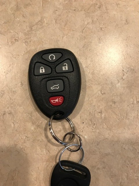

I just bought yesterday, and realized what all the buttons are for on my remote. I follow the cycle of hitting the lock button and then the start button. It cycles with lights flashing after I hit the start arrow, but nothing happens after that. I have changed the battery, tried to get the valet mode off (if there is one). Not sure what else to try. The lock and unlock works. Lift gate button works. What else can I try?
