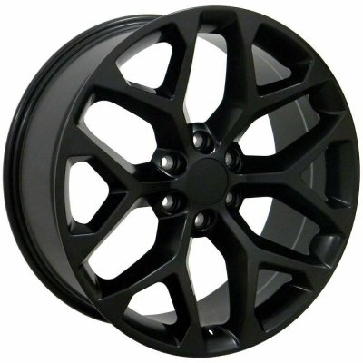

Can't wait to get it dropped... Biggest I will go on wheel size is 22". Leaning towards the Black GMC Replica from Tony in a 285/45/22. Big pot holes here in Michigan ;-)
