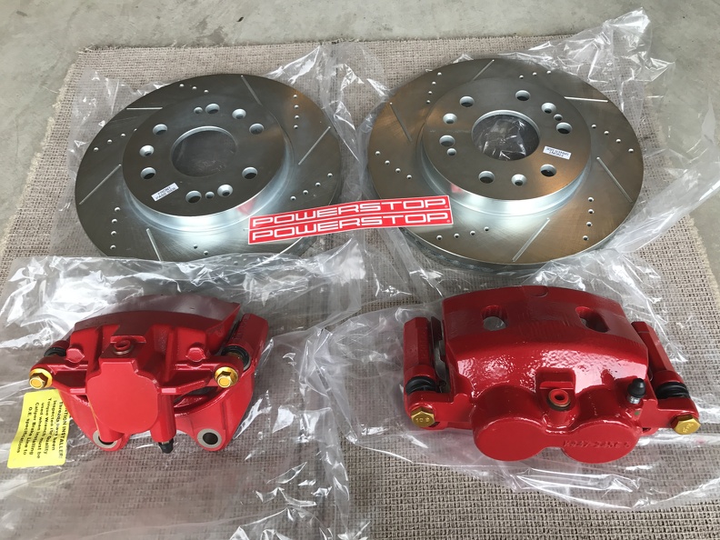

I think I forgot to mention in this update today that for NO good reason last night (other than the RED color lol) I decided to purchase a Power Stop EVO Brake Kit for all 4 corners (other than it will look awesome!) and AutoAnything has them for $779 (25% off) with a stackable 7% off coupon right now. I couldn't say no even though I didn't need brakes. I am probably buying these wheels in black 22" from Tony @NORCAL SS and was going to paint or powder coat my calipers red but after thinking about how many times I would have to repaint them and all the hassle, I decided to spend the money and get the nicer looking rotors to go with it.

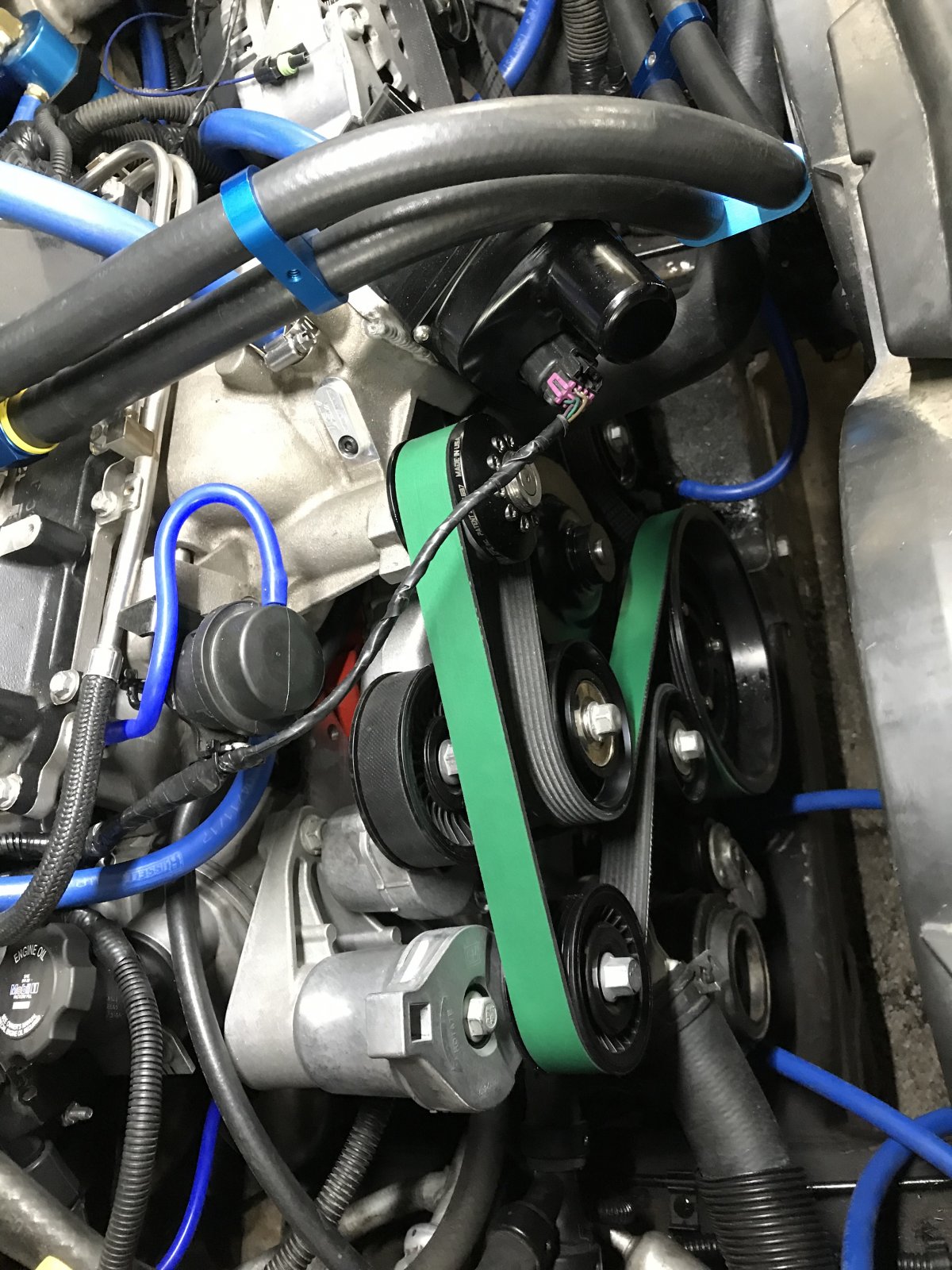

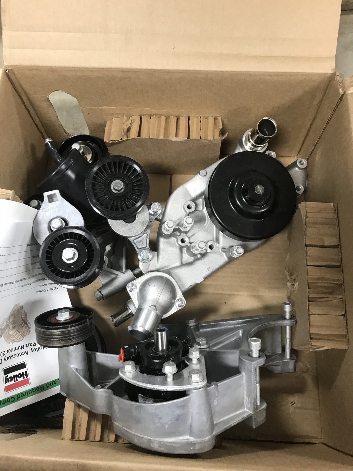

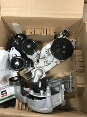

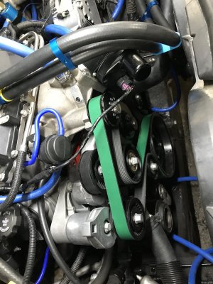

Here is a picture of the Alternator relocation bracket and the new Idler pulleys. This setup uses the factory tensioner and a 6 rib belt. The belt rides in the MIDDLE of the supercharger pulley instead of the outside or inside ribs like most of the kits. I got this and the rebuilt LSA from NextGen Performance. They're bracket kit was half the cost of the crappy kits you see on eBay... Pulleys come factory torqued and everything is powder coated black.
*I had issues with this kit and the Junk from Murphy... Currently using OEM CTS V brackets as seen here:

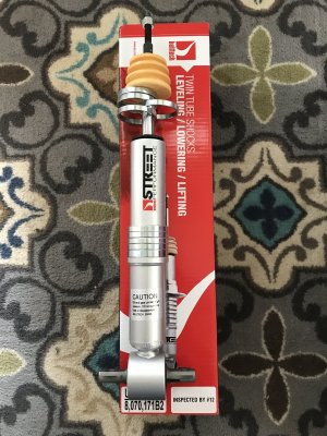

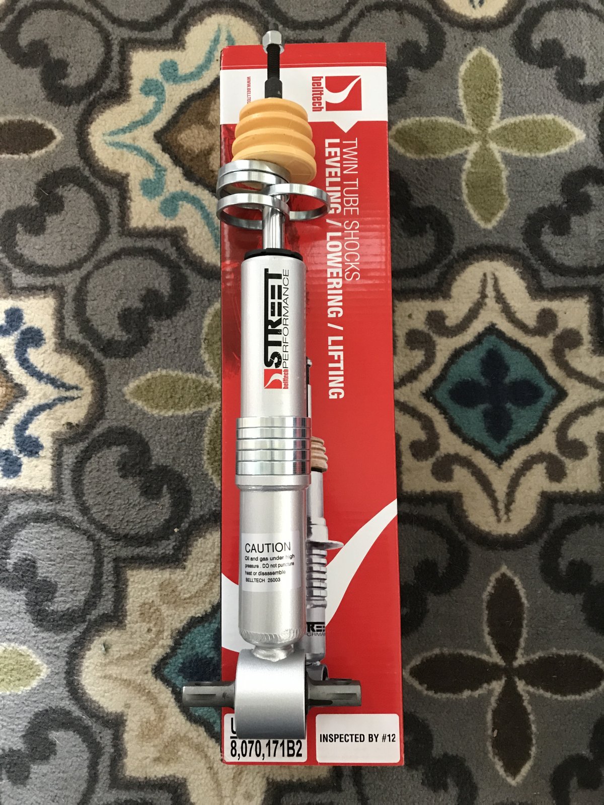

Well, FedEx just came back again today and delivered another surprise package... None of my suspension was supposed to come until tomorrow but I officially have EVERYTHING for my build now just sitting here waiting to get installed. I just got my drop spindles, springs and adjustable struts from BellTech.

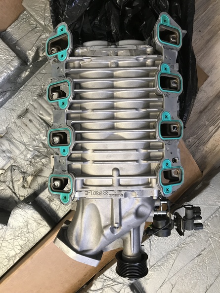

Yeah the weight of my Whipple has me concerned too. It's going to be a ***** to set in place on top of the lower manifold. I'm still thinking of the best method. I had 2 boxes at 150 lbs total in parts.
The 75lbs I was talking about was just the bottom end. That was the shipping label, I don't think it's that much but who knows. Maybe I'll toss it on a scale before I install it. Luckily the ZL1 intercooled lid isn't too heavy but it's still a good amount in total. I've got help to get it put on though and mine is in two parts. Good luck on yours...
52,954
Most of my weight is the blower itself, the lower manifold is aluminum and pretty light. I just weighed the blower and it's about 60 lbs. so I guess it's not too bad but it's awkward and it has to be set down careful. I guess the rest of the weight is the intercooler, brackets and all the other parts.
