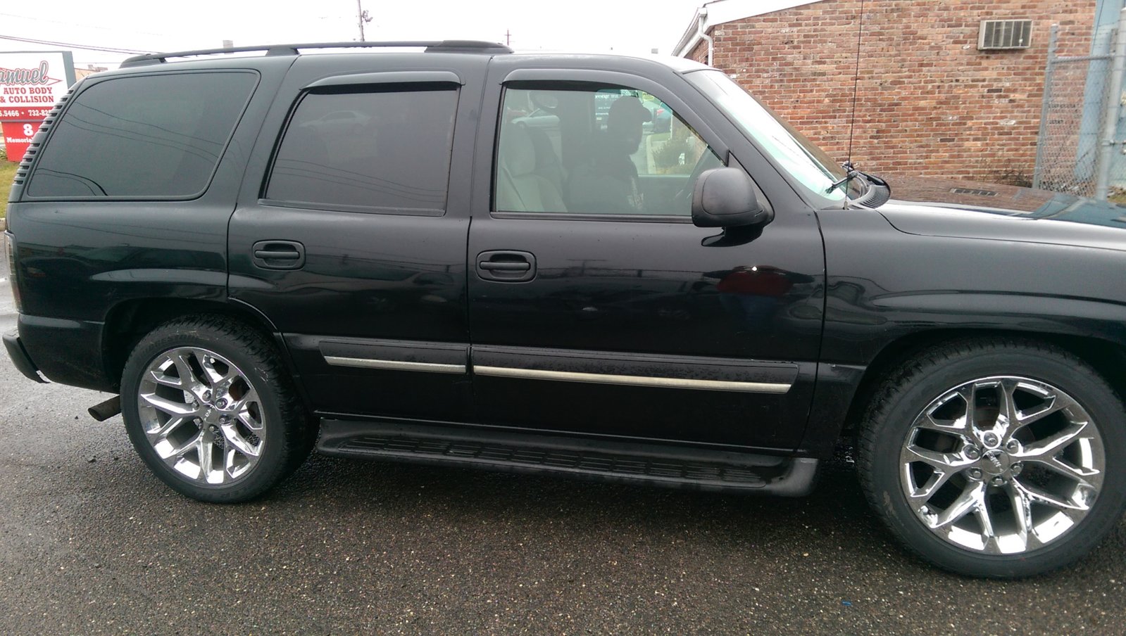

The wheels on my 2006 Tahoe Z71 are getting s little beat up and I would like to change them. Can anyone tell me..
Will 2007 -2017 wheels work ? Dimensions of the set I am looking at are: 17' diameter rim is 7.5" wide with 6 lug holes. The bolt pattern is 139.7 mm. The offset on this rim is 31mm.
If the wheels do fit, will the included tire pressure sensors talk to my 2006 truck? Thanks

They will fit. The sensors will not work. You will need to flip them from your old wheels or buy new ones.

I was told by a gm dealer that my 2006 sensors would not fit the next gen wheels, but I did not ask if new sensors would be compatible with the 2006 system. I will look for decent stock wheels.
Thank you for the advice.

You can definitely get sensors that work. Many of us run wheels from the next generation(s). Get the wheels you want. The sensors are $100ish for a set.
