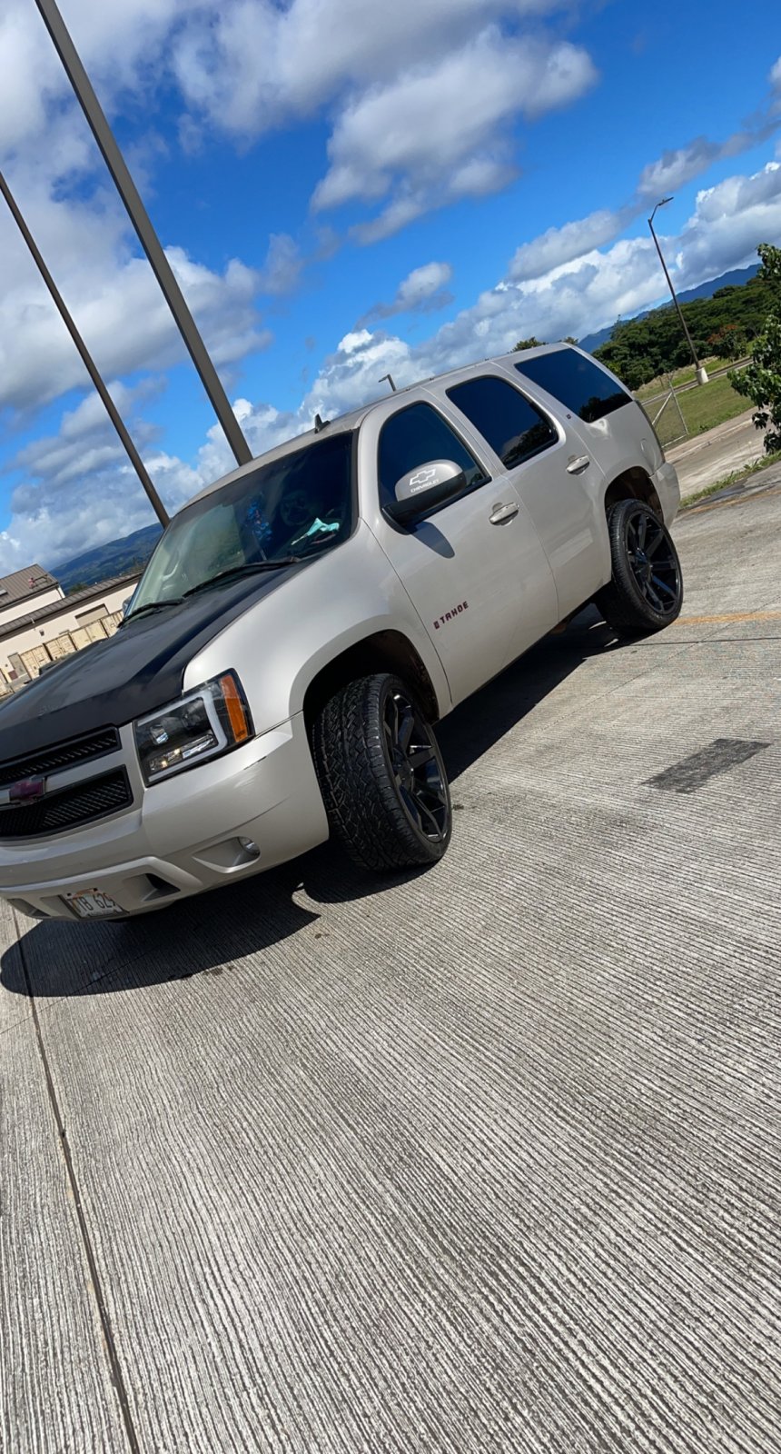

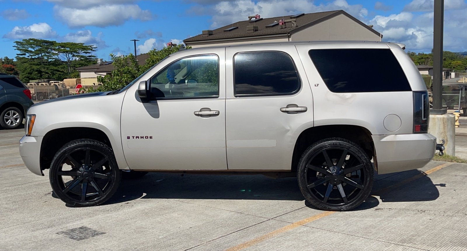

Welcome to the forum from New Hampshire - can you provide details about your Tahoe...ie, year, trim, mileage, pics.....If the drivers side switch is bad, it may need to be programed to the truck via bi-directional scanner (Tech2). I am sure someone here smarter than me can chime in to confirm as well as additional troubleshooting. If you happen to have a fleet/service truck such as a PPV (police 2wd) or SSV (police or govt 4wd) - locks and windows may have been disabled.

Thanks and it’s a 2007 LT with about 98000 miles and no it’s not a ppv and I will look to see if someone out here in Hawaii has one
