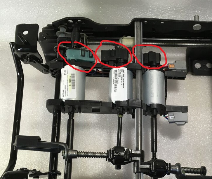

My seat doesn't have these parts (circled in red). Could this be something they added after 2007 and maybe what keeps this from happening?
BTW - P/N 22804419 6 way power seat adjuster track

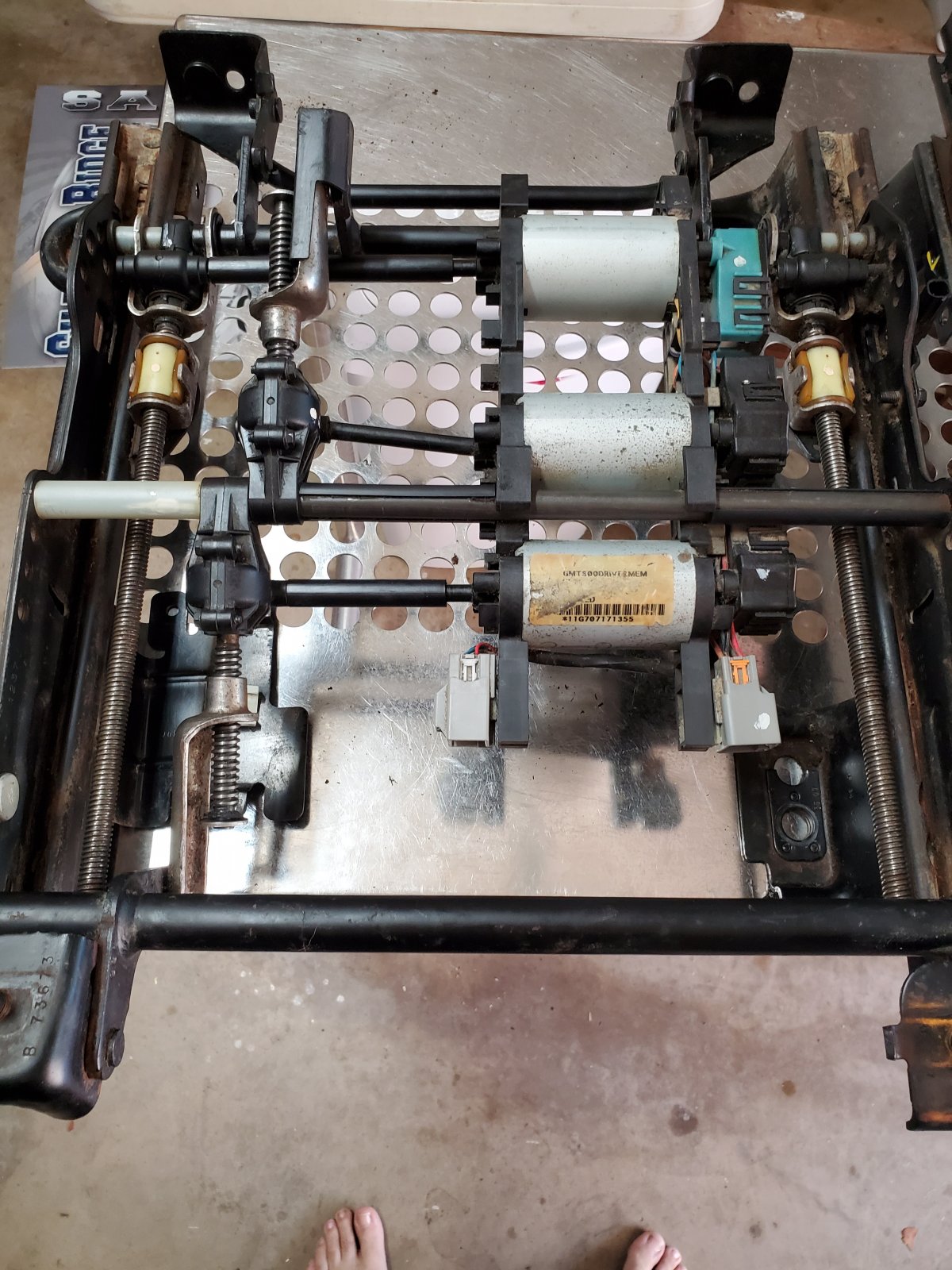

Follow-up. Found a replacement at the local Pick-n-Pull junkyard. Also from a 2007 Tahoe LS but it did have 8-way power seats (+ lumbar control in the back of the seat). It also had the extra gear box controls like the pic above. Finally figured out that these are for the seat memory (which I don't have). I used my wiring harness and simply didn't connect anything to the memory controllers. Unfortunately, it seems that my problem may be common as the gear boxes on the new part were also not working (worse than mine - the motor works and the motor shaft spins but the screws don't turn at all. The other two motors/adjusters worked fine even without connecting the memory controllers. Looks like I might be stuck paying $450 for a new part. https://smile.amazon.com/gp/product...&pf_rd_p=edaba0ee-c2fe-4124-9f5d-b31d6b1bfbee
