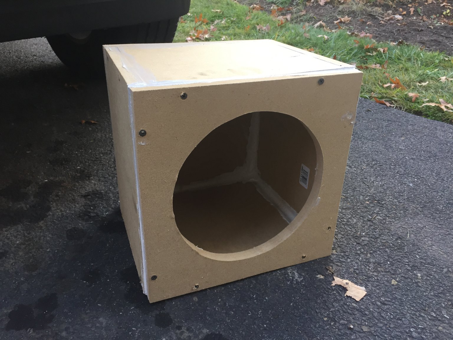

Made my new box today. Going double up the front since the sub is heavy. Here's how it's looking so far

This is for behind your 3rd row?
It would fit there, but I have the 3rd row folded up and I'll probably be taking it out and putting them in the basement. No kids and no need for it 90% of the time.
